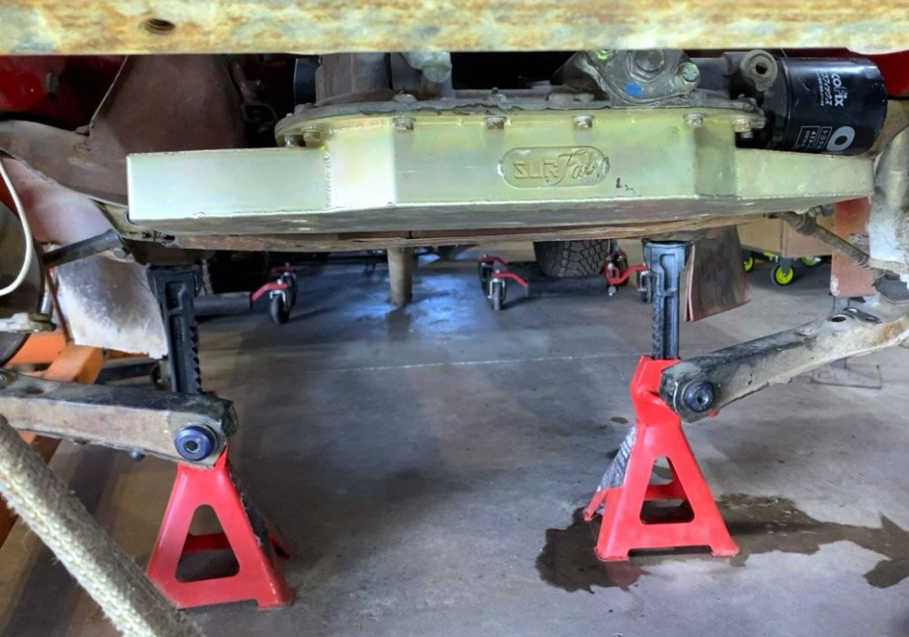

Have you come across the Mitsi Sigma LCAs for widening a KE70?
1966933811_PPEinaction!.jpg.17f40151f90425ba802679f64e517296.jpg.43a4d2776737201447bd1719dfbe7d86.jpg
Otherwise, put up a couple of diagrams of the front suspension with some numbers and how much you want to lower it. If you move the strut outwards at the bottom for the wheel track, you should move it out at the top too, so camber-tops on coilovers might be the answer.
