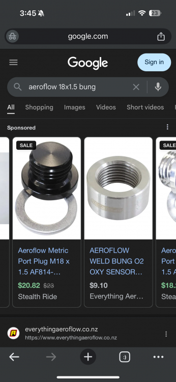

  7. bloody magic, I’ll get onto that tomorrow. Fingers crossed it should be laid to rest on the subframe and back in the bay in 6 weeks ish for a run up. this arvo I hit another wee bump in the road. I hadn’t really noticed it when dropping the oil pre pulling the motor as I bought the car a few weeks prior… A combination of an uneven sump-to-plug surface & a couple dicey threads led to a leaky plug this arvo when filling with penrite. Option 1: We rip the sump off again and have a new female fitting welded on and plug fitted. Will have to get a new seal and razor the gasket maker off. Bloody faffs. Option 2: I try and find an 18m ID rubber flat washer that can deal with oil and high temp and try that first. The plug does tighten well in the sump threads, just feels a little wobbly on the way in but I’m guessing that’s to be expected with a 1.5mm thread pitch? Sump plug size is 18x1.5 Not the end of the world and if welding a new fitting in has to be the way forward we’ll come out the other side better for it. Just a bloooody faff
