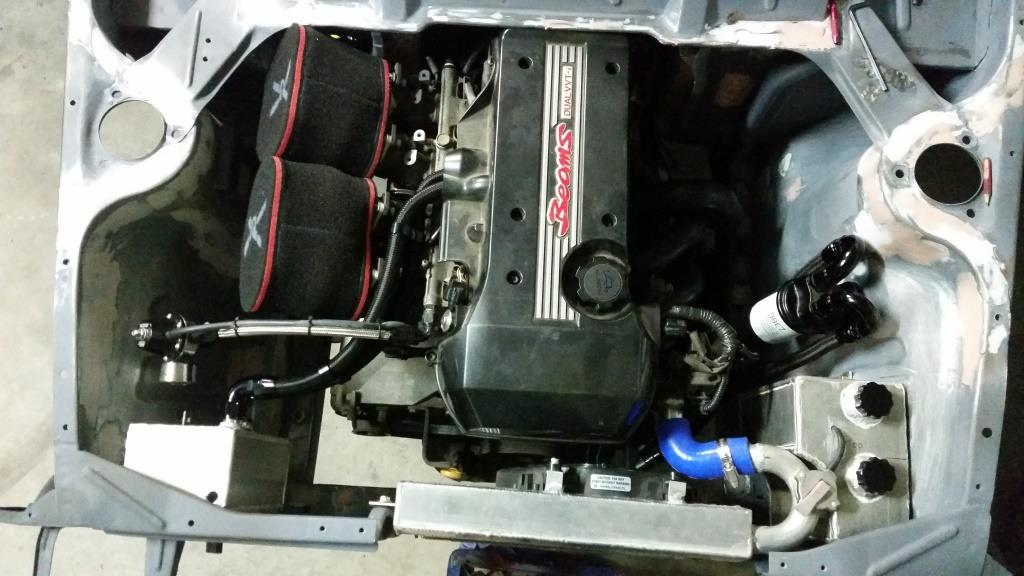

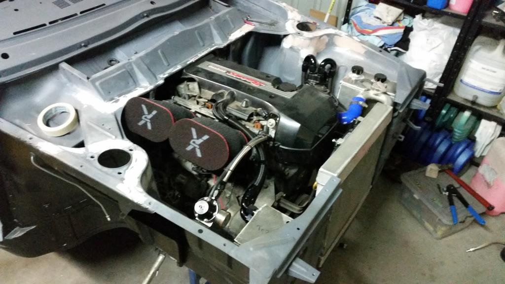

  3. Some more progress Engineer is booked for next week and dyno tuning should be sorted within the month :)

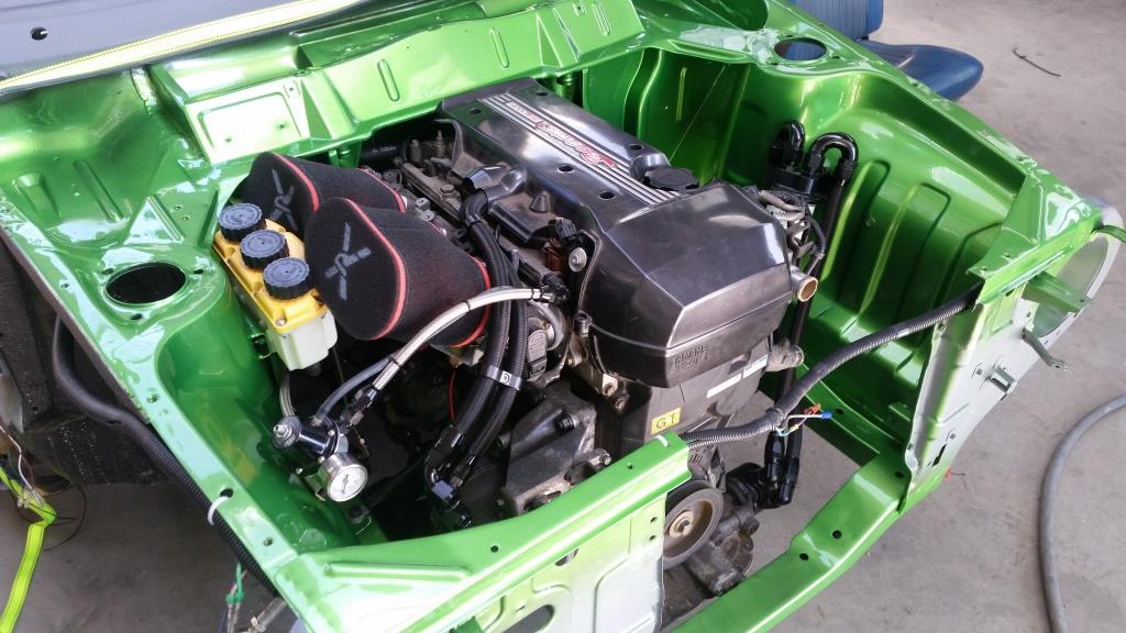

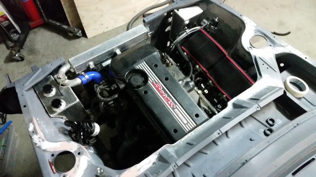

  4. Just some more progress shots. Now to prime and paint the engine bay :)

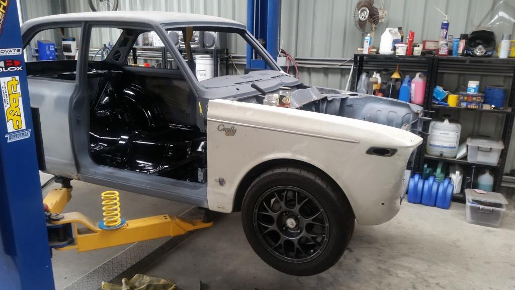

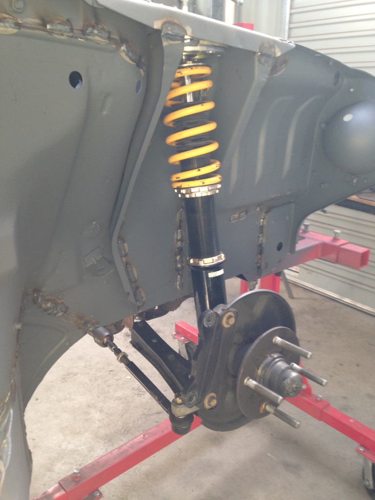

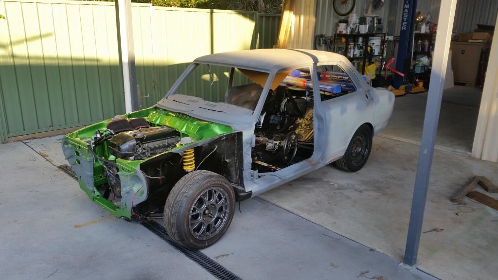

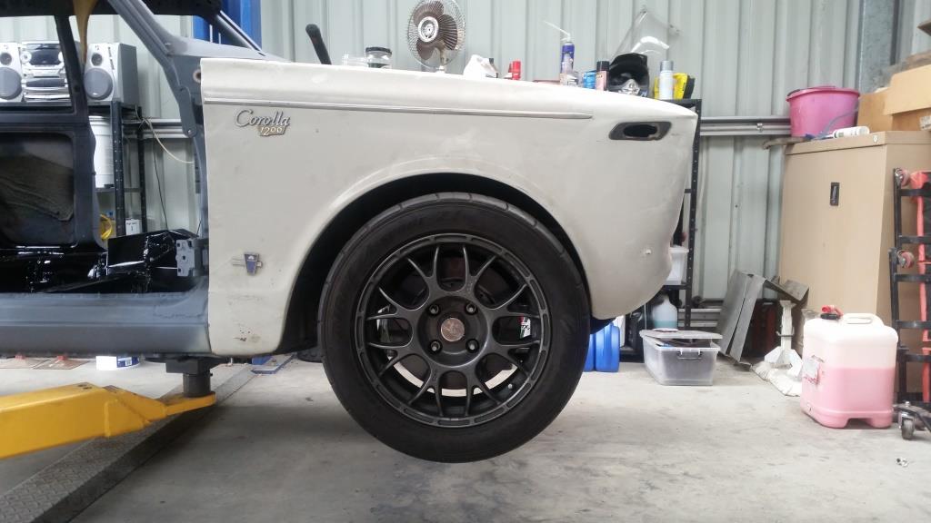

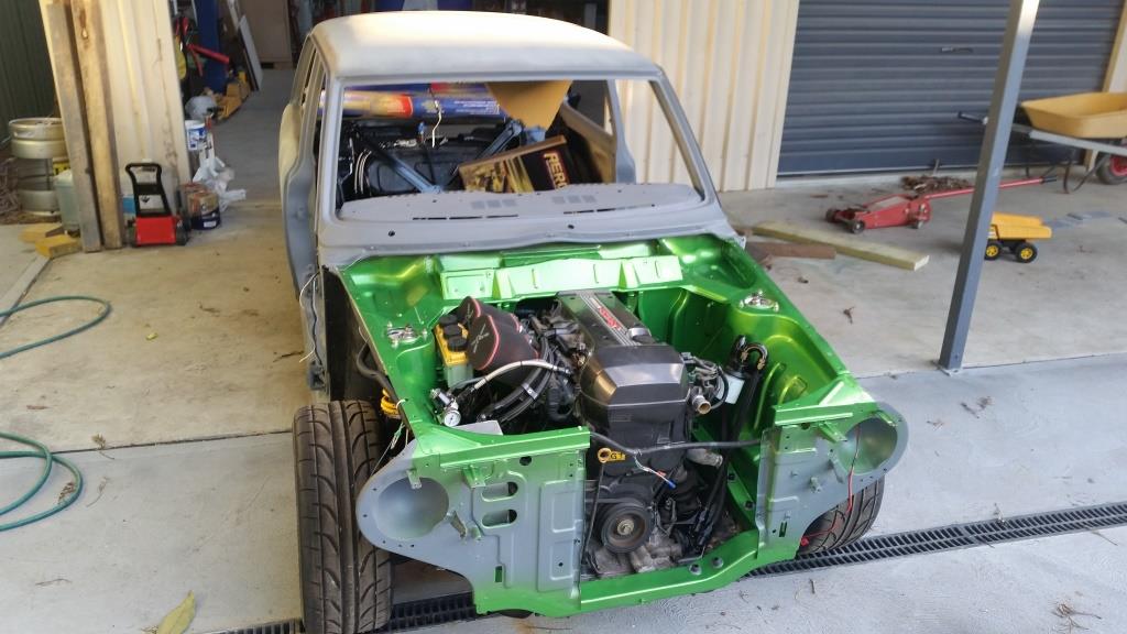

  5. Front suspension is in now, after everything I've been through I now need to get the fron sway bar remade as the mounting position is different - damn changing my mind on what works best with what!!! These aren't the wheels I will be running as they 15x7 +27 on the front and don't fit within the guard so I'm going some Work wheels instead :)

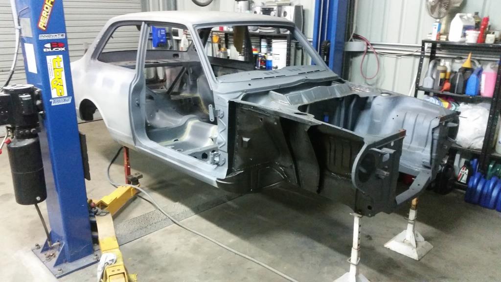

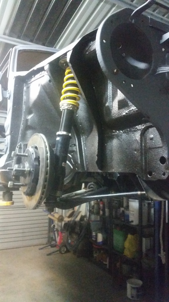

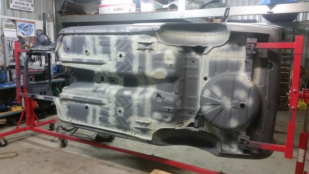

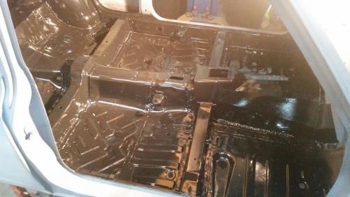

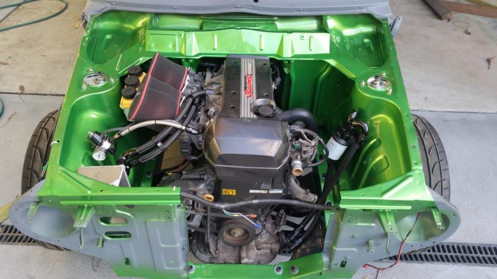

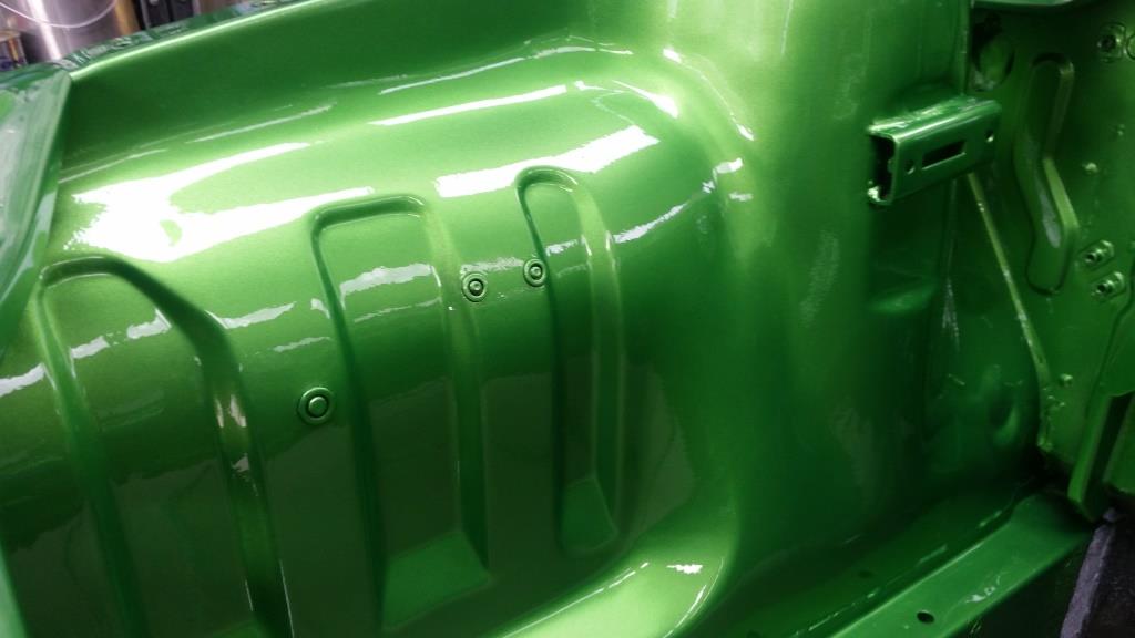

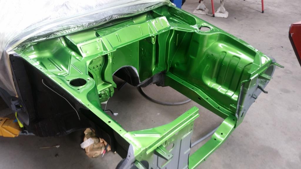

  6. More progress :) Off the rotisserie and inside painted, engine xmember is now painted too so I'll be trial fitting the front suspension and making sure everything will fit inside the standard guards this weekend.

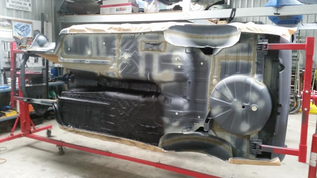

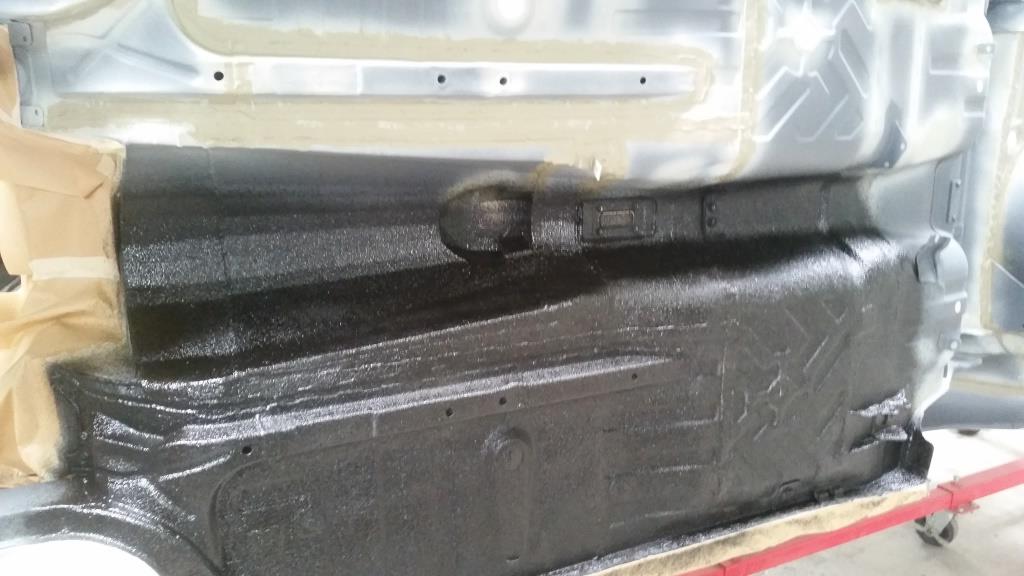

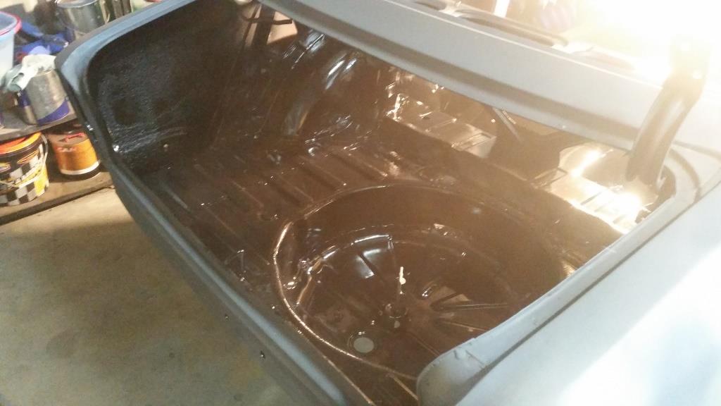

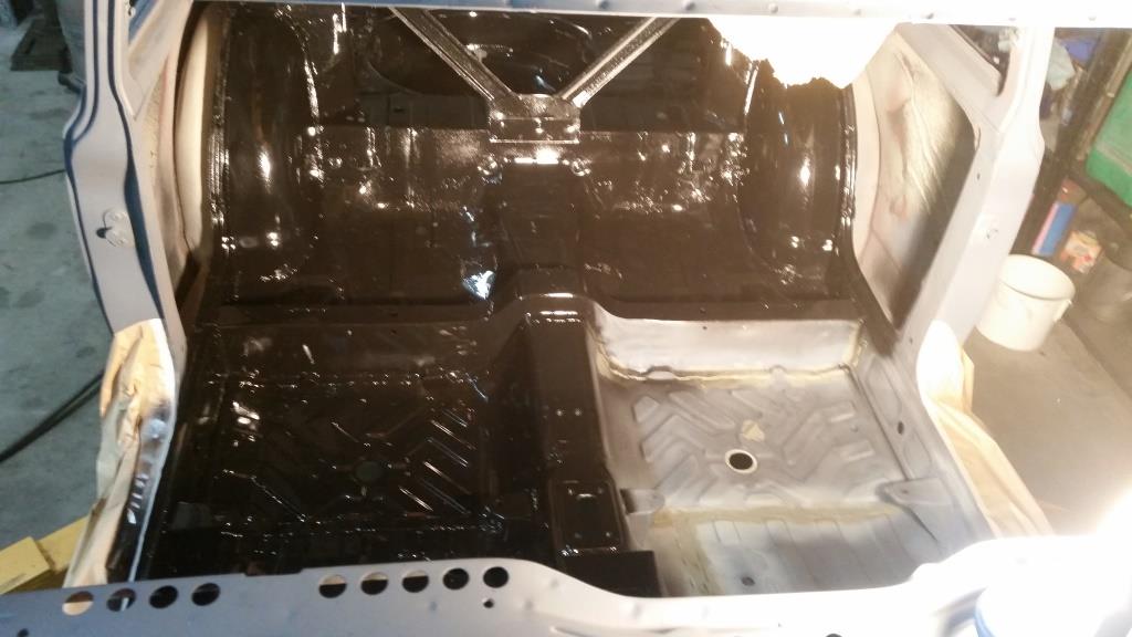

  7. I used 3-3/4 cans in total Altezzaclub. A bit of a surprise as I only bought 2 to start with. Yeah it looks really good and I'm stoked with how its come up. So much inspiration to get the inner cabin painted along with the suspension sand blasted and painted. I'd like to have the motor and driveline dummy fitted again very soon to see where I am at with the engine bay as its been forever since the motor was in and I can't remember what exactly I had left to do. Plus I need to finalise the front end suspension to allow me to part out my spare gear to fund more of the build haha

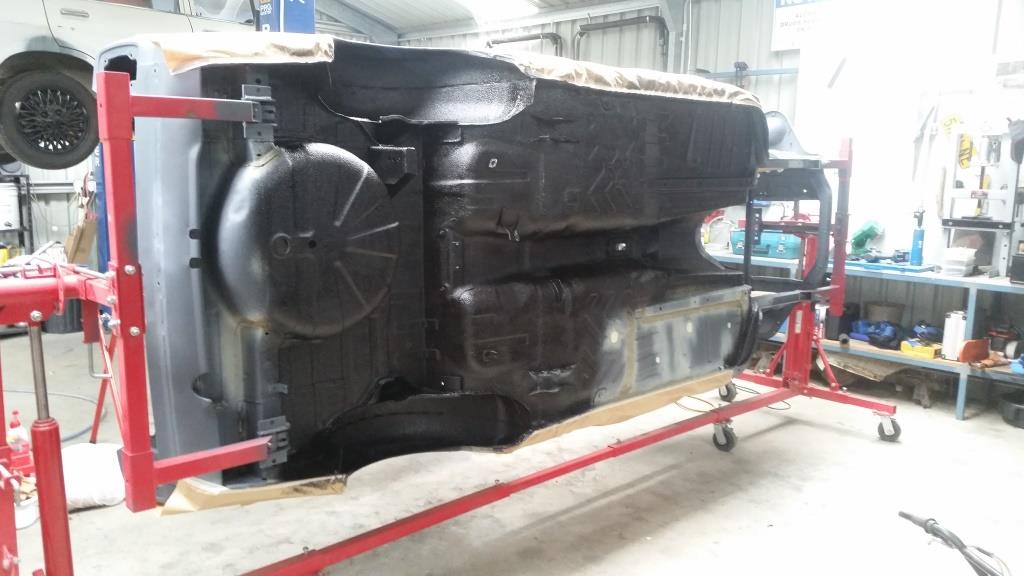

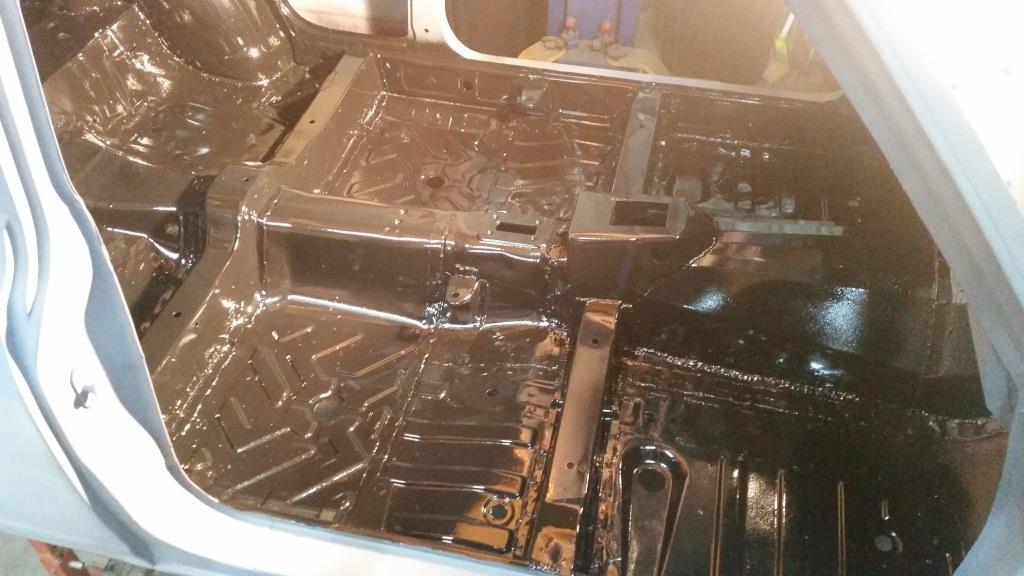

  8. Hey 67Rolla-Ken, It is a spray on under body sealer. I bought is from my local autobarn store. It is 'Motorspray - stone guard'. You use a special gun that screws to the lid of the can and sprays out through a 7mm nozzle, it gives a textured finish that protects against rust, stone chips and helps with road noise reduction. They use it on most new cars too.

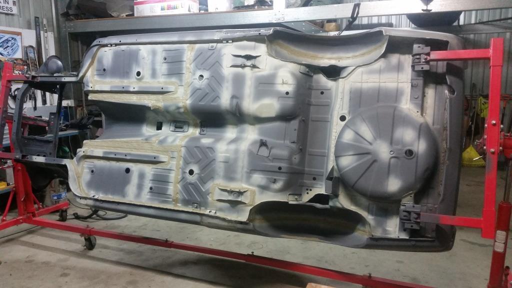

  9. So its been way too long between updates on the old girl as I've been busy with other things. I have however been doing little bits and pieces over the last few weeks and this weekend presented a major milestone completed. I FINALLY sealed the underside of the old girl which will allow me to get her off the rotisserie and move ahead with the painting inside and reinstalling the driveline over the next few weeks. A few pics to show everyone what happened.

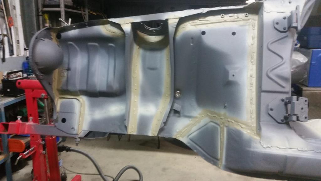

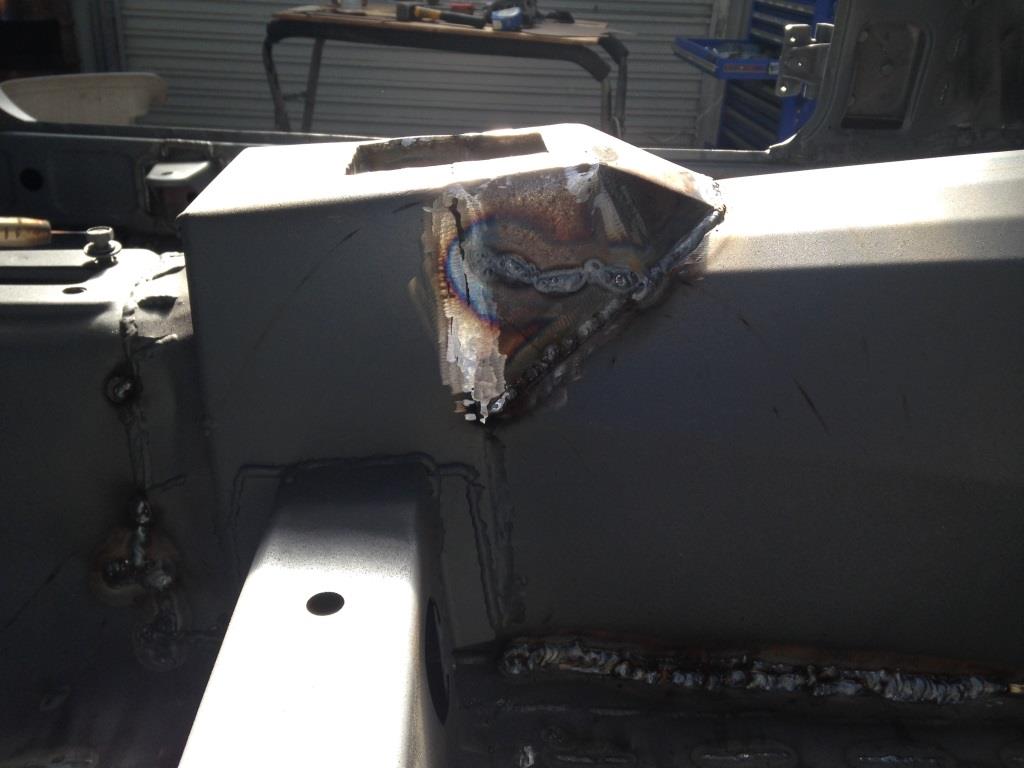

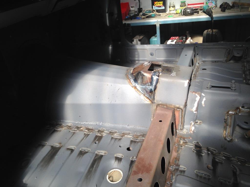

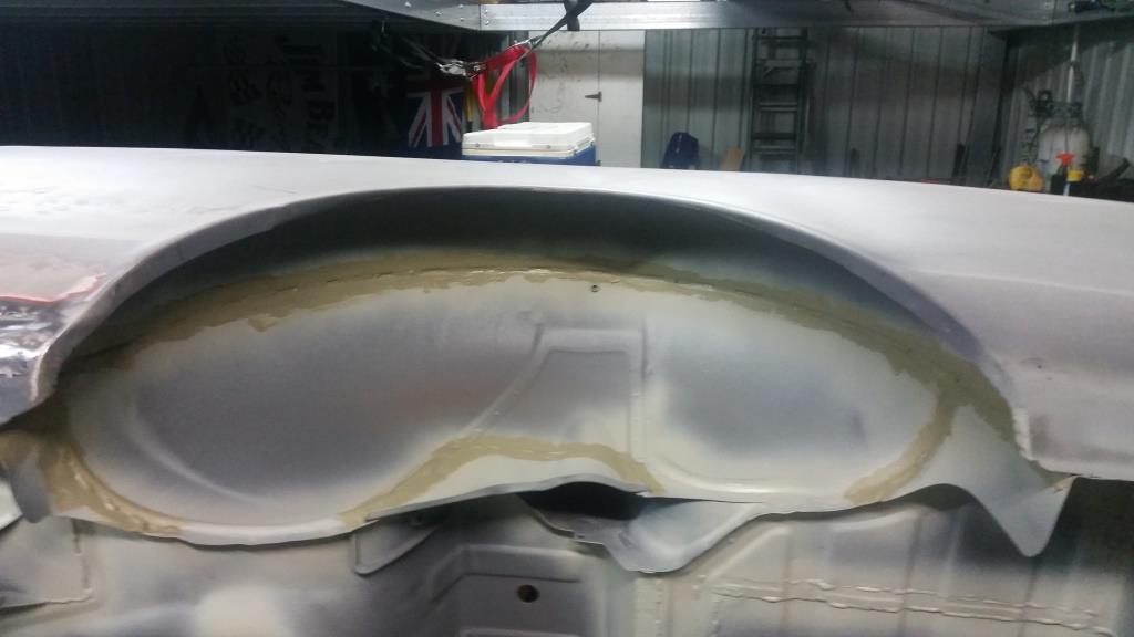

  13. Just a word of advice Birksyy, make sure your seams are extremely clean before welding. On a couple of mine the sealer had melted between the panels and caused the welds to be less than desirable due to contamination this caused me to go back over a couple. Also it might be easier to drill extra spot weld holes on all the accessible areas and weld it up like that, I read an article about seam welding the other day and they were talking about the stresses on the steel from welding the edges like I have. Probably not a bad idea to stitch it instead of laying seams to, would make it much neater.
  14. Cheers 67Rolla-Ken, I can finally see the end of the tunnel in regards to the bodywork and the whole project for that matter. I am just stoked to have the welding done and it nearly ready to be removed from the rotisserie. It will be nice to have some space back in the shed to have a clean up :)

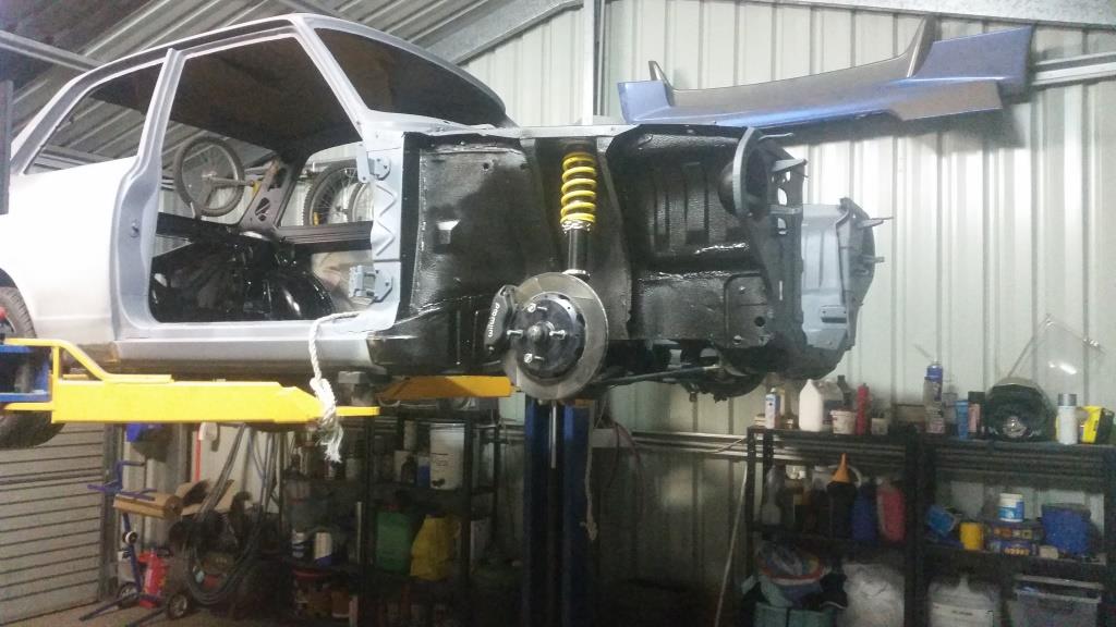

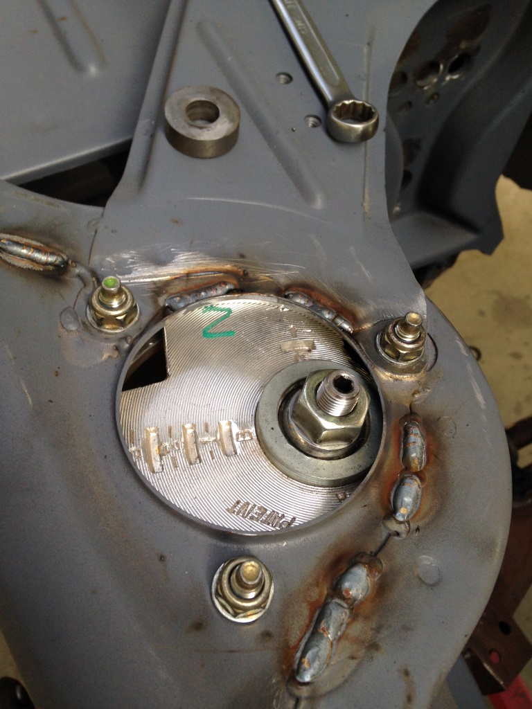

  15. So a few things have been going on lately with the new front suspensions setup and body work. Firstly I have mounted up the front suspension and had new camber plates made to suit the K-Mac tops I now have. This setup gives me around -3deg camber and more than enough castor. I also finally finished the shifter surround in the gearbox tunnel. It should look much neater once its got some sealer and carpet over it Now to just grind back a few welds and get the underside sealed up :) hopefully it will be back on her wheels and driving by next weekend
