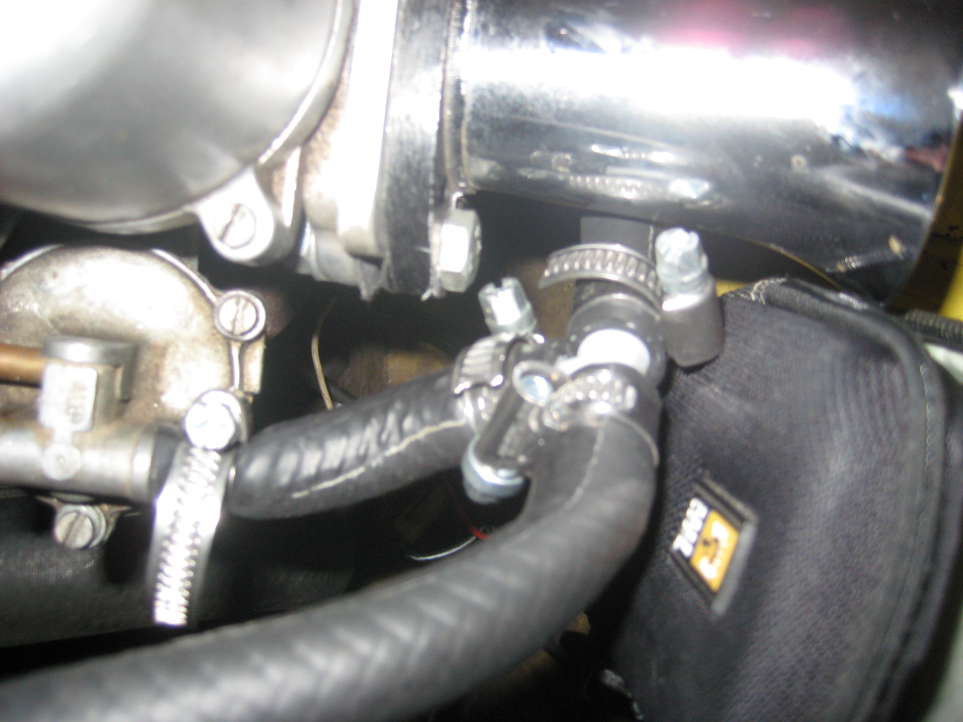

Fuel Coming Out Of Breather Plz Help!!
All sorted the needle and seat was loose so not sealing!! Thanks so much guys. Made it alot easier! Cheers everyone
Hows the best way to check that???
So what should i do cause its coming out quite alot. Its not pressurized but its definatly just flowing straight out. Should i run it for longer to see if it stops??? If not what do i do??? Thanks guys
I don't thing its a fuel return because if u block it the car stalls straight away. Return wouldnt do that. By the way the piston that you can see through the ram tubes is a bit sticky on the rear carby. This is the on the same carby with the leaking hose. Could that be related??? don't think fuel pressure is the issue cause I'm still running standard mechanical pump
hey guys ive added some pics of my 4k with the twin su carbs fitted. ive hooked up the fuel feed lines to both fuel bowls and left the other opposite pipe on the bowls to vent to atmosphere. car runs perfect and everything working fine exept there is fuel pissing out one of the breathers. or what i think are the breathers. can u tell by looking at the photos if ive hooked it up wrong or if somethings broken. ps if i block off the leaking line the car misses then stalls.
