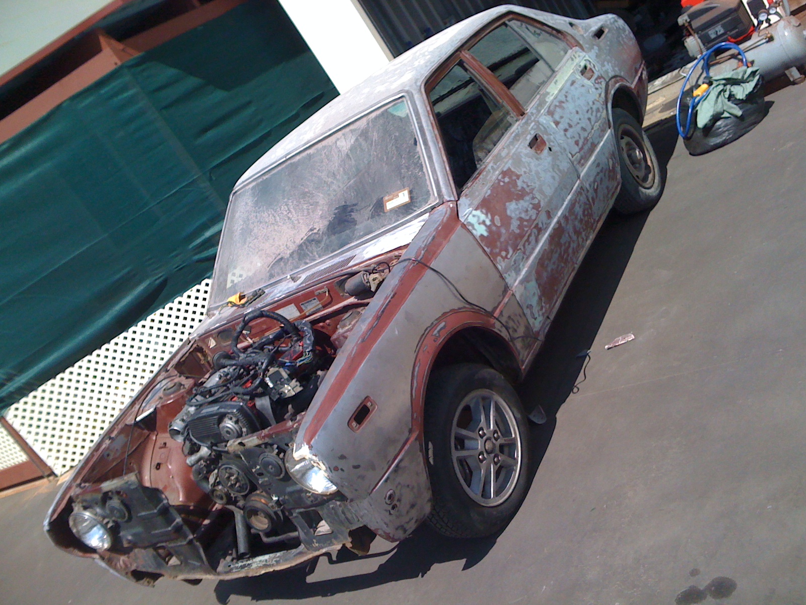

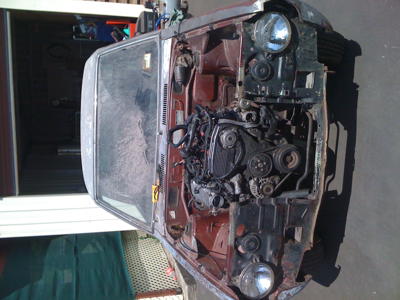

  3. Hey all, May as well start at the beginning. I am a fully qualified Mechanic. I have recently moved to Mill Park (just near Bundoora). I have a 1976 Ke30 4 door with a CA18DET including Transmission and custom driveshaft. Up front are some RA60 struts, hubs, rotors and calipers which will soon have new bearings, shortened strut inserts with coilovers, machined standard rotors and green stuff pads. My first issue is the Positive Camber. Is there any adjustable LCAs or Camber hats for the ke30? As I have nearly finished the front end I am now looking towards the rear with the diff, I have read through the forums and have worked out I need either a Hilux diff with LSD or an R31 diff with fairmont LSD. Problem 2, Hilux stud pattern is different? strength of Fairmont LSD? cost(budget of $1500-2000)? sourcing parts? and an engineer to build it? After this I want to have the whole shell sand/soda blasted, which also means removing and refitting front windscreen and rear window. Number 3, Anyone know of someone to sand or soda blast around Mill Park? and also someone capable of fitting a Windscreen and rear window tidy? Then I will prep and paint the car myself, after which I will need to get the seats, door trims and dash upholstered. Then Exhaust, Tune and mod plate. Which brings to number 4, anybody know of a good upholsterer? Exhaust shop? Tuning shop? and someone to mod this nasty piece of Metal? P.S hope the Rollaclub scene is good down this way cause this beast is gunna be out to every event once its done running, I don't think it will ever be done, always room for improvement :cool: Cheers all for any Info Richard

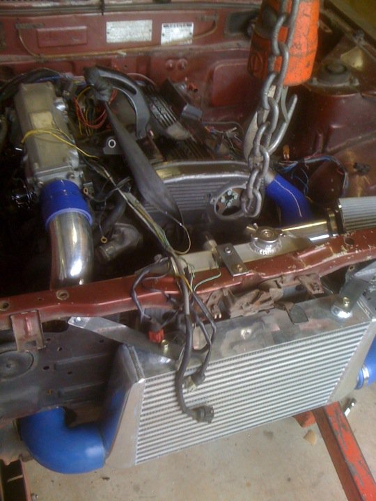

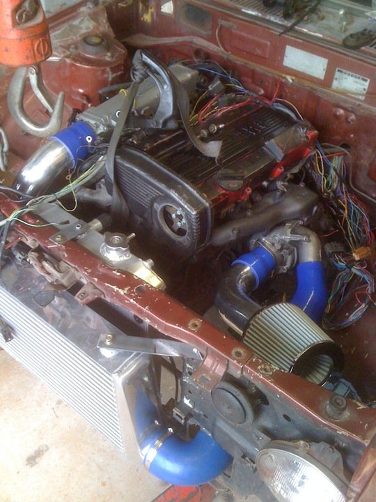

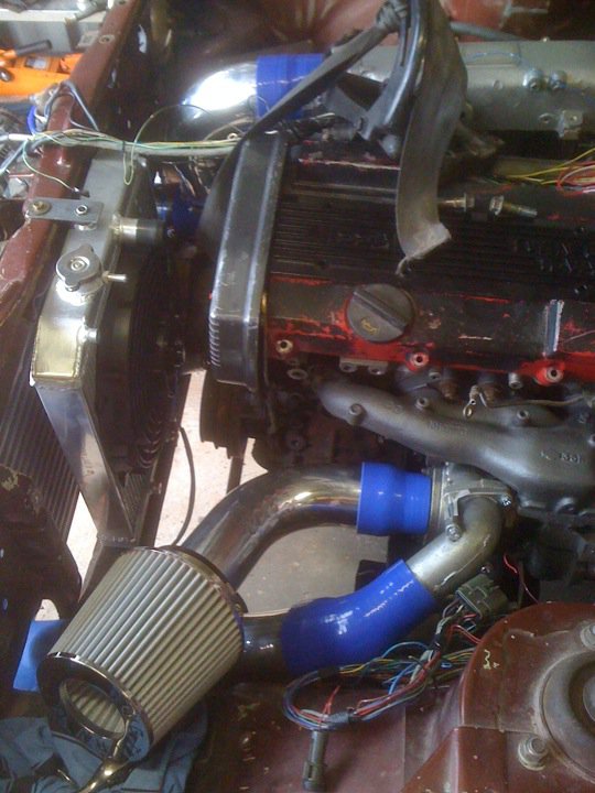

  5. This is my ke30 which has taken me around 4 months so far of buggering around. Current modifications Ca18det with 5 speed Alloy Radiator Intercooler with custom piping Battery mounted in passengers footwell All custom wired relays and fuse box under dash Ra60 front struts and brakes King springs in front Custom tailshaft To come... Surge tank (half done) Candy apple red paint job 15inch rims Checker plate dash (half done) All custom gauges 2 3/4 inch freeflow exhuast Black vinyl interior (half done) Stereo (simple, components in front, 6x9s in back) and being a ca18det there will be many more future mods
