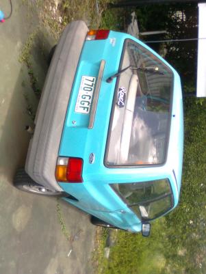

  1. For Urgent Sale, located in Bowen Hills. 1993 WA Festiva 3 door hatch. 196000kms. No rego or RWC. Large dent in driver's door. Runs beautifully, revs cleanly, easy wheelspin :P. Very light car. Unreasonably good on fuel, could probably do a 3 point turn in most driveways. 4 good tyres, all lights working. No major rust. Even with the big dent in door, window winds all the way down, opens from both handles, locks fine. Don't see it being a roadworthy item. Has all new ignition components. Never overheats. And for the bad. It leaks when it rains, and thus features a mouldy interior which I'm not going to clean, cos it's my sister's car. Has a hole in the exhaust. Doesn't sound fully sick, just shitty. Would need fixing for RWC. Due to sitting for about 6 months, the brakes are hard as a rock, rather ineffective. Again, would need fixing for roadworthy. Buy it for a paddock basher, reliable throwaway transport, or whatever you like. It needs to be gone, so feel free to make offers. Contact me on 0422847730. Cheers, Nathan.
