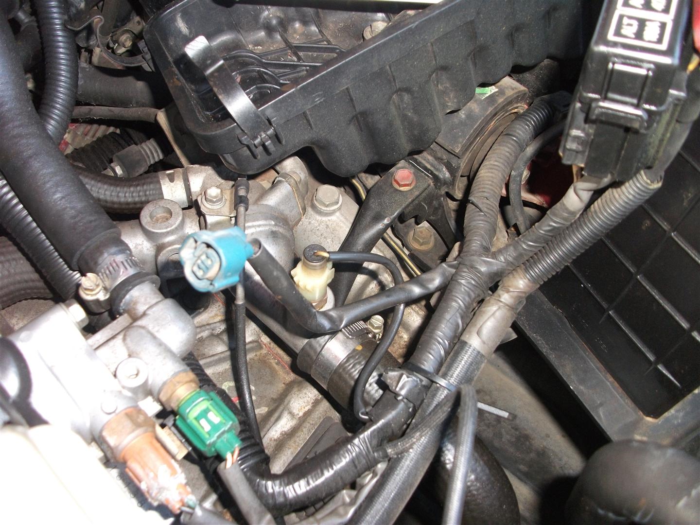

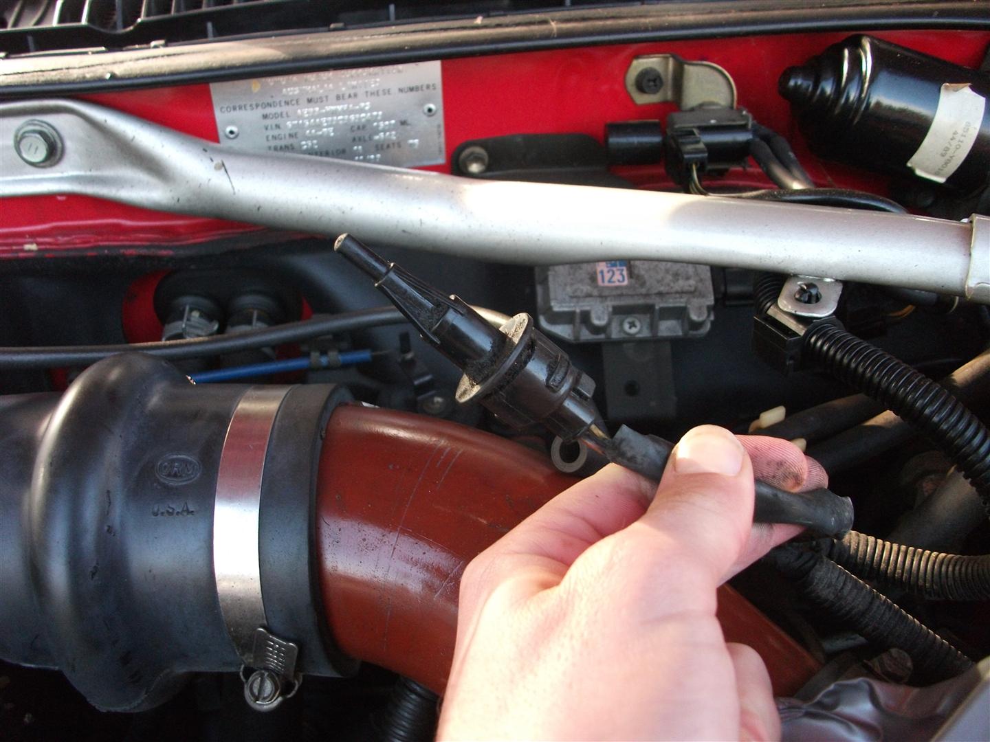

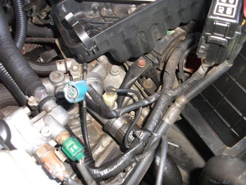

  6. o right could explain the high idling. should that pipe be blocked?
  7. brilliant that's one down. two to go thank you for that.

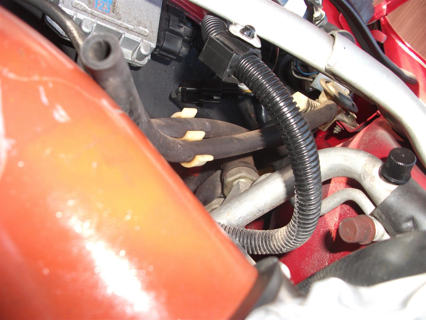

  8. ok so i just bought an sx corolla with 4age small port.now some dude has done quick home job on the pod filter.there are a few things hanging around i would love it if someone could identify these for me as i don't no how important they are. please help anyone? and this one is the lil blue plug thats not connected to somthing? this one is the little black pipe on top of the red air flow pipe and this one is of what looks like a sensor of some sort?
