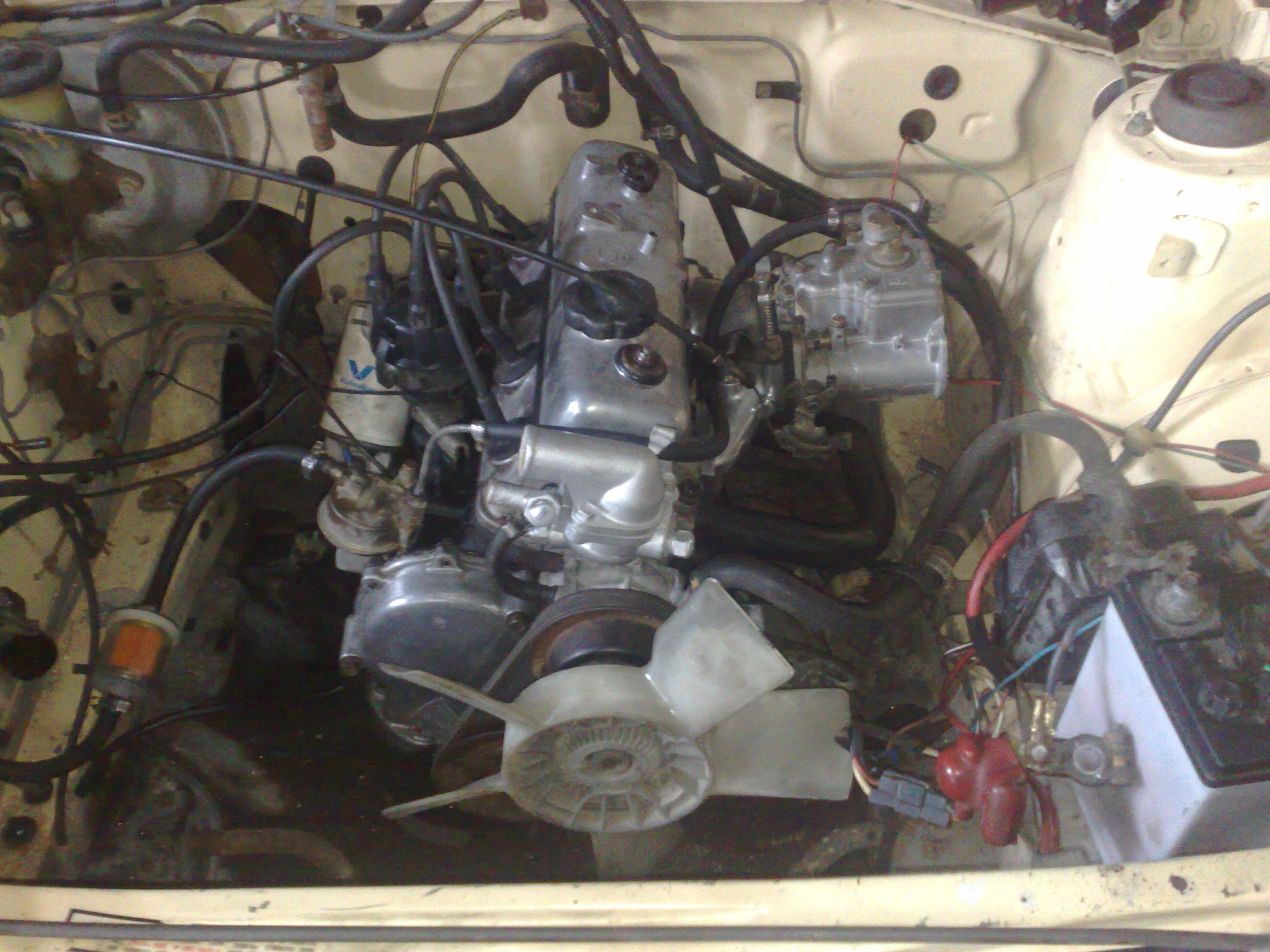

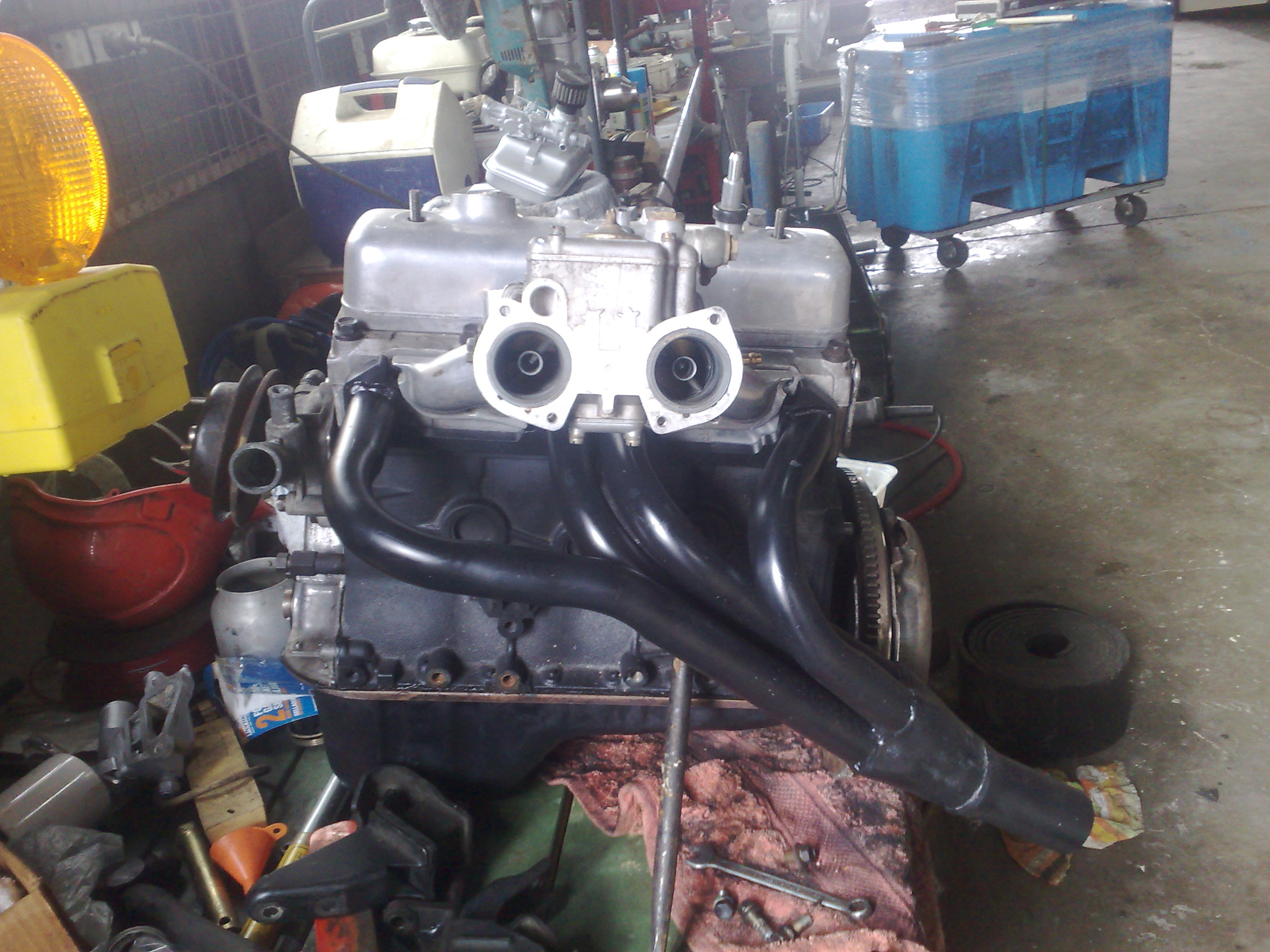

  3. Well found out what it was.... Here we go but before i do thanks everyone who had a go would like to let everyone know the car is now up and running was not oil starvation or valve train stupid me put the wrong bolt on the cam gear (retarded i know but come on we all make mistakes) and it fell off, the lifters were re faced, after extensive examination I'm very surprised it has not wrecked any thing at all just a grind mark on the cam cover,is this normall? i thought it would have f@c$ed but for now the cam is bedded in and is running i think trd ke70 got the closest and is the winner have a small clip of the car running will try get it uplater
  4. Hey guys just wanted to test some brains out on here, ive been doing up a 4k motor and what ive done too it is as follows, Head shaved ported and polished, race cam thige 401, heavy duty springs, block decked and alligned and crank ballanced, flywheel lightened too 6 kg twin 42mm webers high flow extractors etc etc, now here is the question after spending so much time putting it back together, ran for bout 2 mins and stopped with a really bad graunching and died right then and there, will be pulling it apart tomorrow to find out what the cause is just wanted to see if someone out there could guess and see if someone gets it right ill let yas know tomorrow night so good luck guessing!

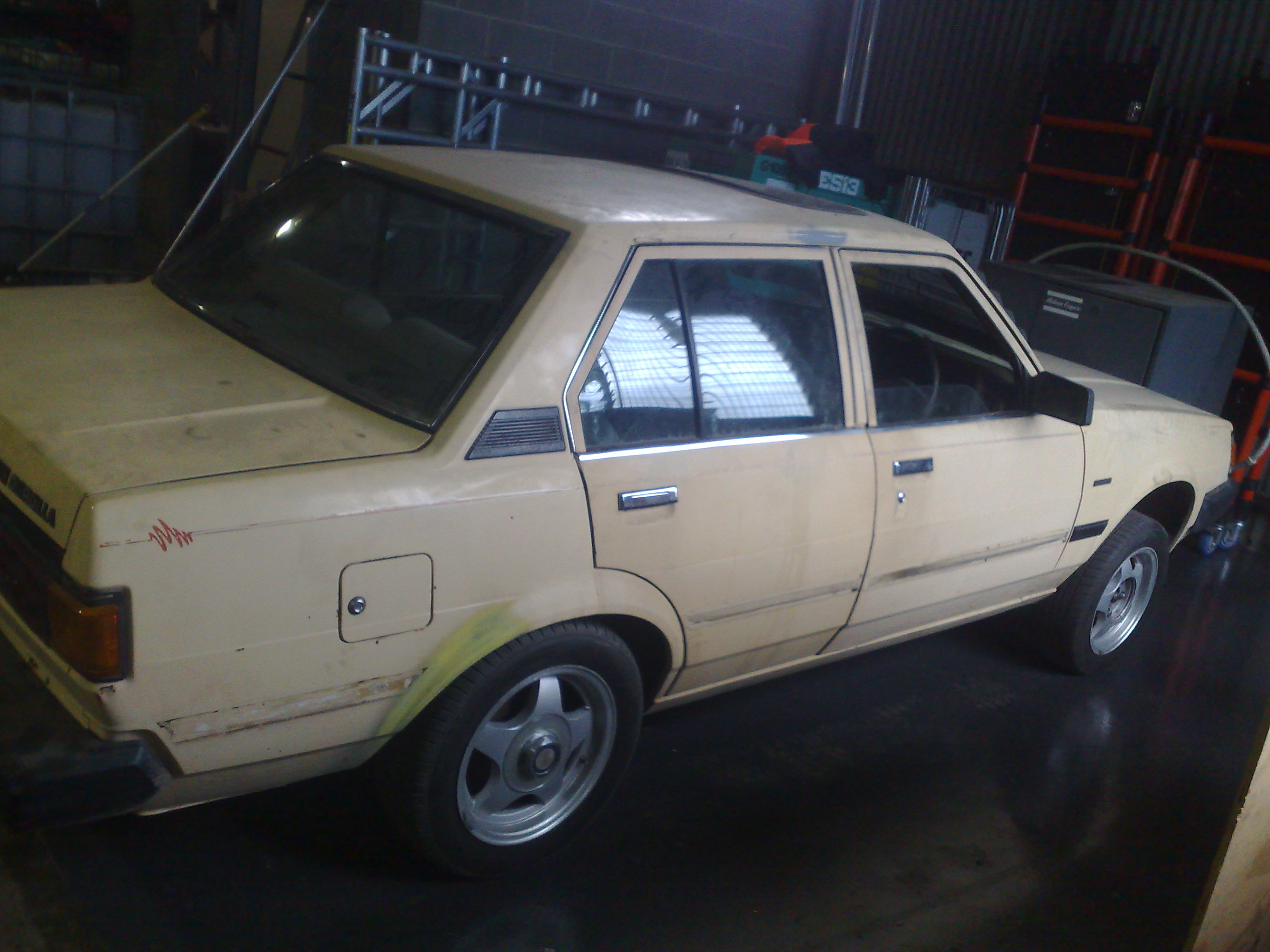

  5. well i don't reckon the rolla will ever hit the 300 mark thats what the bikes for, rolla for fun! have owned 5 escorts in the past wrote off the last one so thought id do a rolla this time round see how fast i can make it go
  6. Hi all my name is Steve i live in Marsden am currently doing up a ke70 4k not much to go now, will be doing the body at another stage just spent heaps on the motor currently drive a my04 wrx and a triumph daytona 955i can't wait to finish the rolla and go for a cruize
