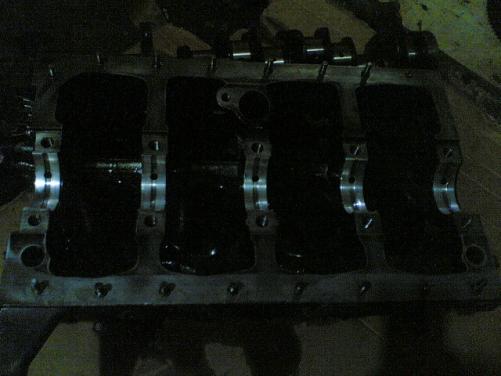

  5. Initially I was thinking to go with standard piston and same bore but after a detail checkup found that there are few scratches in bore and when we placed "0" size rings in this bore there was gap between ring ends gap was near about 0.3cm. So now re-bored at 0.50
  6. Now purchasing side. 1. Piston & Pin (0.50) 2. Ring Set (0.50) 3. Main Bearing, Set (0.50) 4. Thrust Bearing,Crankshaft 5. Valve Set 6. Valve Guide 7. Bearing, Connecting Rod 8. Bearing Set, Camshaft 9. Sprocket, Camshaft 10. Gasket & Seal Kit complete 11. Timing Chain 12. Tensioner, Timing Chain 13. Oil Pump 14. Water Body

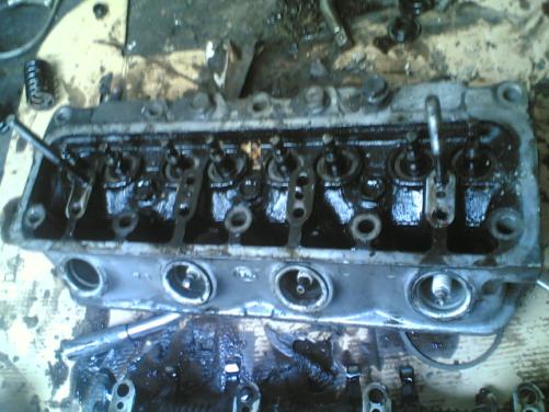

  9. Few other photos of crank, pistons and head while washing Engine Water body, its bearing was also making some noise.
  10. Pistons were at standard size "0" Crank Shaft was already at "0.25" Moving toward head Valves were in very bad shape you can see in pics.
  11. Apologies for the delay. Photos when we started our work In Rocker arms Cover you can see that water and oil mixed in yellow color Block Assembly Pistons not in good shape 2 of them were quite rough from sides

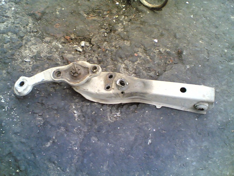

  16. Progress on the weekend Saturday Progress – it was freaking cold there temp was near -1°C but still managed to work 1. Steering Rack changed - previous one was in very bad shape. 2. Steering arms reused. Both were in good condition 3. Lower Control arms changed 4. Front struts one of them changed because it was damaged. 5. Springs changed front/back previous ones were wielded 2 inch packing was placed. Now packing is removed and new springs in place 6. Shock absorbers are replaced. Day ended with washing engine bay, using degreasers and rest of the car cleaned up there was huge deposit of mud underneath. Sunday it was little bit dedicated for dash/ electrical started my work bit late 1. Opened the dash and there was huge amount of dust. 2. Tried to clean it up with air pressure but all in vain. Then used the paint brush and all done manually. Due to cold/bad light winded up my work just screwing back the parts. And found that there is some problem with indicators/ break switch/ hand break switch/ reverse light cause none of them working now….lol Now again have to wait for 5 office working days. Photos are on the way will be posting in a while.
