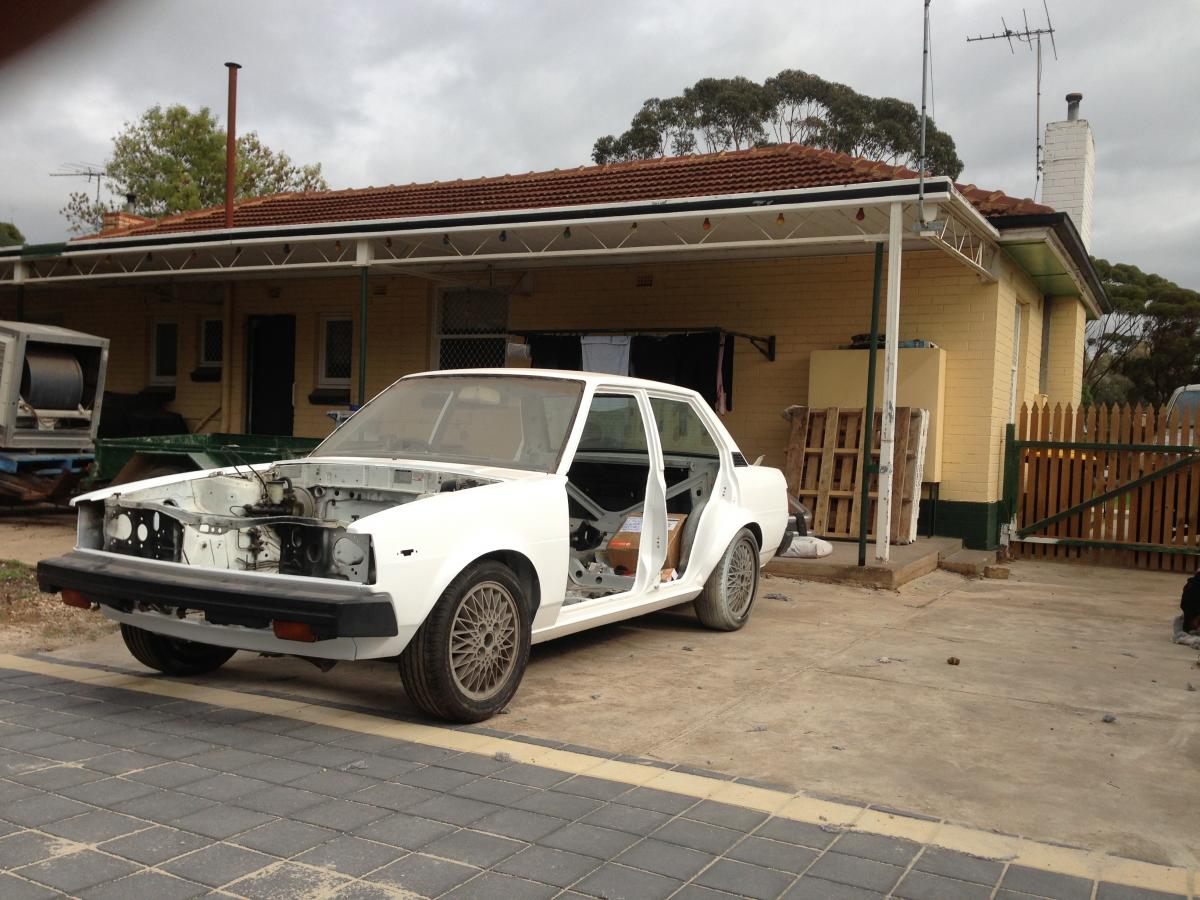

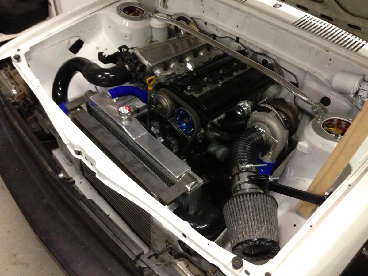

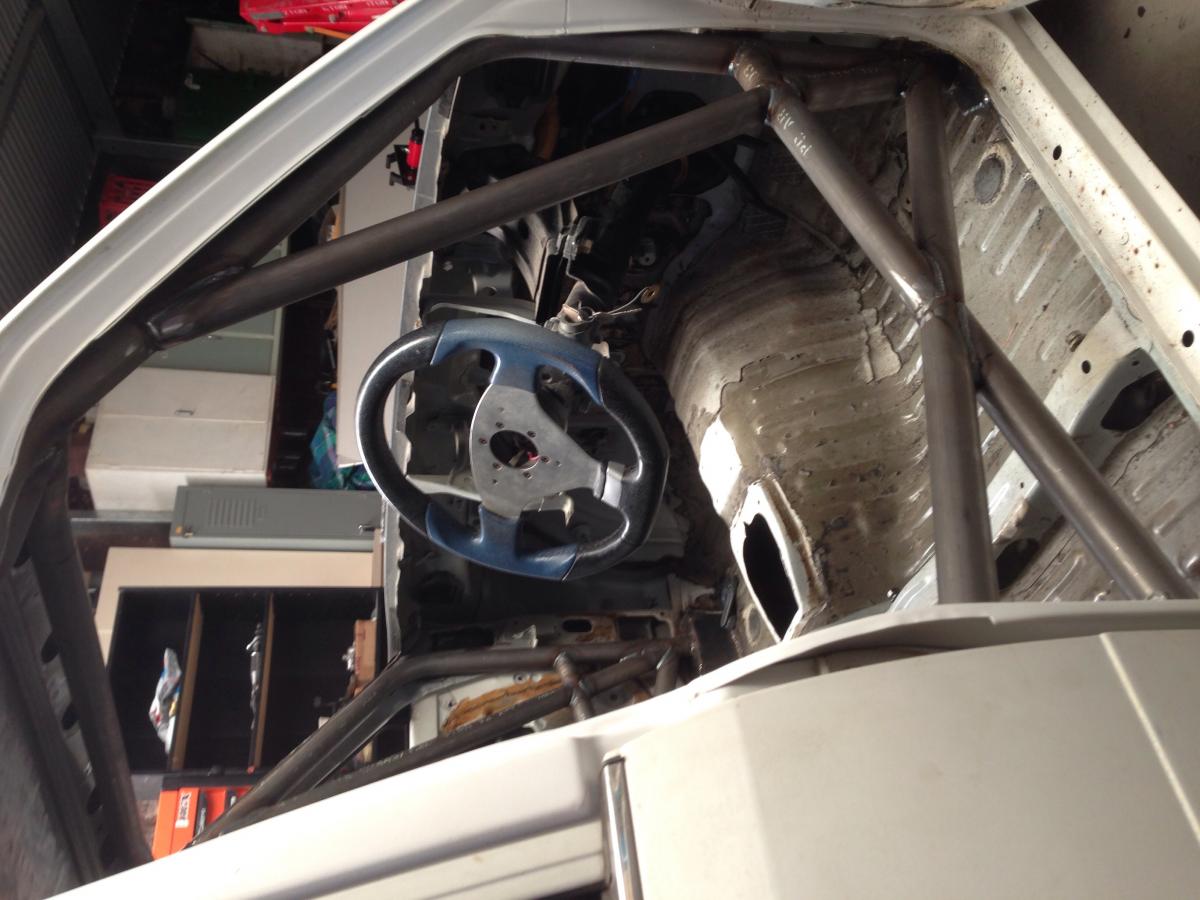

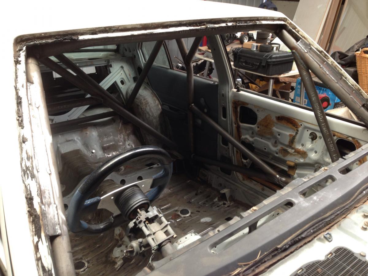

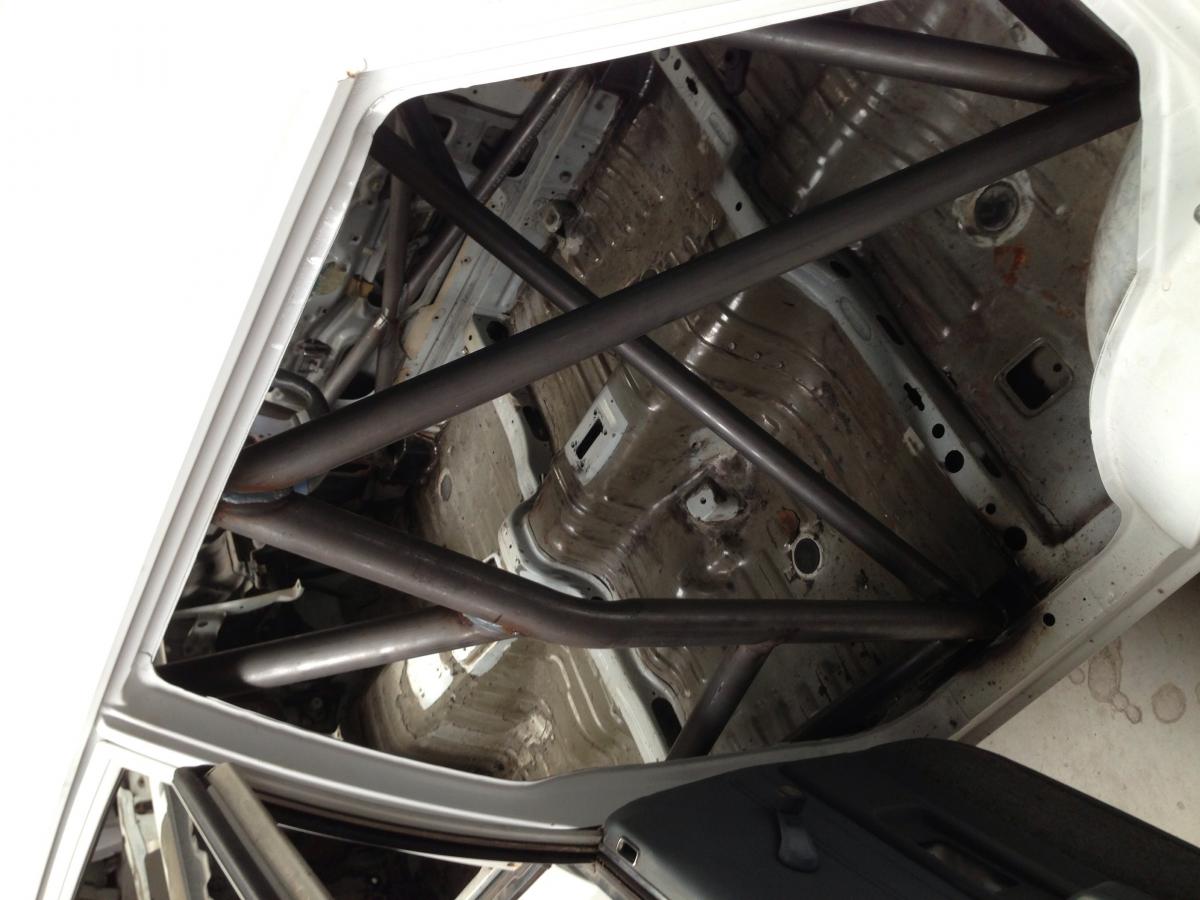

  1. Bought a SM2 autronic, cage is done, engines in and just fitting up all the accessories. It's no show car but I'm happy with the way it's coming together. Also panelling in the radiator/intercooler.

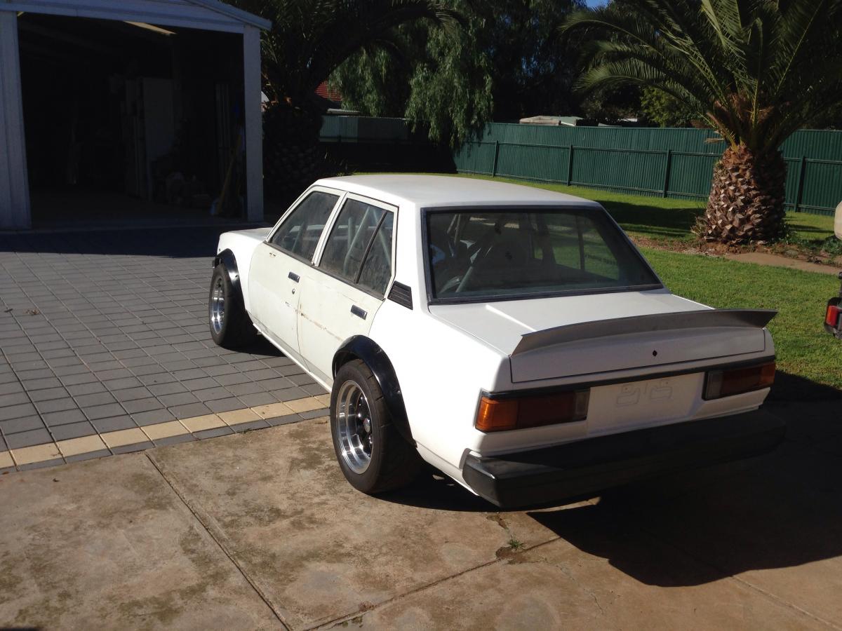

  2. Sooooo, it's been a while but this is were I'm up to now
  3. Somewhere around 230-240kw atw hopefully, yeah has to run a 36mm restrictor.

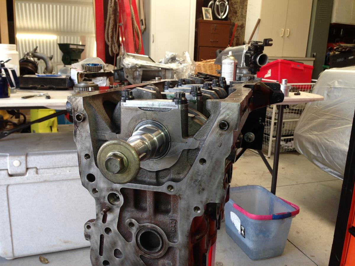

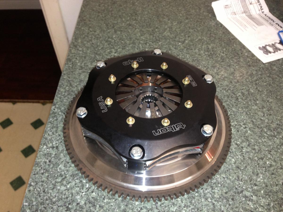

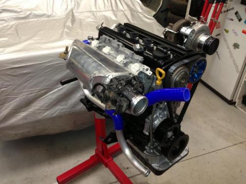

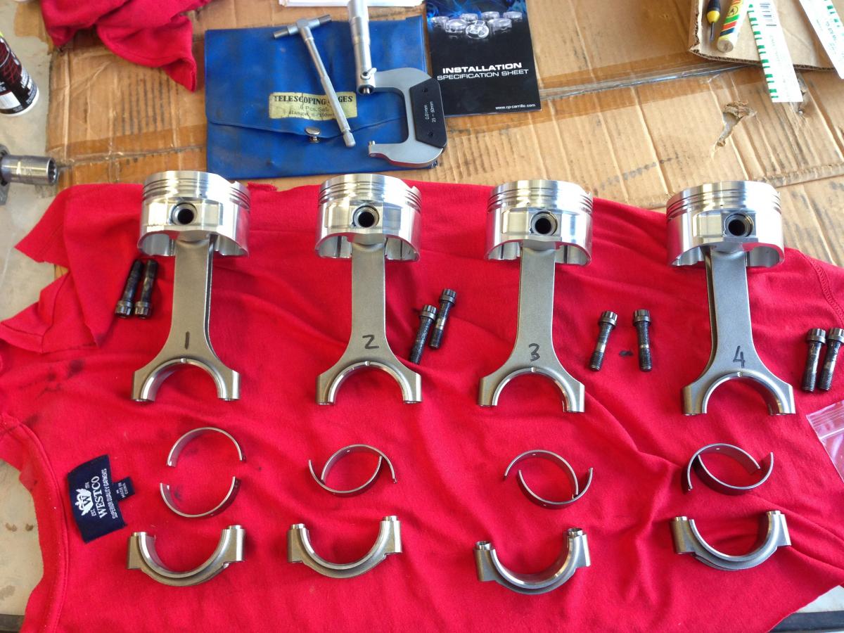

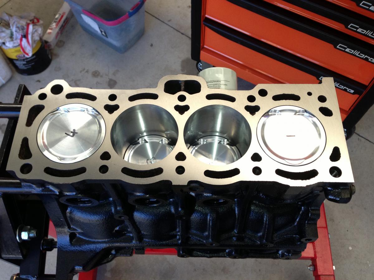

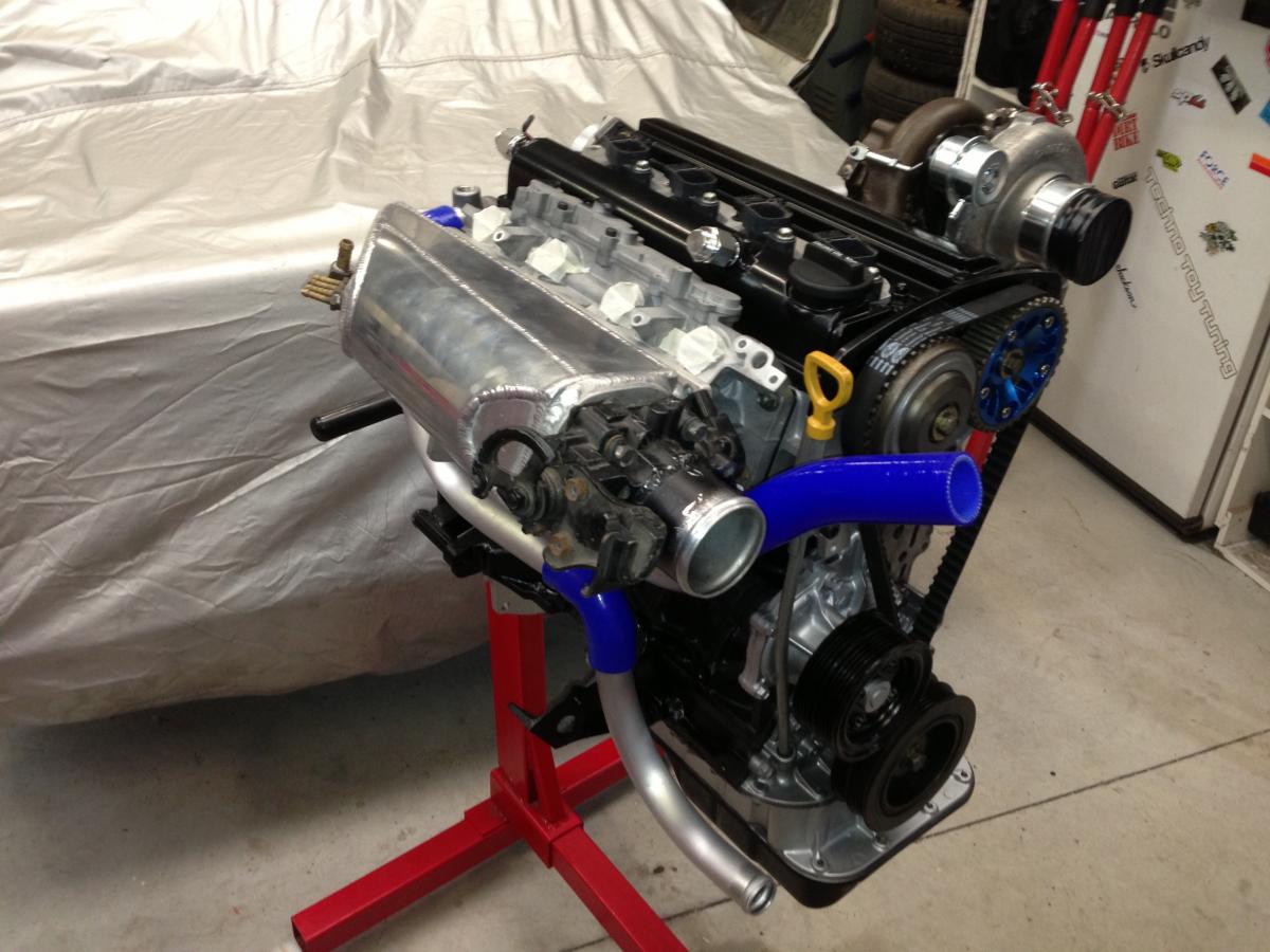

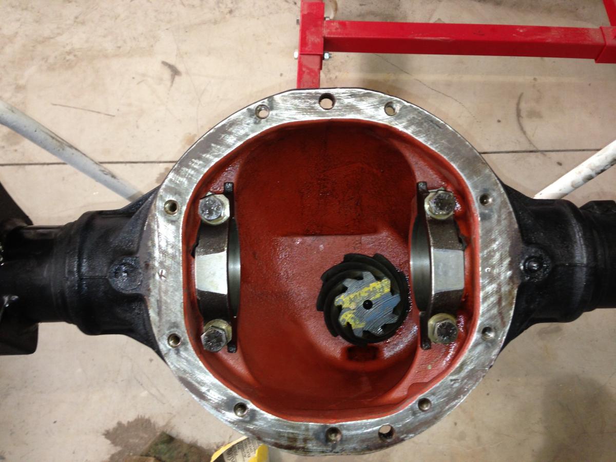

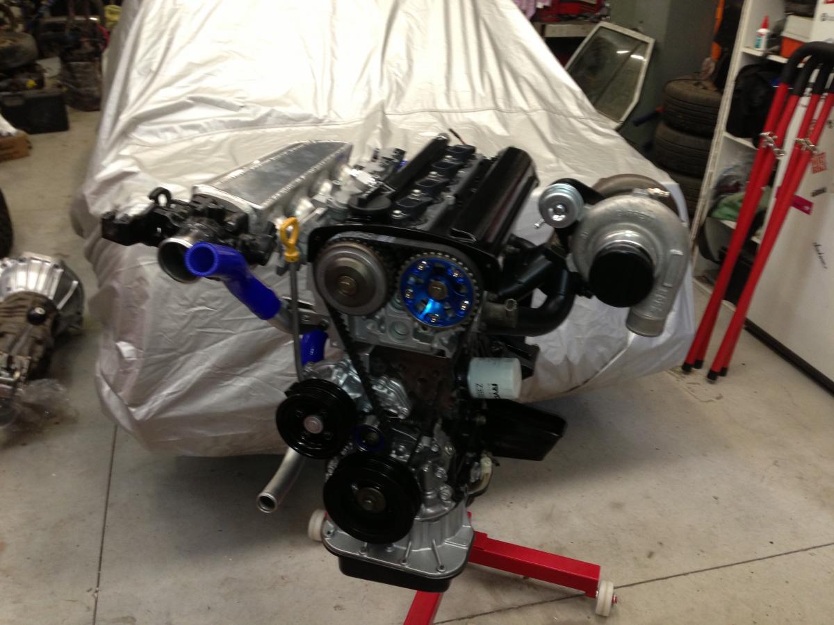

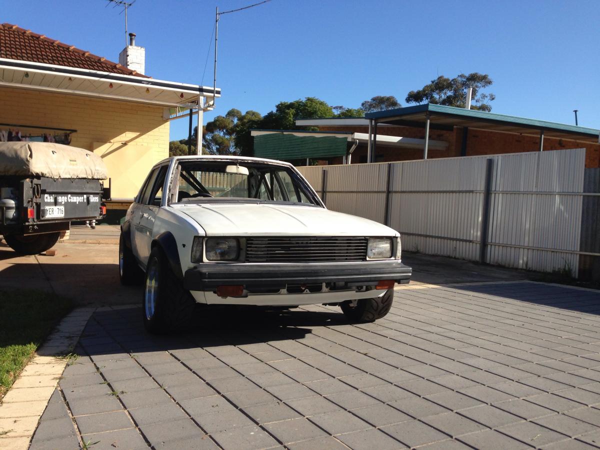

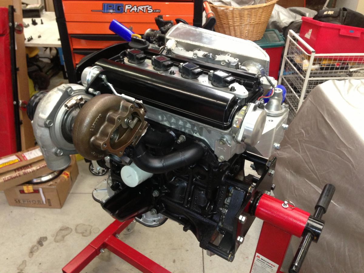

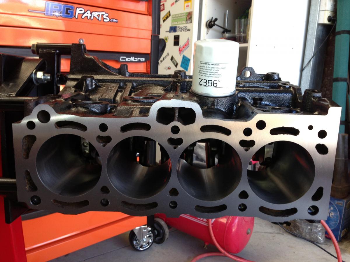

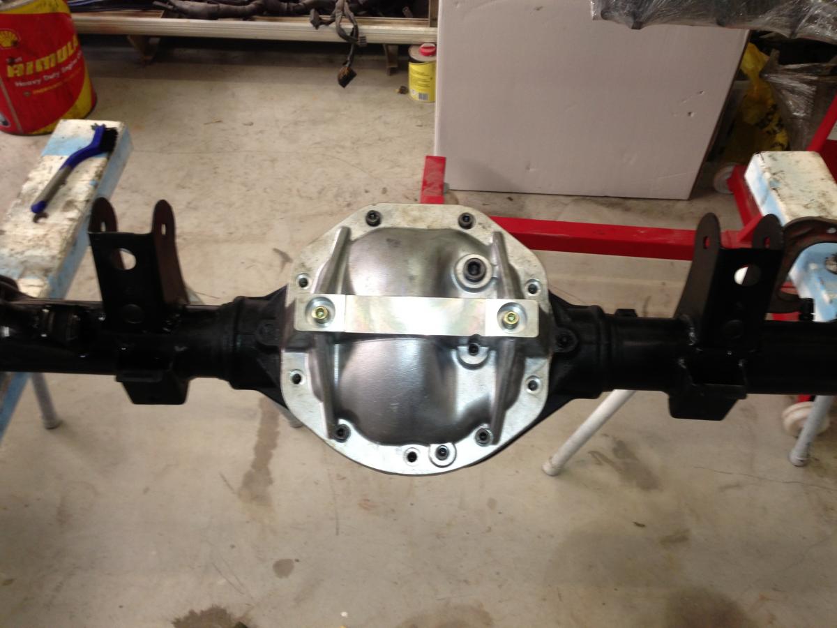

  4. Thanks mate I appreciate the feed back. As for the diff cover basically it stops the centre bearing caps from flexing under load, I've machined the caps so that they have a flat on them, after that there are little pedestals ( like the threaded feet you would find on a G clamp that apply downward force on them) its just a aftermarket mod. It just replaces the factory pressed steel diff cover. Cheers Grant.
