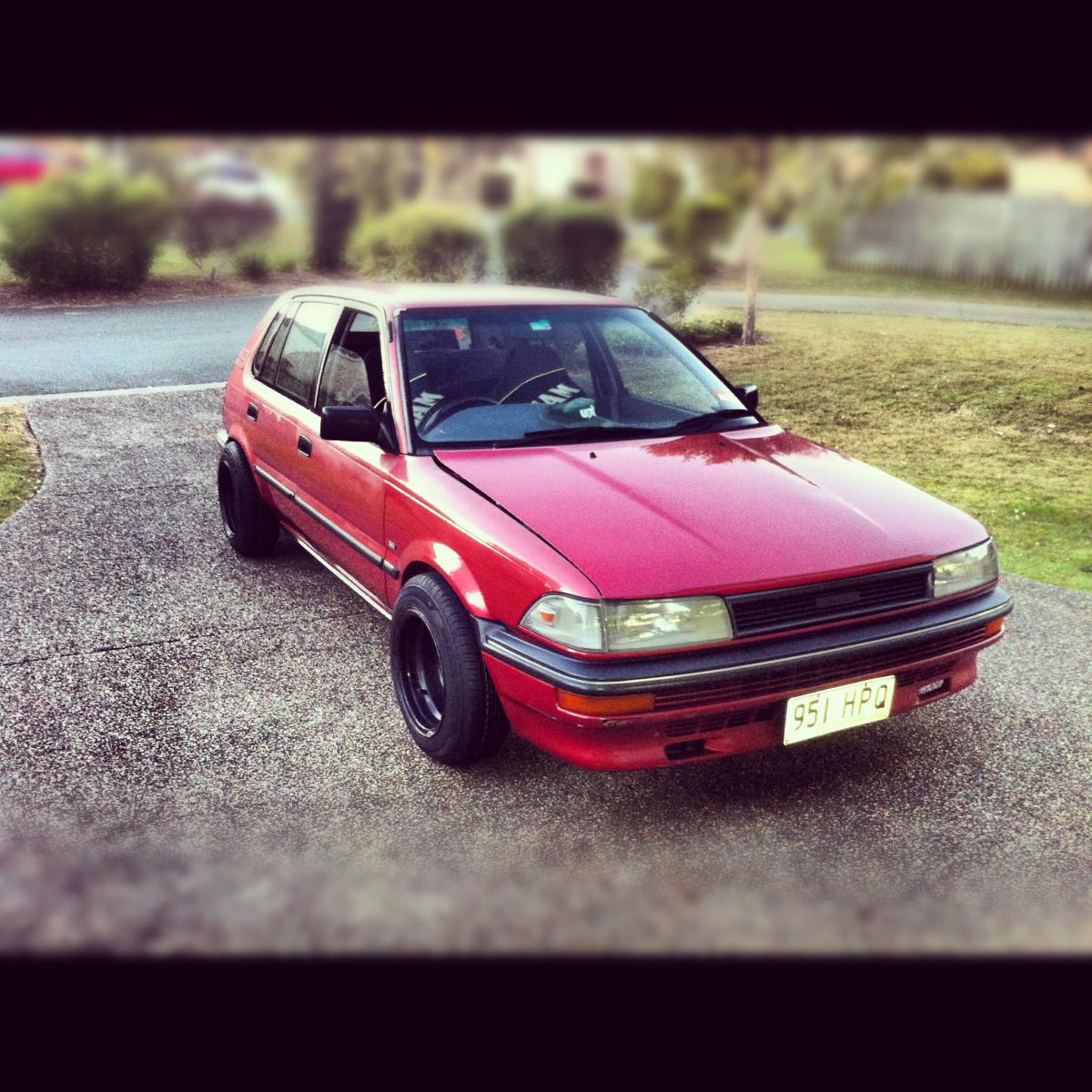

  5. Hey guys I thought I was reading somewhere where Ae92 Struts and Celica struts where interchangable? Celica struts where around the 40-60mm Shorter ?? I have looked around but can't seem to see where that was, or possibley I was dreaming... Can anyone shed some light on this for me ? I'm trying to run a shorter throw shock with my springs to get the low/stiffness I am chasing without going coilovers. I'll attach a pic of the car with my rims that I am trying to run, as an example of ride height etc. As you can see the rear is a little soft and has rims in the back seat so its sagging abit, but realistically, height is about what I want in the rear, as for the front, can prob come down close to another inch. Any help would be appreciated. Regards Brownie
