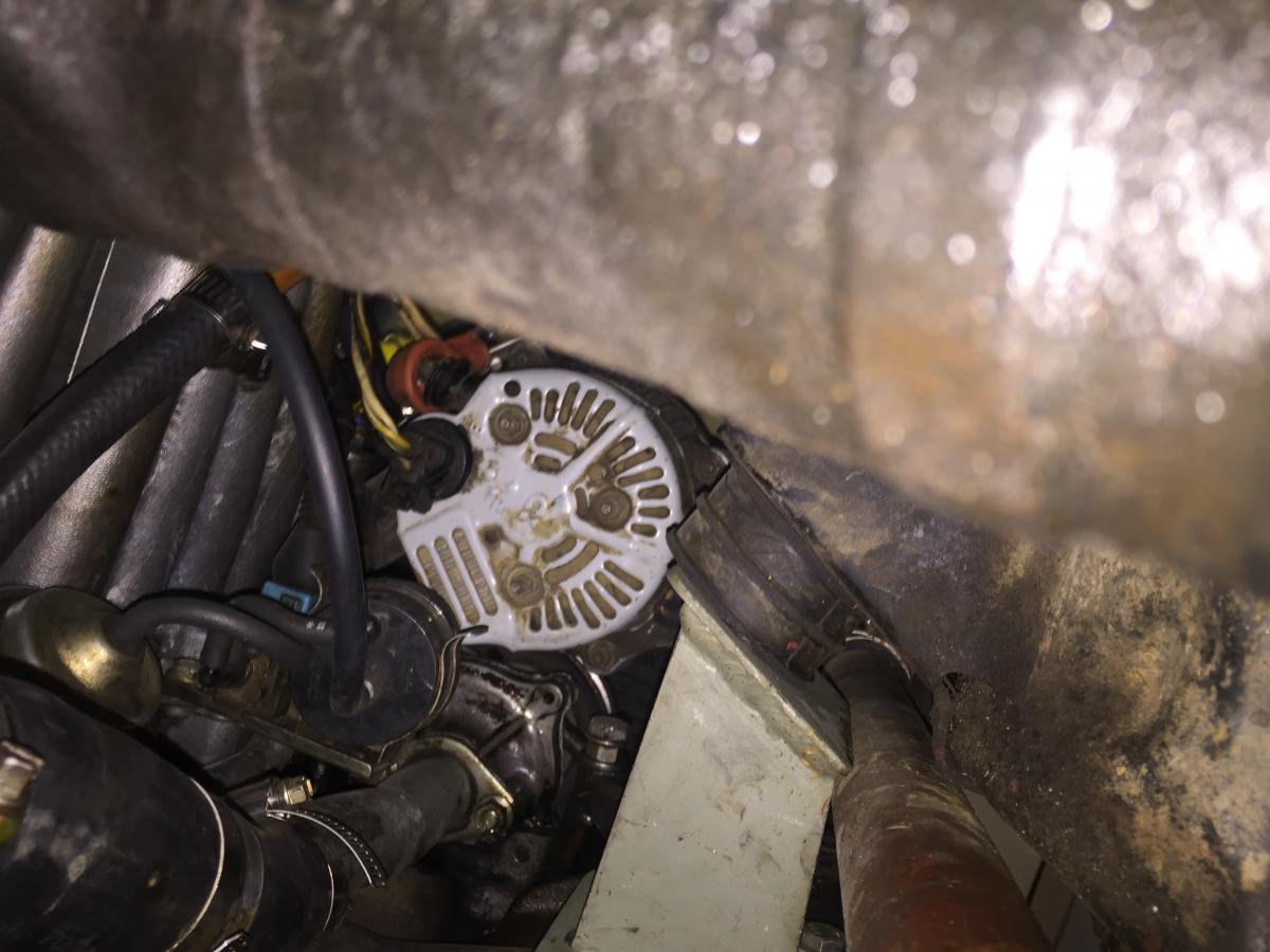

  3. Hey bit confused to as which one my charge light is trying to wire a 4age alternator in ?

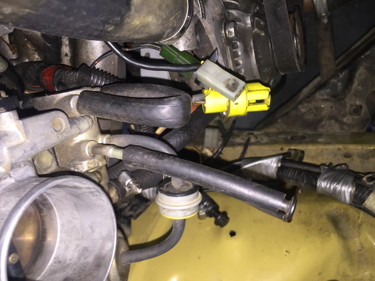

  6. Here's the photos the clear hoes goes to charcoal canister

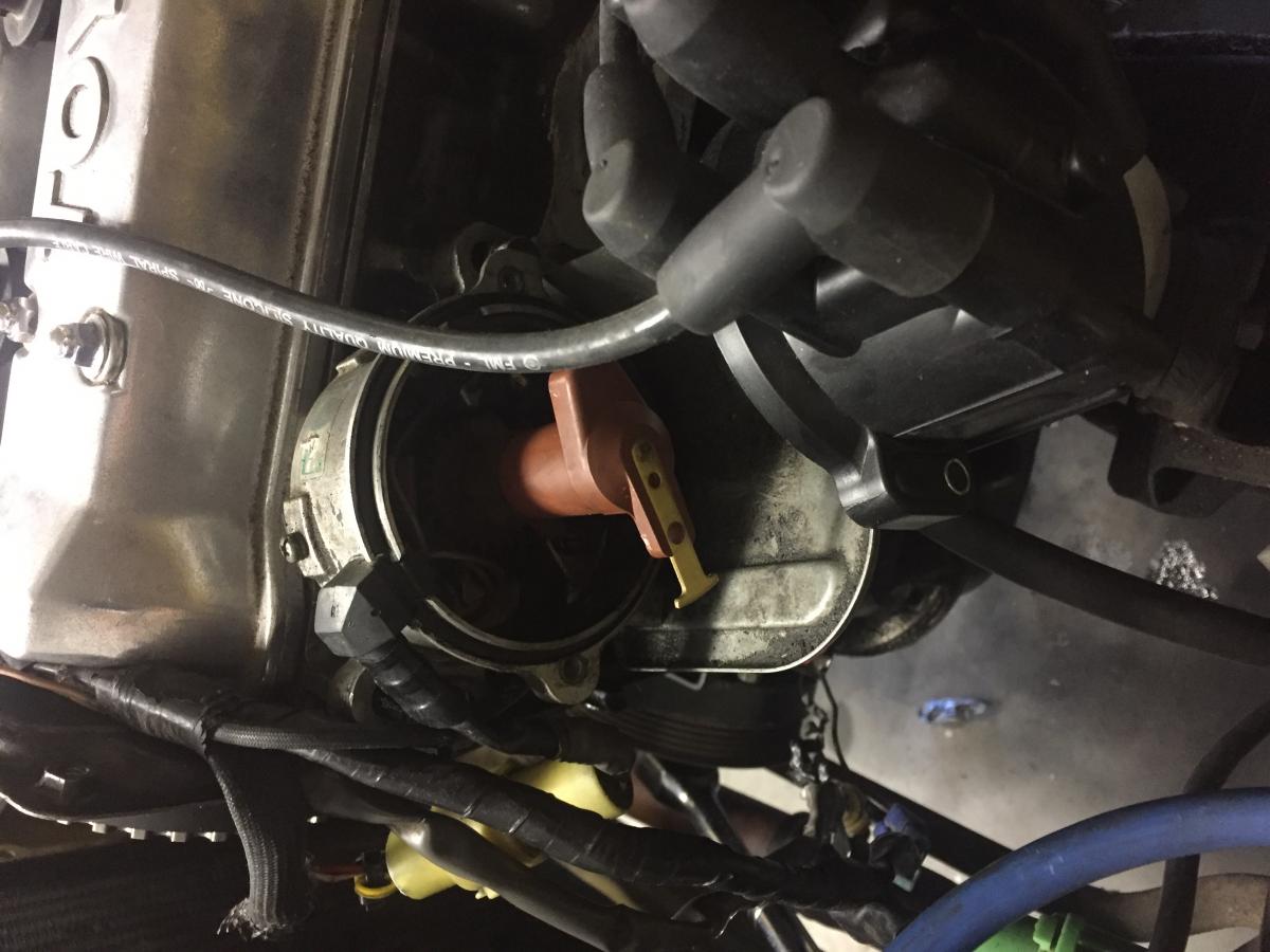

  21. Hey I had my 4age running ruff but running .... And I come back the next day turn it over nothing, foot flat too the floor a little splutter of life. So I check the timing by turning it over its out. Getting it close by hand -5 deg, move the dizzy the slightest and it gone way off the grid. There is uncovered metal on my rotor down the face of it
