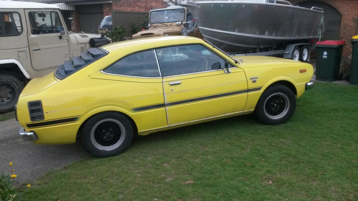

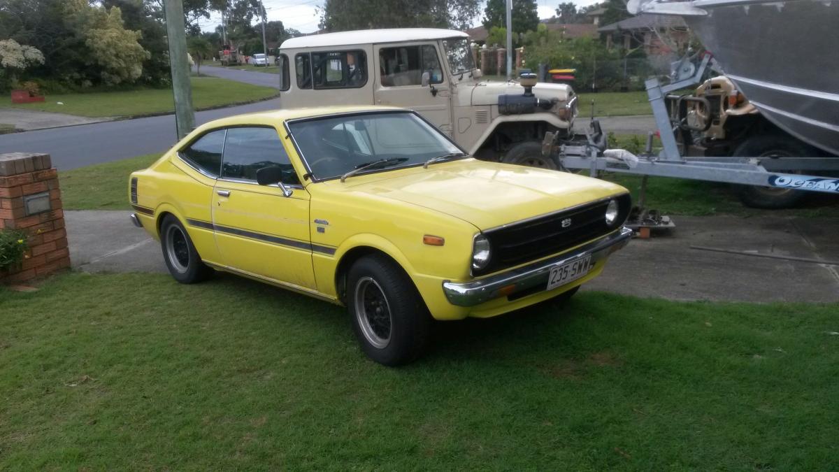

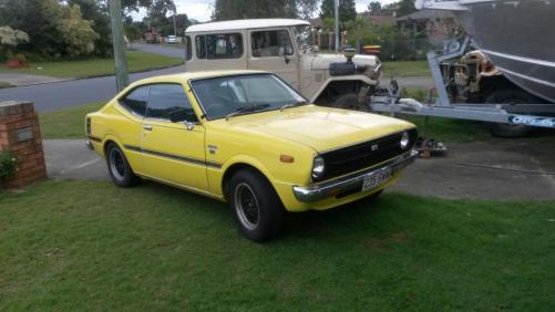

  15. tils101 posted a topic in Rollaclub Rides
    Just picked this old girl up about a week ago. She's only running a 3k with a 5 speed but it purs along and was rebuilt about 50k ago so will do for now. I bought her for a cheap run about as my other vehicle is a fj45 with a 350 and is thursty. Its pretty tidy with still original paint with only a few small rust spots. I only had it a day and a bloke pulled up at the lights next to me and asked me if i wanted to sell it! She does want new struts so if you hear of any.........
