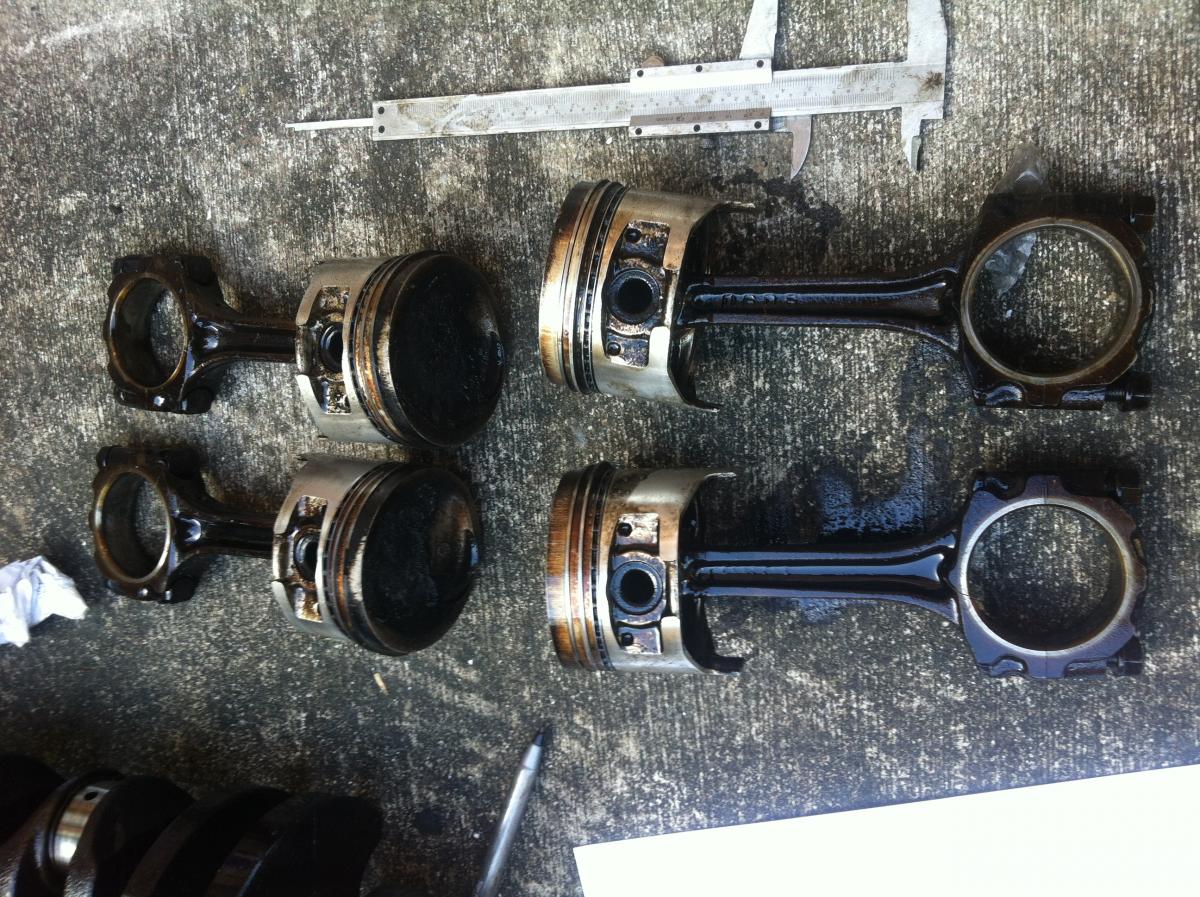

update: have pulled engine block out to dis assemble. so far have found no1 cylinder big end spun, main shaft journal 1 worn. no1 big end journal has considerable amounts of wear... unevenly so aswell. :/ not sure if conrod is out of round but am suspecting so. even though it looks good. some pics: pistons look alright, just a bit dirty no1 conrod and finally one of the big ends that hadn't spun.... still a bit sad

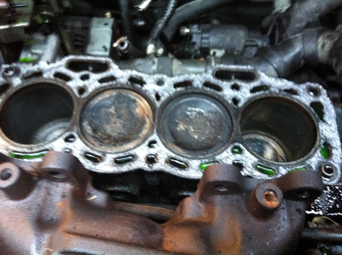

jumped on the pc to upload these photo's of the beast. And the donk with the head off you can see the bores are quite nice considering the punishment it has received.
