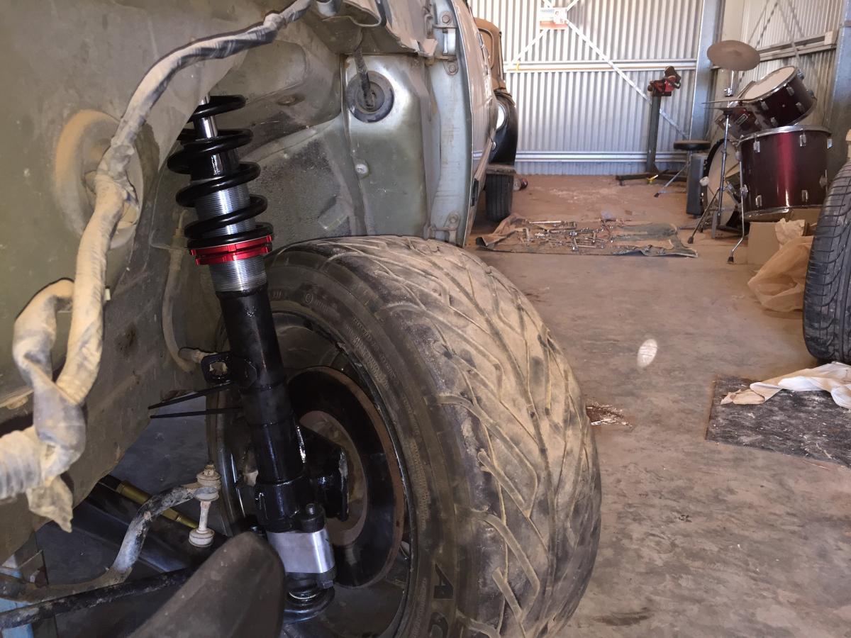

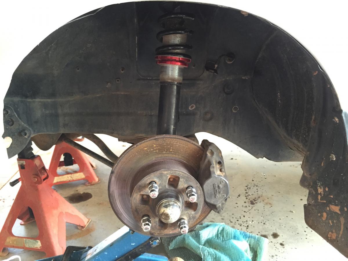

  1. Well today I put the coilovers out of my drift car into this seems I'm upgrading, they are xt130 struts with 8kg hsd coilover sleeve kit with helper springs that I welded on, kyb AGX shocks with 4 way adjustable dampers, I also have some 50mm ajps RCAs to put on once I lower the rear end and wind it down a bit
  2. Driving the car with all the new parts it's much better, I didn't realise how loose and un responsive the car was before, definitely worth doing seems it only costs a couple hundred dollars to replace the worn out front end!

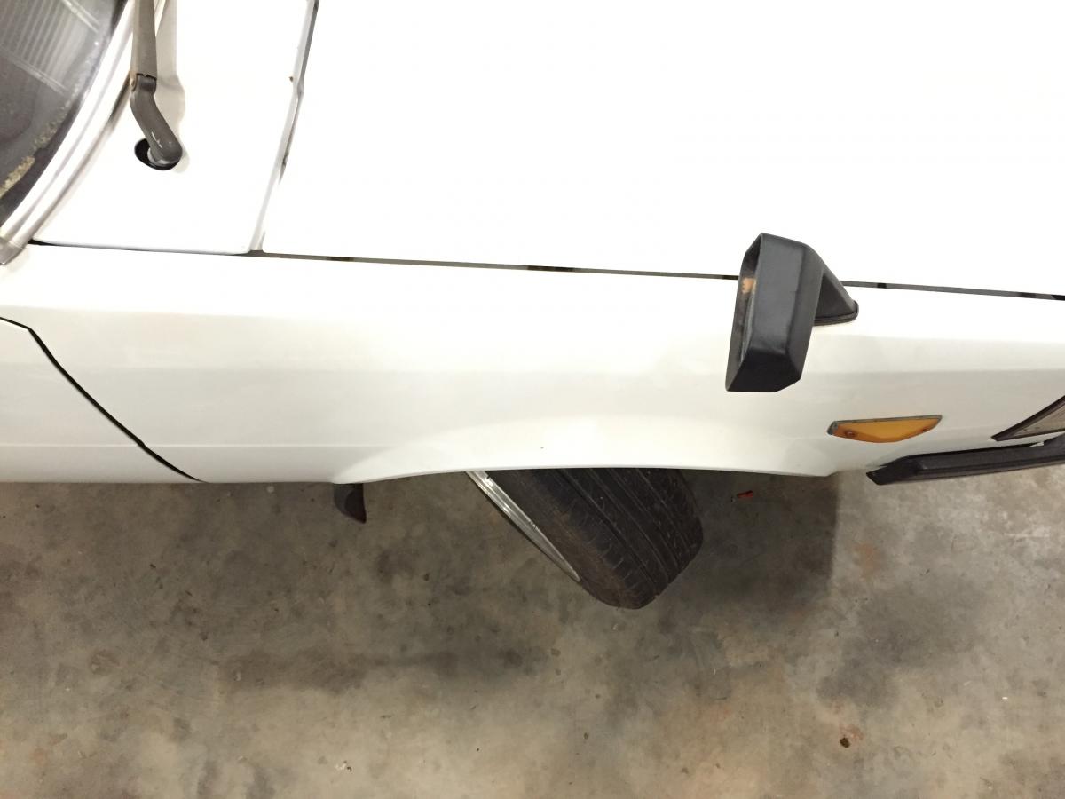

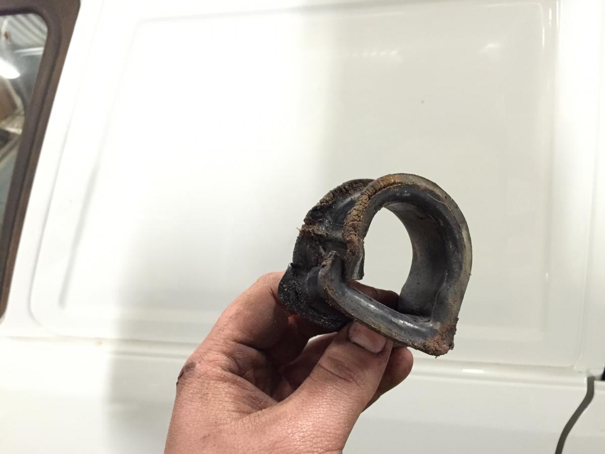

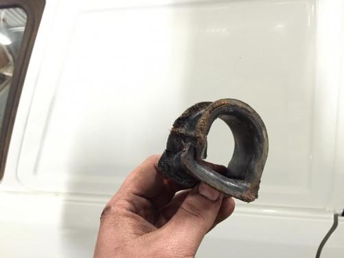

  3. And some pictures, was surprised with how much extra lock the ajps lock spacer gives! Also one of the old rack bush and how worn it was!

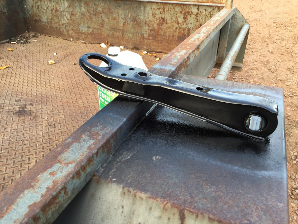

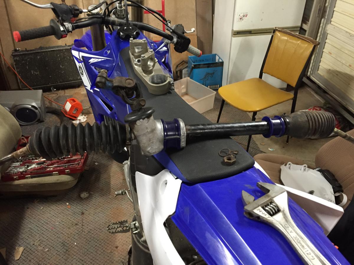

  4. Well it's been a long while since any updates, lost my license for a year because my p plate fell down while on good behaviour, haven't started on turbocharging the 4k yet, but I'm getting my license back tomorrow, and while i was servicing it a few weeks ago getting it ready to go after sitting around for a year, I decided to put in some xt130 lcas I had sitting around that I had from my ae71 drift car, build thread is Ae71 Bt20v. And also whilst I was there I blasted and painted them, put in some ajps rack mount bushes, ajps lock spacer, ajps slim ball joints and superpro lca, castor rod and swaybar link bushes to stiffen up the front, am definitely keen to take it for a drive and see how it all feels with the new bushes! Will post again soon with feedback!

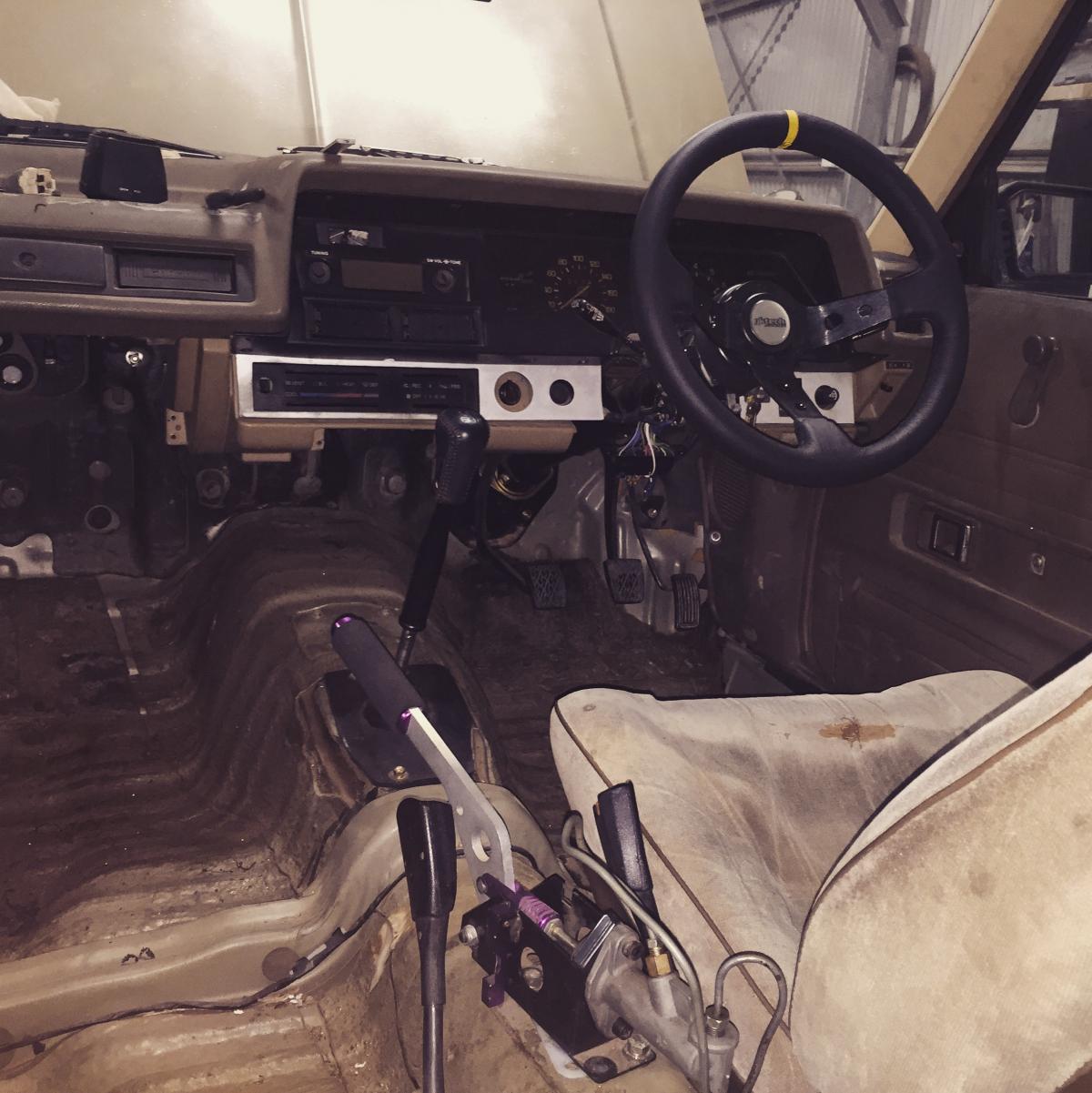

  8. Body is pretty rough, it was an awesome daily but the weldy was annoying, it's an ae71 1984 it's the original colour, I can check the paint code for you

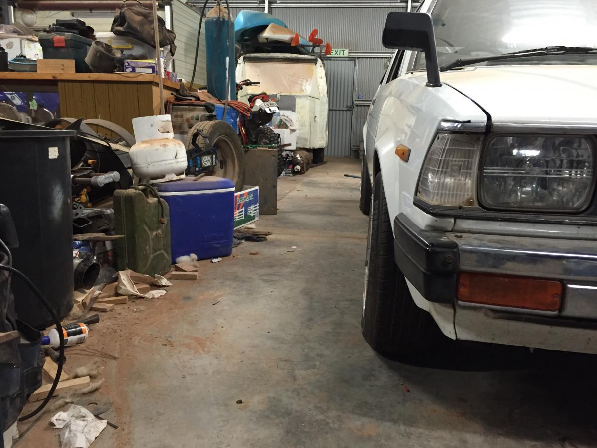

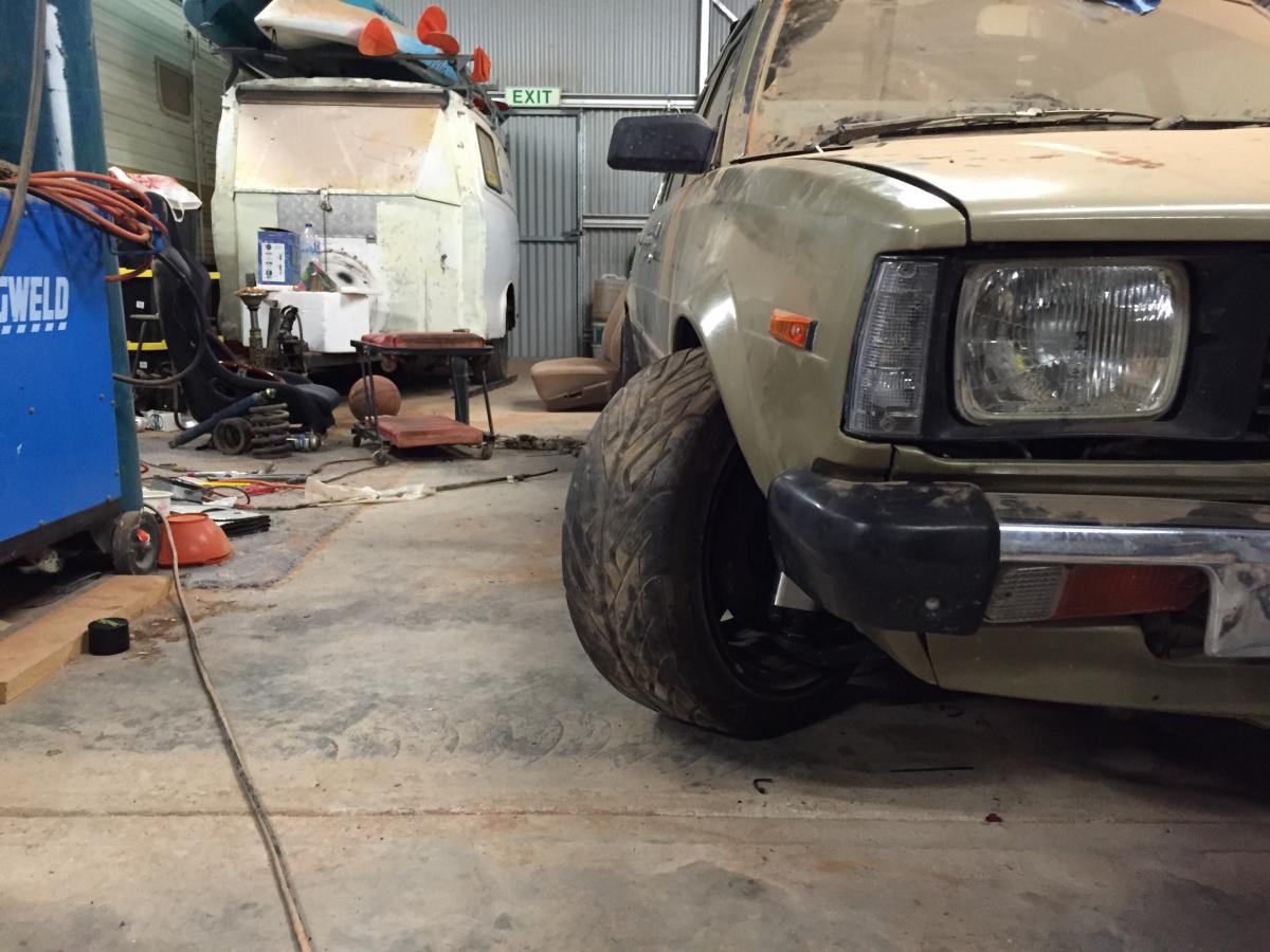

  11. Coilovers and lock shot!
  12. It's not as stiff as people make it out to be I don't think, it all depends on your dampers, with it set to soft it's still firm but not harsh, but on the track it's pretty solid but gives the front end a good feel

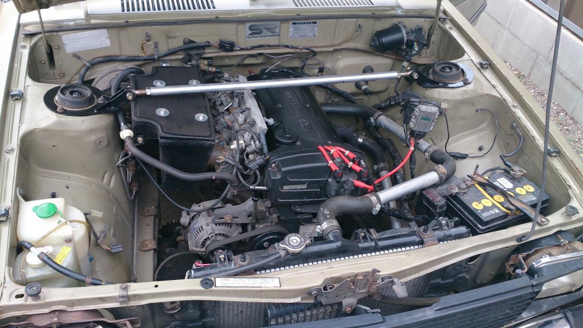

  13. engine bay and ugly interior, suits the ugly colour but I definitely need a decent seat because it was damn hard to hang on while drifting! Haha
