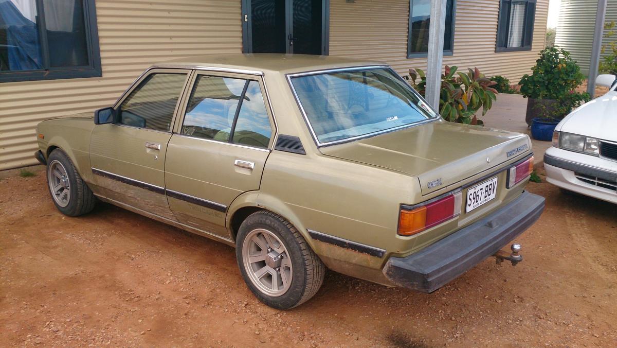

here is my AE71 that I bought running with a blacktop 20v running standard ecu, and running like shit with vacuum leaks and wiring issues, used it as a daily until I lost my license, (p plate fell down on good behaviour 😔 so I decided i would turn it into a drift car because I'll have a lot more fun on the track with it!
Specs on how I got it,
Weldy
Chopped springs front and rear with kyb AGX shocks in the front with xt130 struts brakes and lcas
And using dodgy coolant hoses going to the back of the engine with fwd cooling system
Has a dizzy relocation to the front
That's about all it had from the start!
