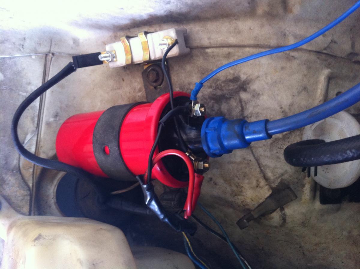

  1. Haven't check the timing so I'll get on that
  2. Without it being hook up the the dizzy I should still be getting spark from my coil lead shouldn't i ??
  3. Brand new coil brand new balas and still no spark from coil lead
  4. My points are set 0.45mm from the biggest edge of the rotor button shaft
  5. I've unhooked the dizzy to the coil all together I tried to get spark just from the coil and still nothing
  6. Just hook up the multimeter and I'm getting 12.3v so I'm getting full power I haven't replaced the condenser yet it the dizzy I'll go to the shops now and get a new one
  7. So the the little red one goes to the +ve a swell, Last night I tyred to see if I was getting spark agian and I was this time just a tiny little one think it's lacking power
  8. I think the red thicker wire is my igintion wire not sure on the black one or the black and white one
  9. That blue wire is the wire that runs to the dizzy
  10. This is how it's hooked up those 3 wires were just flopping around !!
  11. This is how it's hooked up those 3 wires were just flopping around !!
  12. I am now getting power to the coil !! But as soon as I connect the dizzy wire to the coil it stops the power out put from the coil ??? Why is this
  13. I am now getting power to the coil !! But as soon as I connect the dizzy wire to the coil it stops the power out put from the coil ??? Why is this
  14. I had a mate check it over last night he said that the fuel shutoff is fine and he thinks the dizzy is buggered ! But yea is the a diagram to how the coil should be wired up ??
