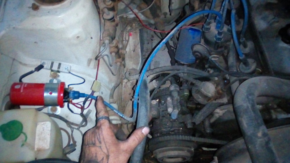

We'll today I brought new point and still nothing I replaced the coil agian still nothing but this time I'm not getting spark from the coil ???
And the power wire from the coil to the dizzy melted so I have tried anything else yet don't wanna start a fire lol
Anyone know a solution ??
This suggests you had the coil wired incorrectly. The main 12v from the ignition was on the -ve terminal and shorted the ignition power to earth through the points. Otherwise the coil resistance would stop that wire melting.

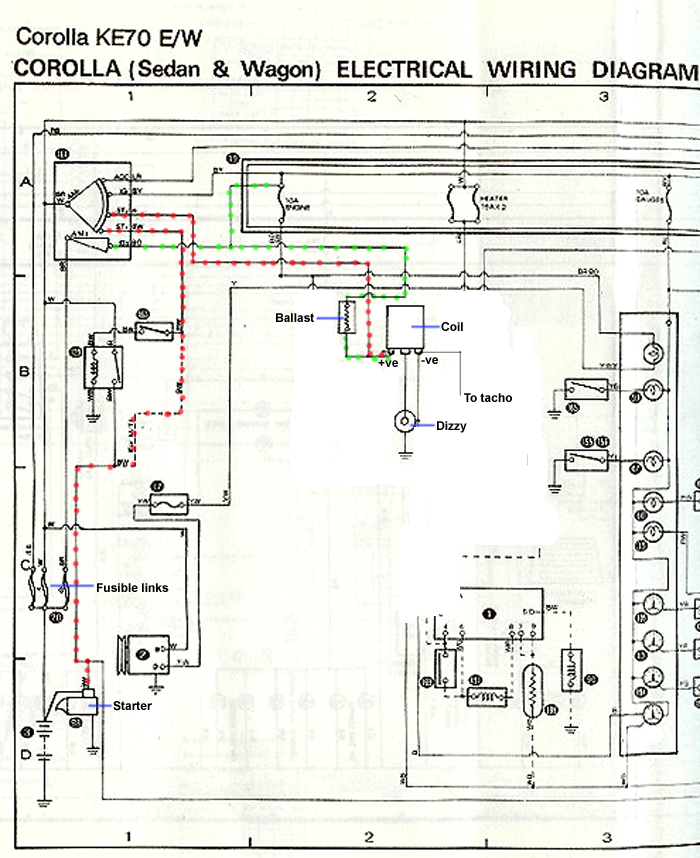

Check the ignition wiring out and see what happens. If the ballast resistor is broken (you can check it with a multi-meter) the car won't start as you crank it, but will suddenly fire just as you let the key go.
Is the fuel shutoff solenid OK??
On here you can see the green circuit that runs the car once started, and the red circuits that start it. Both feed from the key and join at the coil +ve to run the ignition, but the 'run' circuit goes through the ballast resistor to drop the voltage for the 9V coil.
The 'start' circuit cuts the resistor out so when you're cranking the 9V coil can work well on the battery supply while the starter motor drags 300amps out and drops the voltage to 8volts or so. When you let the key go the resistor drops the voltage from 12V to 9V for running.
The coil +ve should have a wire from the key plus a wire from the ballast resistor. On mine the ignition key wire is red and there is also a small capacitor on there to cut down radio interference. The wire from the ballast to the coil +ve is black.
The coil negative has one wire going to the dizzy and one going back into the loomb to the tacho, both black.
