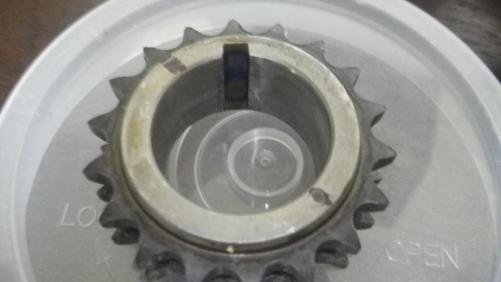

Thanks for that. That's what I'm going to do. I can't see any other way it can go.. :) I'll take a photo of the flames if it all goes wrong. A couple of hours later....... Something which has given me a surge of confidence in my alignment strategy is the timing mark on the crankshaft pulley. When the keyway on the crankshaft is in the position mentioned above, the TDC timing mark on the inside of the crankshaft pulley is at 0 exactly (which is where it should be) The marks on the pulleys also align when at this position. I'm very pleased. I was thinking earlier that this double chain in my KE70 is not the original which is why I may have some differences in the standard way it is set. It could also be the difference between genuine Toyota parts and generic parts made by other companies. The ultimate test will be when I turn the key (once put back together) though I'm pretty confident things are right.

Thanks, but that's really the point. I have the compression stroke and place a small screwdriver in the number 1 spark plug hole (on the compression stroke). I turn the crankshaft and it reaches it's peak (the top) at around 5 degrees to the right of where the keyway on the crankshaft is vertical. If I move it to vertical, it's not possible to align the dots on the camshaft and crankshaft because the keyway is too close the the dot 120 degrees clockwise from the keyway (on the crankshaft) and I'm not at top dead centre. So, I suppose I'm asking, is it safe, as long as I have found top dead centre, on the compression stroke, to align the dots between the sprockets (the red line on my previous diagram). The end result will look like this: (see photo). My top dead center definitely isn't when the keyway is vertical and the positioning of the dot from the keyway slot in my crankshaft sprocket is testament to this. If the dot on the crankshaft was a little further around in a clockwise direction they a vertical keyway would also align the dots. Because it is not it is not possible to have a vertical keyway and aligned dots.

Thanks for the tips but unfortunately I'm in Melbourne in my unit car-park. haha. Haven't pulled the engine out or anything like that and won't be pulling out the cam unfortunately. I can adjust the camshaft and crankshaft to align but do to the offset of the notch (dot) on the crankshaft sprocket not being able to align with the camshaft dot, I noticed on a second check that the keyway on the crankshaft is about 5 degrees right of vertical when the number one cylinder is at top dead centre. Why would this be? I thought the keyway would be vertical at top dead centre? If I turn it until I get top dead centre, then everything lines up (but the keyway on the crankshaft will not be vertical, it will be right of vertical by abour 5 degrees). Thanks

Coil, fuel pump, ballast resistor replaced. And the leads.. I'm part way through the timing chain and I'm having a few issues. It's easy to get in there and coparing the new chain with the old, the old chain is a little bit longer but not by much. When I put the new chain in,it's allot tighter but the alignment is something I'm having trouble with. Here it goes. I'm using a Gregories manual. One thing I forgot to mention is that this is a 1983 Toyota Corolla KE70 'S' High Cam. I don't know if High Cam makes a difference in what I'm doing as I don't even know what it means. Anyway.. the gregories shows that the crankshaft keyway needs to be vertical so I can align everything up. When the keyway is vertical the number 1 cylinder is at top dead centre. There is a small notch about 120 degrees to the right of the right of the notch. At this cog, the bright link on the timing chain goes over this point. Unfortunately this notch on the small cog (camshaft sprocket) cannot be placed in a position to cut a centre line (the big red line) through the two cogs and align with the notch on the far side of the camshaft sprocket (large sprocket). I'm probably getting things confused. Should the center line cut the crankshaft sprocket in half? I think the big question is this. Should this be set up so the dot on the camshaft sprocket and cranshaft sprocket meet in the centre? I notice that this is how some timing chains are installed? Photo's below.
