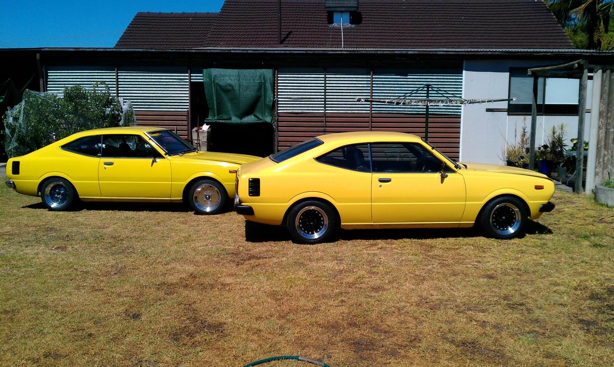

  11. Got all the exterior apart from ariel done and started on my coilovers today.

  13. Cheers, I love the nardi, it had a black leather one in the car when I first got it but the leather is stuffed. Hope to have the front bar, bonnet chrome and windscreen wipers back on today and that will be the exterior done.
