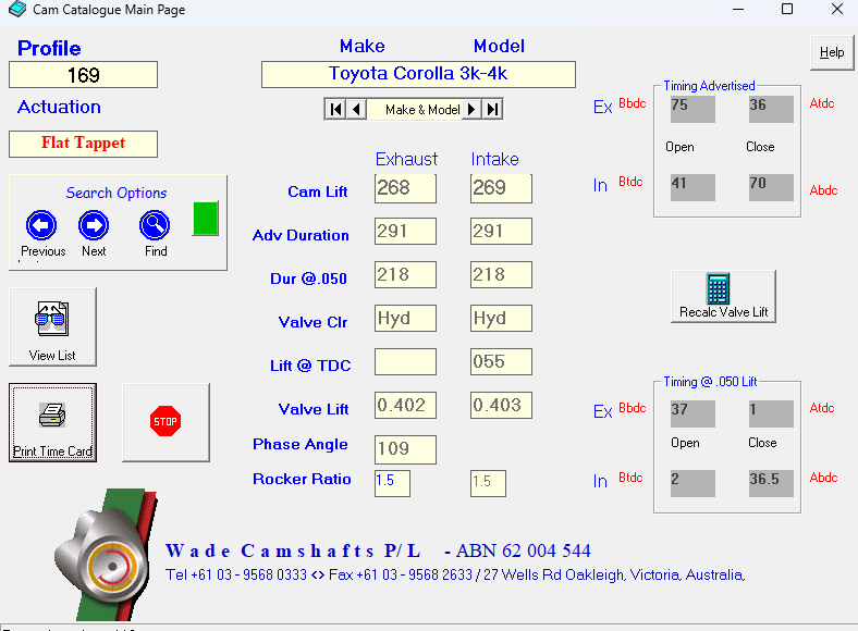

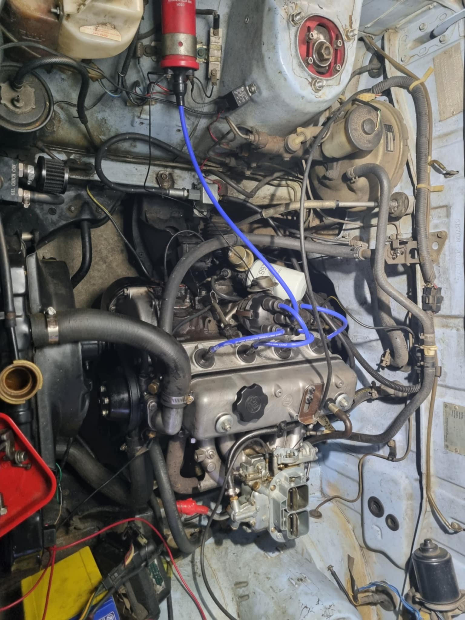

  3. As an update from todays troubleshooting, I've played around with the clutch firewall adjustment with no improvement to the sound, even putting the clutch in and out doesnt seem to make a difference. 5k has hydraulic lifters. I installed it myself and checked it with a dial gauge at 50thou lift and a printed angle gauge on the crank. If i run out of things to troubleshoot I'll pull the motor again and recheck the timing. wade specs are attached. I'm running 98. Will put some fresh fuel in just to rule that out as well. I was using a timing light previously while doing up hill pulls to try sort out the knock, by changing the timing i can either get it to knock under no load but high rpm (neutral throttle blips, or under load at low rpm but the car drives like a dog. The cars not registered atm so not driving anywhere any time soon. Bit of a project for me to learn more. I've cleaned and rebuilt the dizzy and redone the gap and now the car wont idle. I can get it going with some difficulty and throttle input. I'll clean the carb out as suggested to rule out clogged jets. Altezzaclub, I've been reading through your posts about the 5k dizzy regraph and thought maybe the stock 4k points dizzy weights may be causing issues? Not sure how to go about debugging that hypothesis. Thanks for your advice guys.

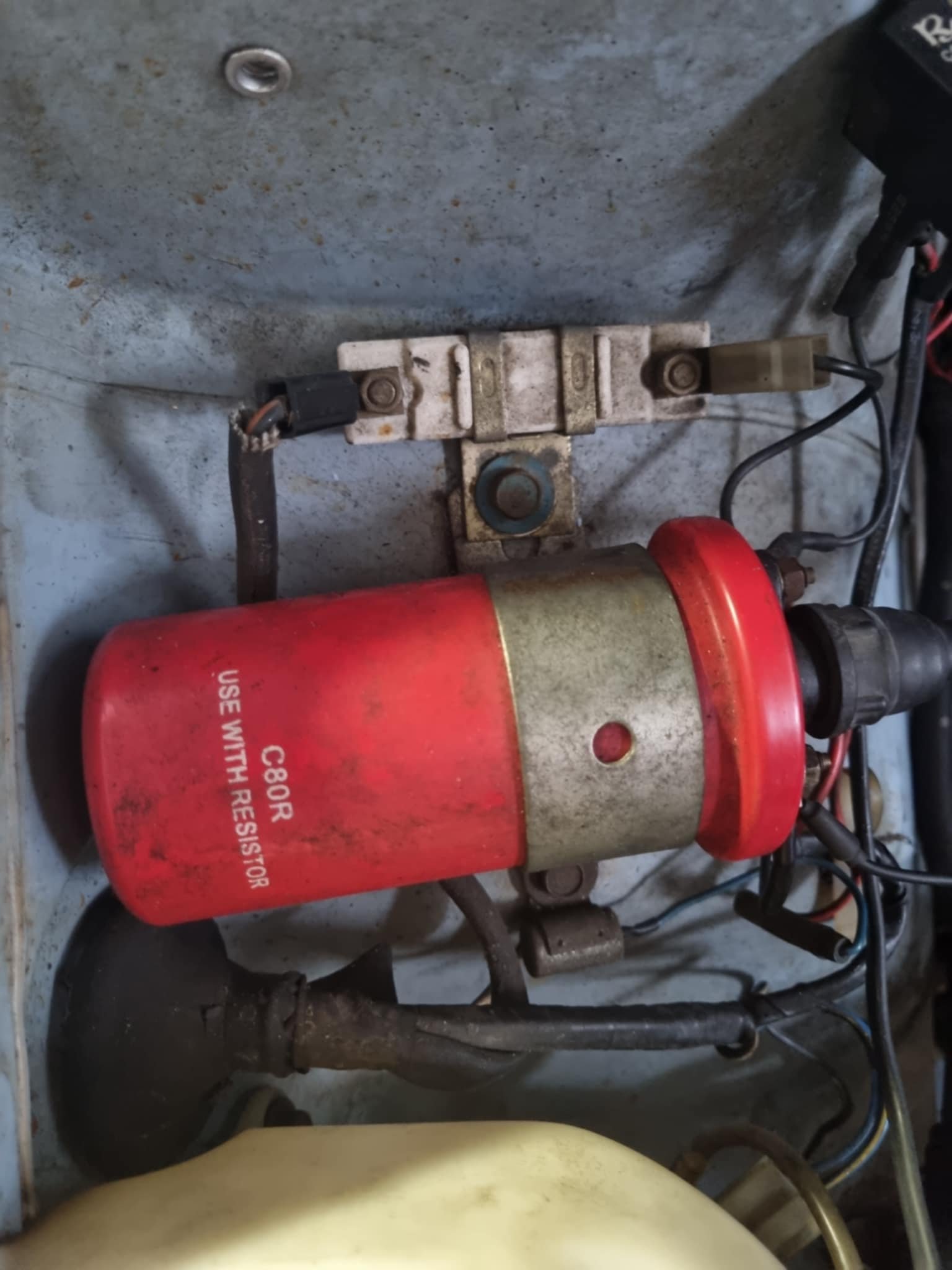

  5. Hi all, I've been struggling trying to get my 5k running correctly for a while and would appreciate some advice. I've recently installed a wade 169 cam into my 5k and can't seem to get it running correctly. Mods: Wade 169 cam, extractors, webber 32/36 carb. Ignition: C80R coil, stock bosch points dizzy (0.45mm gap), new eagle leads, NGKplugs, Issues: Doesnt want to idle properly and makes a horrible whirring noise. Also when it does run it seems to knock at high RPM. Any suggestions into what I should look into to troubleshoot the issues would be much appreciated. Whirring Sound: https://drive.google.com/file/d/1GeIgvdsU2ebQhsbAUGJ56IygNT9gBmK3/view?usp=drive_link Cheers
