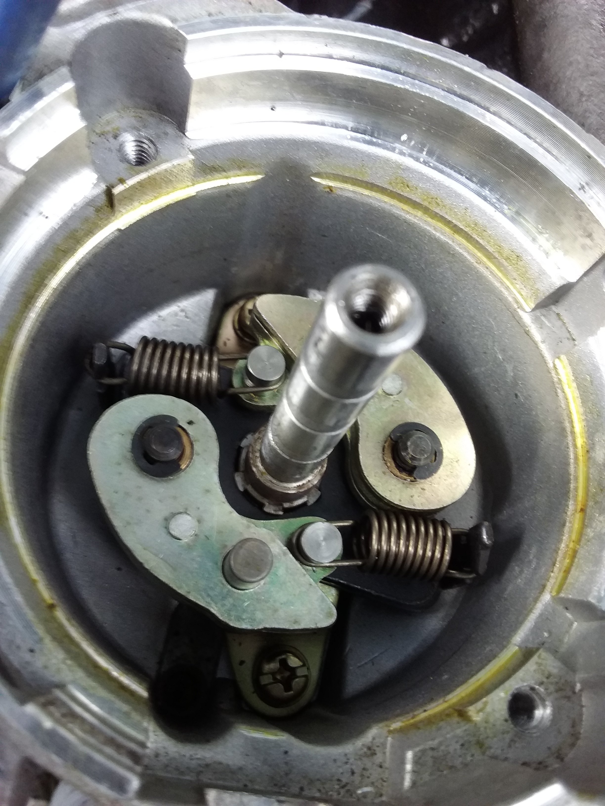

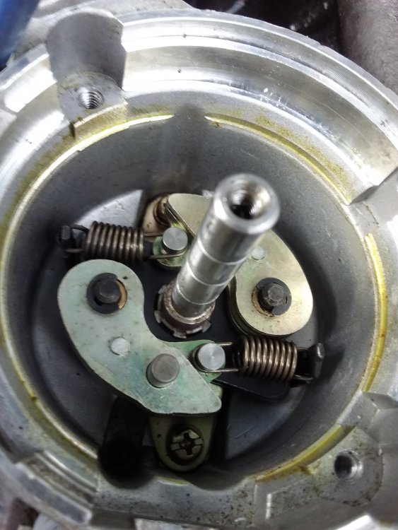

  9. I tried the new springs and the marker on the pulley keeps rotating towards 0° when i rev the motor but it feels a little better than what it was, should i still have vacuum advance line hooked up or not?
  10. Cheers for that mate i have installed the original bosch springs on it for a experiment to see what results i get

  14. These weights must be really heavy then because i get no advance at all

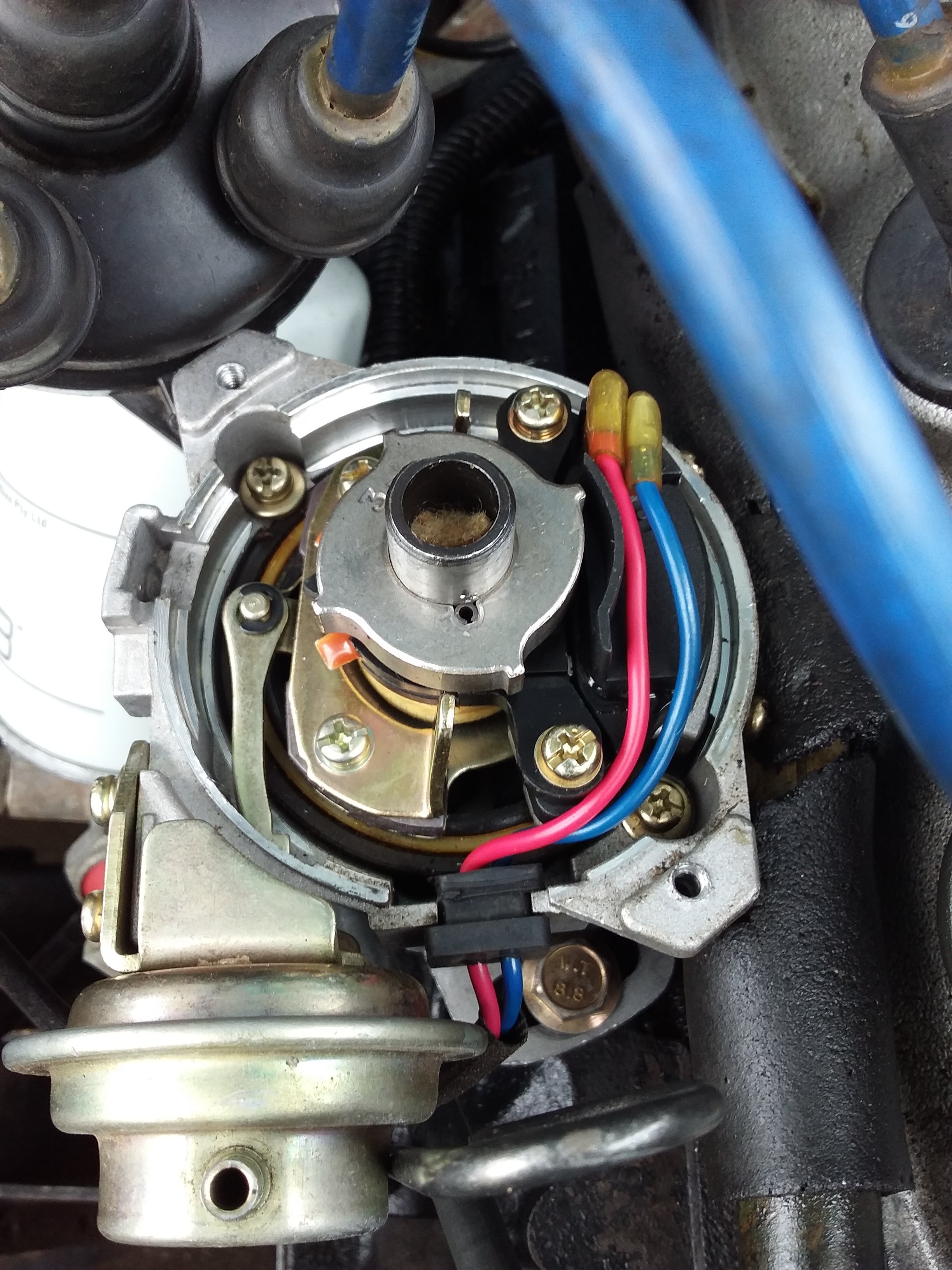

  15. Really appreciate your information mate but i have one of these eBay electronic distributors.
  16. Yes i have it hooked up to the inlet manifold
  17. Hi i have a ke70 with a 4kc and i have installed a electronic distributor and a Weber 45 DCOE. When i hook up my timing light i noticed i have no vacuum advance at all, when i increase or rev the motor the crank pulley mark goes towards 0° instead of advancing. Can anyone help me?
