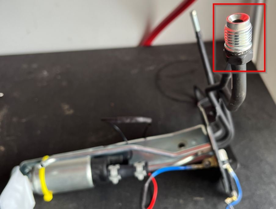

  3. Hi guys, Looking for some advice on how to connect an AE86 fuel pump to the hard lines in my AE71? I purchased a stock fuel AE86 fuel pump and can't work out what adapters/fittings I need to connect the sender hard line at the back of the car. I've just purchased a Raceworks Female An-8 To Barb 3/8In... I was then planning on using an adapter to get the hose down the hard line size... I'm not confident this is the best approach though. What have you guys done in the past?
