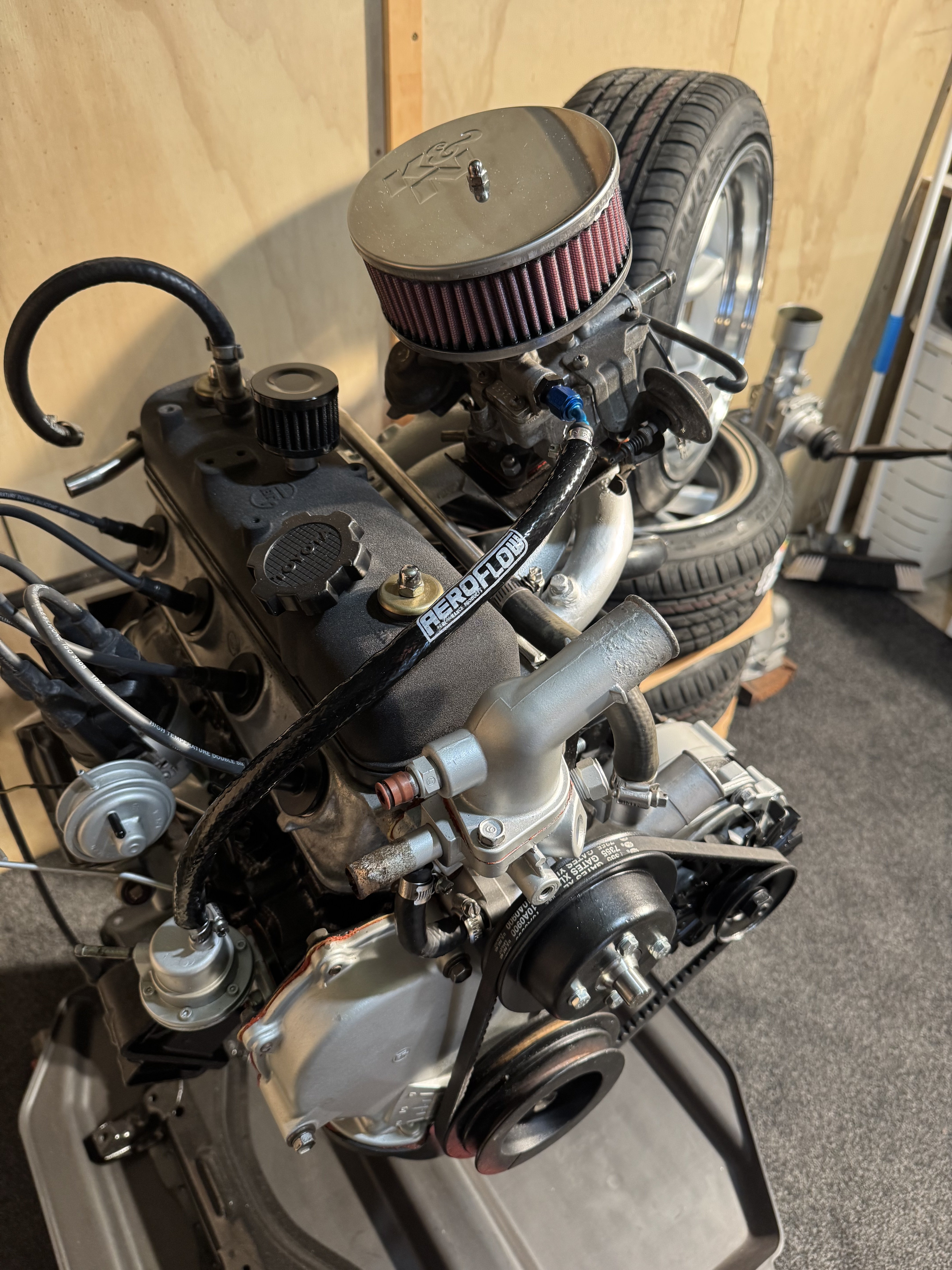

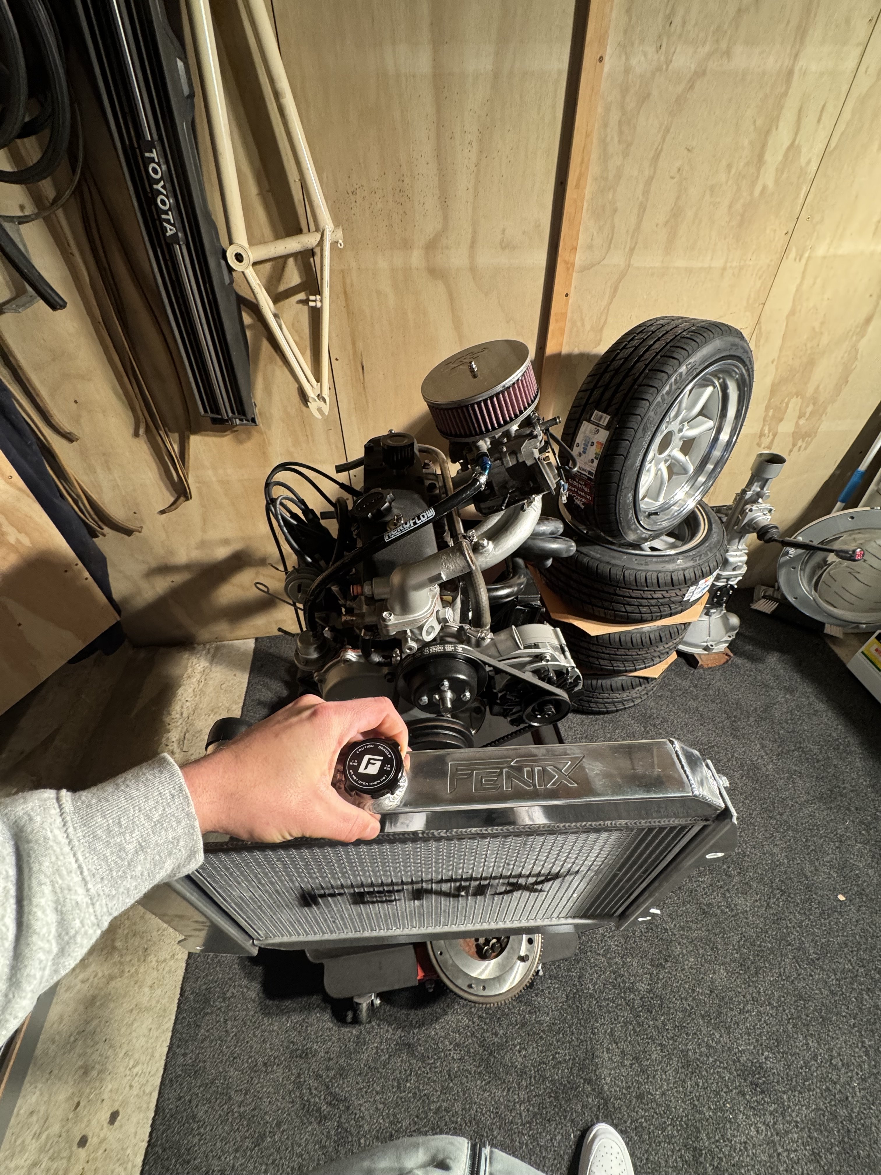

Hey fellas, tezza - to be honest mate that’s probably a little out of my wheelhouse at the moment. This motor I presume will be pulled late next year for an overhaul at a local legends (Charlie b) workshop so I’ll leave that one for him. The thermostat housings have arrived and we’ve got two options. You should be able to make sense on what I’m talking about from photos attached. Option 1: has a temp switch hole tapped in already, but the outlet diam is small than our other option… option 2: tap a hole into the housing with a larger outlet. This outlet will match the rad inlet what do we think about this? I don’t think it’ll make a such difference but in a perfect world I'm thinking tap the bigger outlet cheers fellas, input much appreciated as always -

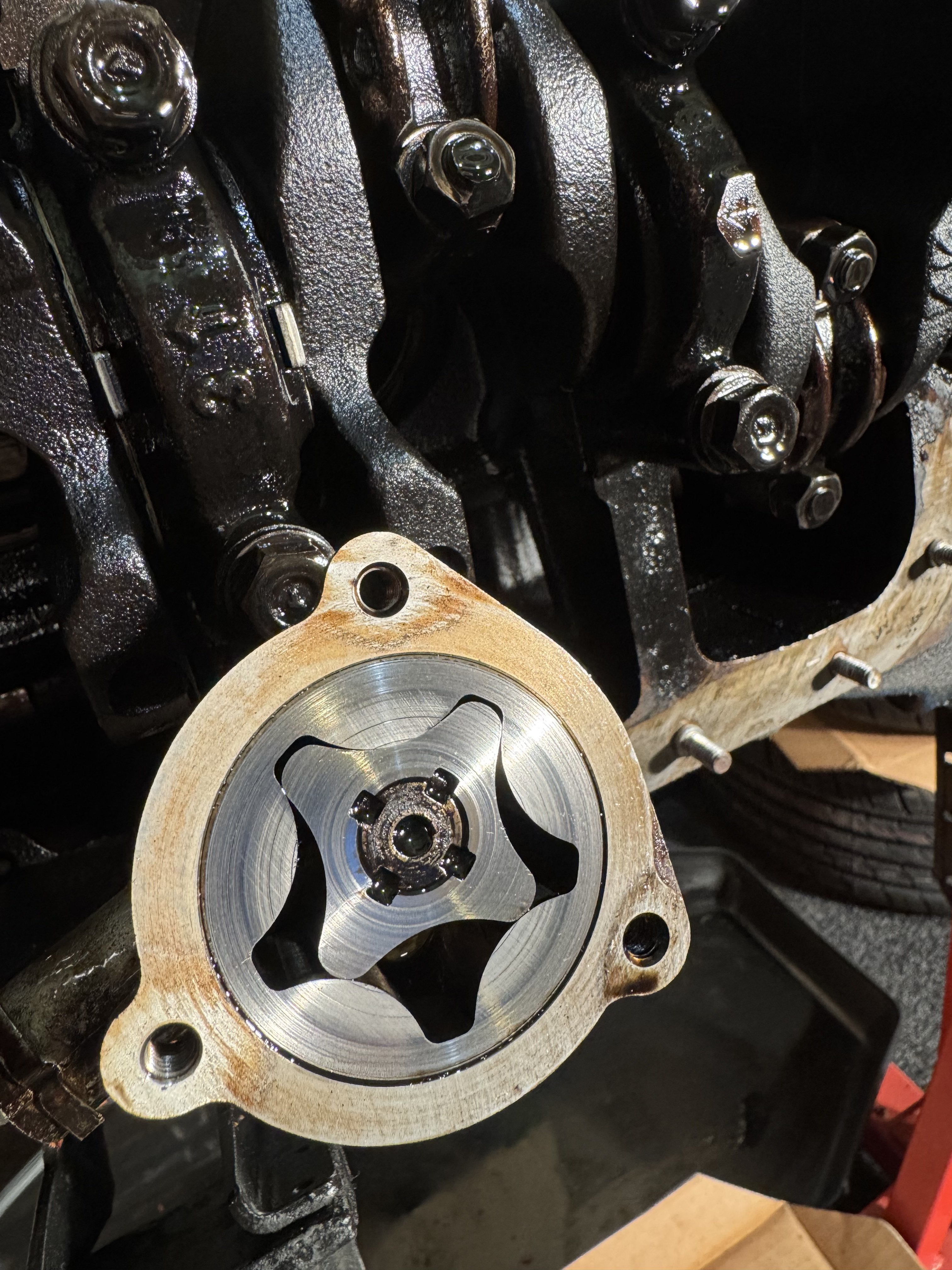

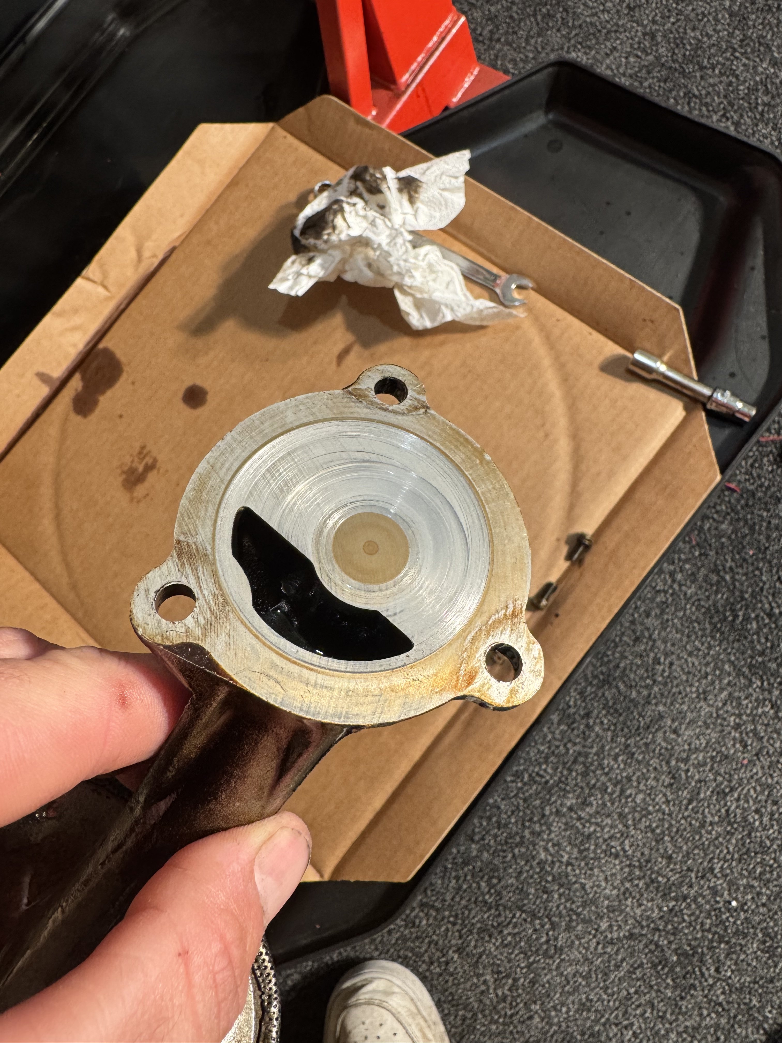

that’s interesting, I just had a wee google and the power numbers are pretty close between the 4ku & 5k ay. Surprising, Makes me wonder why the previous owner choose to go with a 5k head, unless it was skimmed it would’ve dropped compression. Also unsure if it’s got a mild cam in it. Such an unknown motor ahaha. We’ll get some answers once it’s completely stripped down. whipped the base off the oil pump. From a first glance the spout and pump mating surfaces look in good order. Those wear marks you can see don’t catch a fingernail at all. would there be any need to remove the upper housing beyond the pump? -

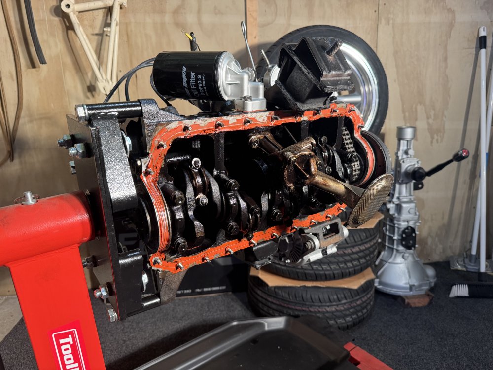

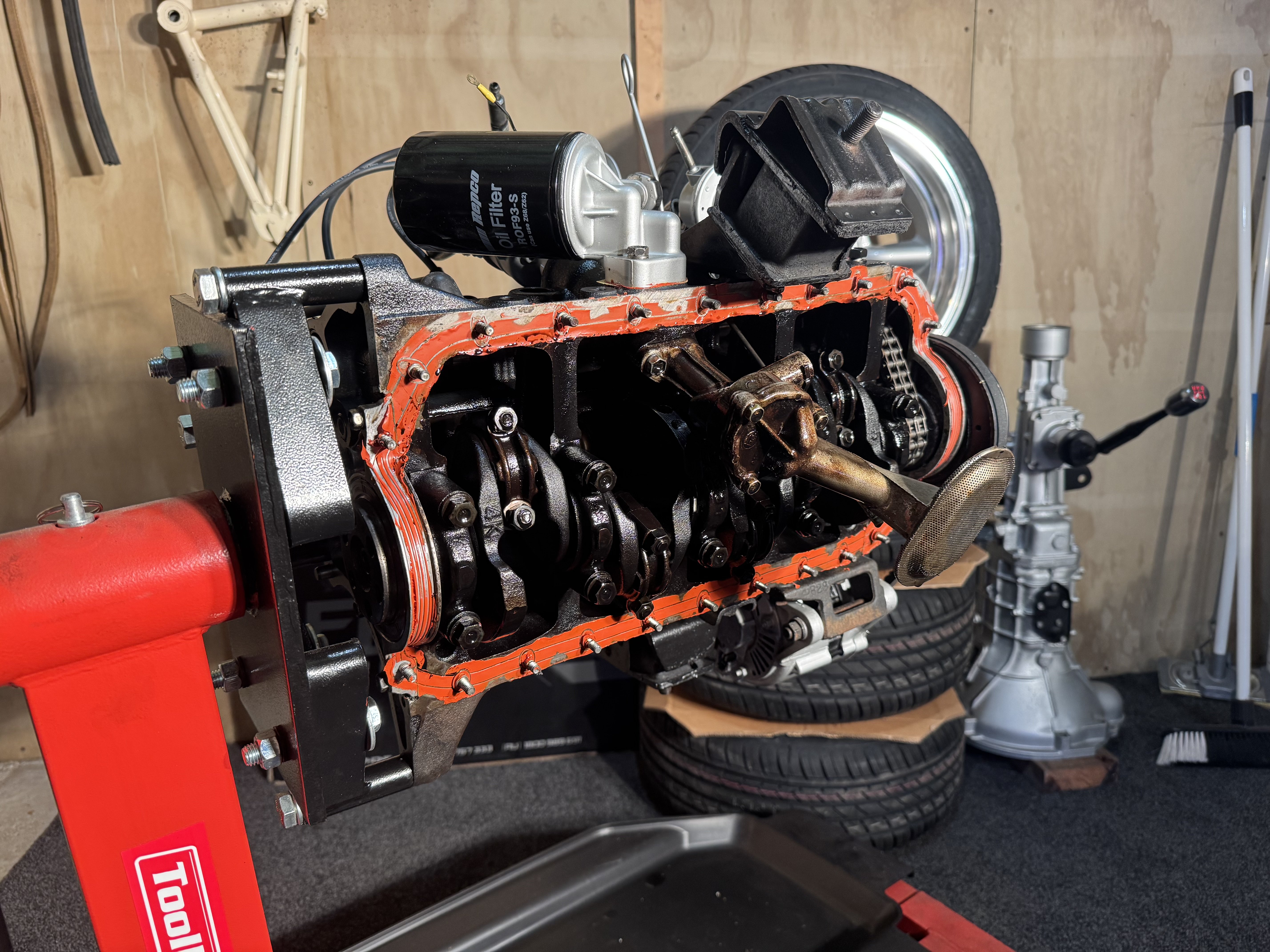

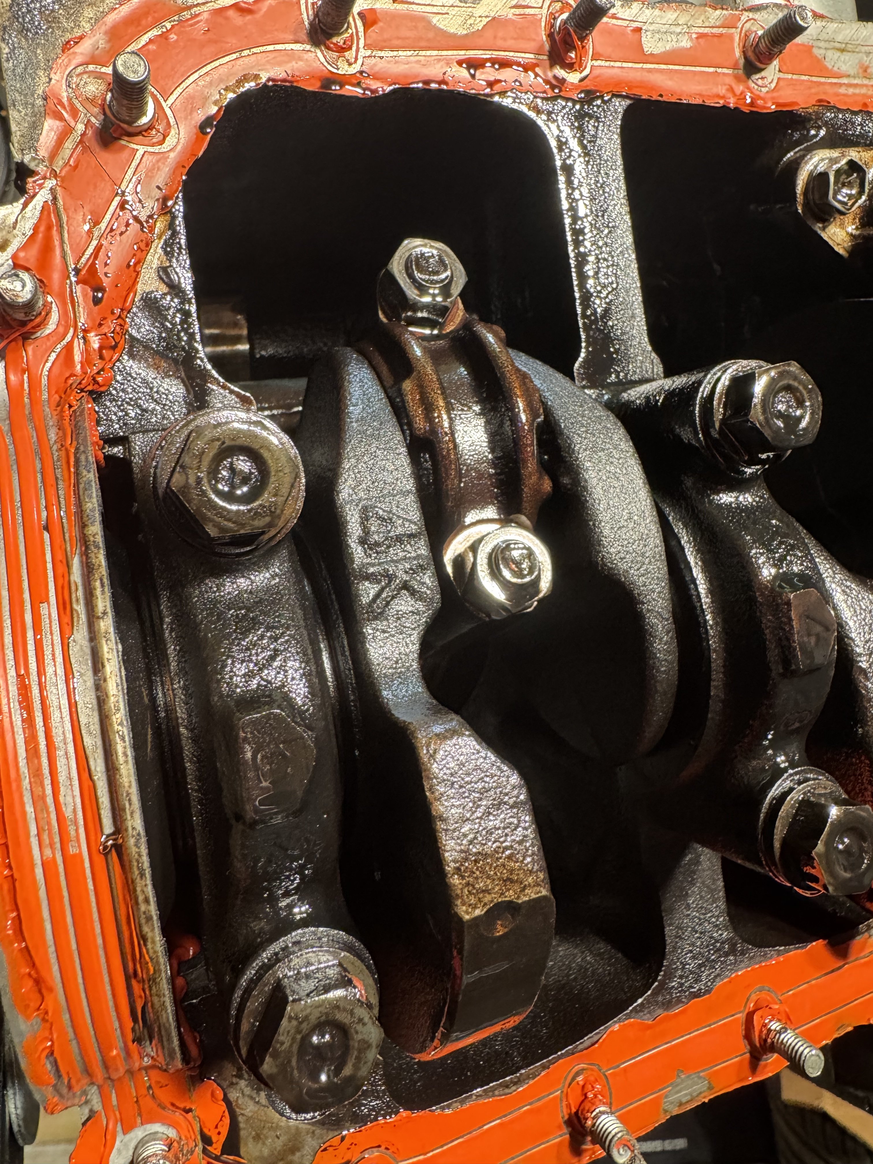

Ahahaha, shit thats a big 5k! well fellas, sump is off, I’ll be on my third sump seal if I can’t get the goop off but that’s okay! Upon taking the sump off I noticed we’ve got a 4k crank… 4k timing cover & dished pistos so all fingers are pointing towards 4K-u correct? Do all k series run a 4k crank? I think I may have read this elsewhere or would they be stamped 2k,3k,4k etc? I’ll also whip those studs out shortly and get some new bolts from blacks. also see attached the photo of the sump where there’s a gap in the threads.. I’m guessing to allow oil to flow out of the lowest point. Somewhere along the line the sump steel has been pushed up into this gap. I’ve been looking at Aeroflow fittings and the plan is to loose the entire old bung set up and weld the new one on the exterior flush so we get a good flow out when doing oil changes thats all for now, touch base soon. cheers fellas -

bloody magic, I’ll get onto that tomorrow. Fingers crossed it should be laid to rest on the subframe and back in the bay in 6 weeks ish for a run up. this arvo I hit another wee bump in the road. I hadn’t really noticed it when dropping the oil pre pulling the motor as I bought the car a few weeks prior… A combination of an uneven sump-to-plug surface & a couple dicey threads led to a leaky plug this arvo when filling with penrite. Option 1: We rip the sump off again and have a new female fitting welded on and plug fitted. Will have to get a new seal and razor the gasket maker off. Bloody faffs. Option 2: I try and find an 18m ID rubber flat washer that can deal with oil and high temp and try that first. The plug does tighten well in the sump threads, just feels a little wobbly on the way in but I’m guessing that’s to be expected with a 1.5mm thread pitch? Sump plug size is 18x1.5 Not the end of the world and if welding a new fitting in has to be the way forward we’ll come out the other side better for it. Just a bloooody faff -

Hey fellas, tezza - A twin cam 4k?! The f*ck. Some people are too smart ahaha! They’re bloody epic cars, this is my 5th one. All the ones I’ve had in the past have been built by others. Good to go ham on this one myself (and try to do things properly hahah) What do we think about a beams 3sge swap? Banjo - your efforts are outstanding! It’s such bastard ay. However on a positive note I tracked one down in just over 24 hours and it on its way hahah. Pic attached. Hopefully this does the trick I just need to have a fiddle with temp gauge sensors, I also need a port for the fan switch, may need to run a twin T fitting if there’s only one tapped port on the bottom of the housing. shes pretty ugly but a good scrub up with some scotch bright and she’ll be brand new haha ill touch base when she arrives felllars, cheers -

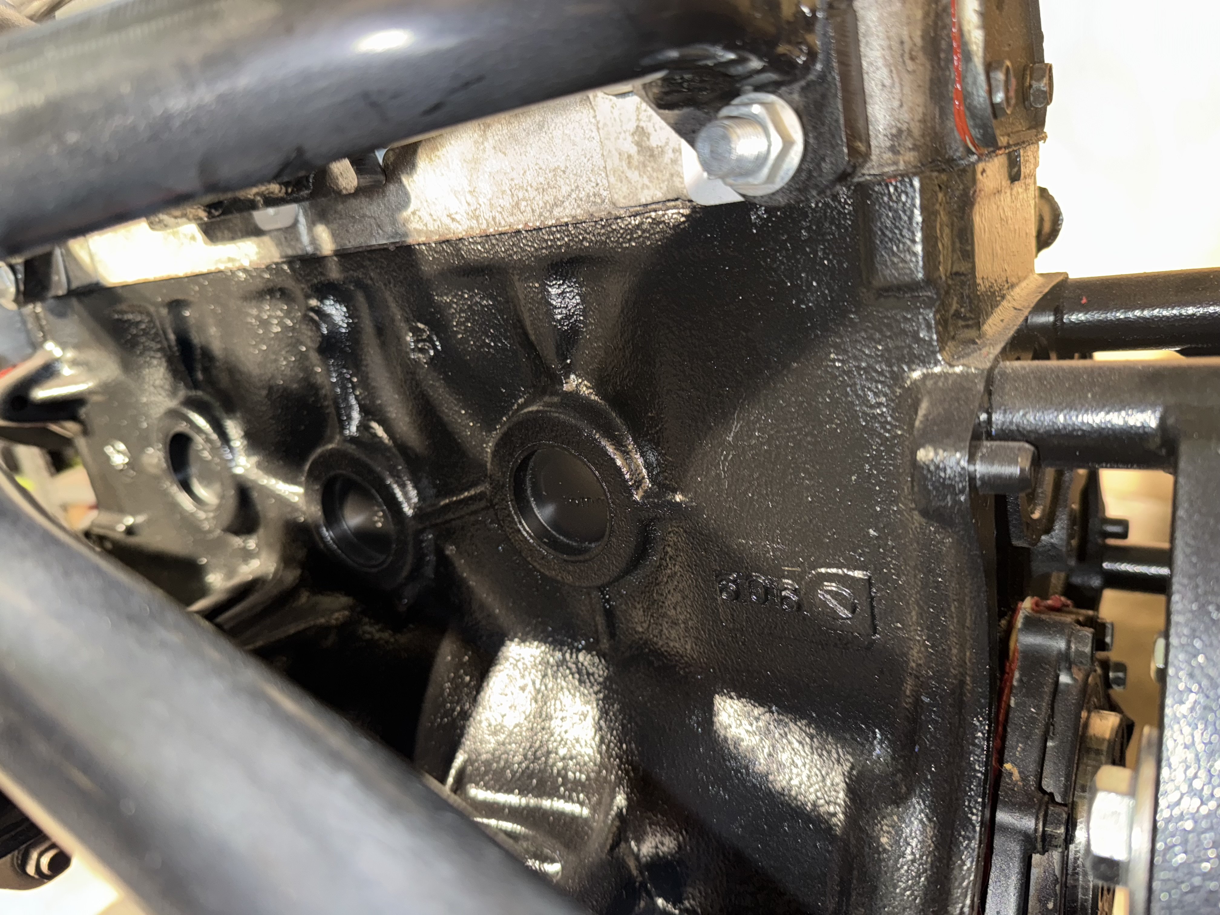

I can confirm I have had this motor running and it goes like a cut cat. I haven’t had it running since I swapped out the single row chain to the double row. I think both you guys weighed in on this. I couldn’t get the locator dowel to line up and had to roll the crank back like a tooth to get it all on. The other finiky thing with this motor is its had the eg. 4k - ***** stamped on the block ground off hahah. are there any other ways of identifying the block? It goes way harder than any 4K I’ve owned, which makes me think it could be 5k. Although the rumour down the grape vine of previous owners say 4k-u block 5k head. I think I’ve found a ke70 thermo housing that should have us sorted to shoot water the other way. Thanks for your input fellas, both of you banjo & altezza always blow me away with your responses. I hope these forums pay you haha!! I’ve added photos of various angles of the motor for you guys to geek out on if you can figure if it’s 5/4k -

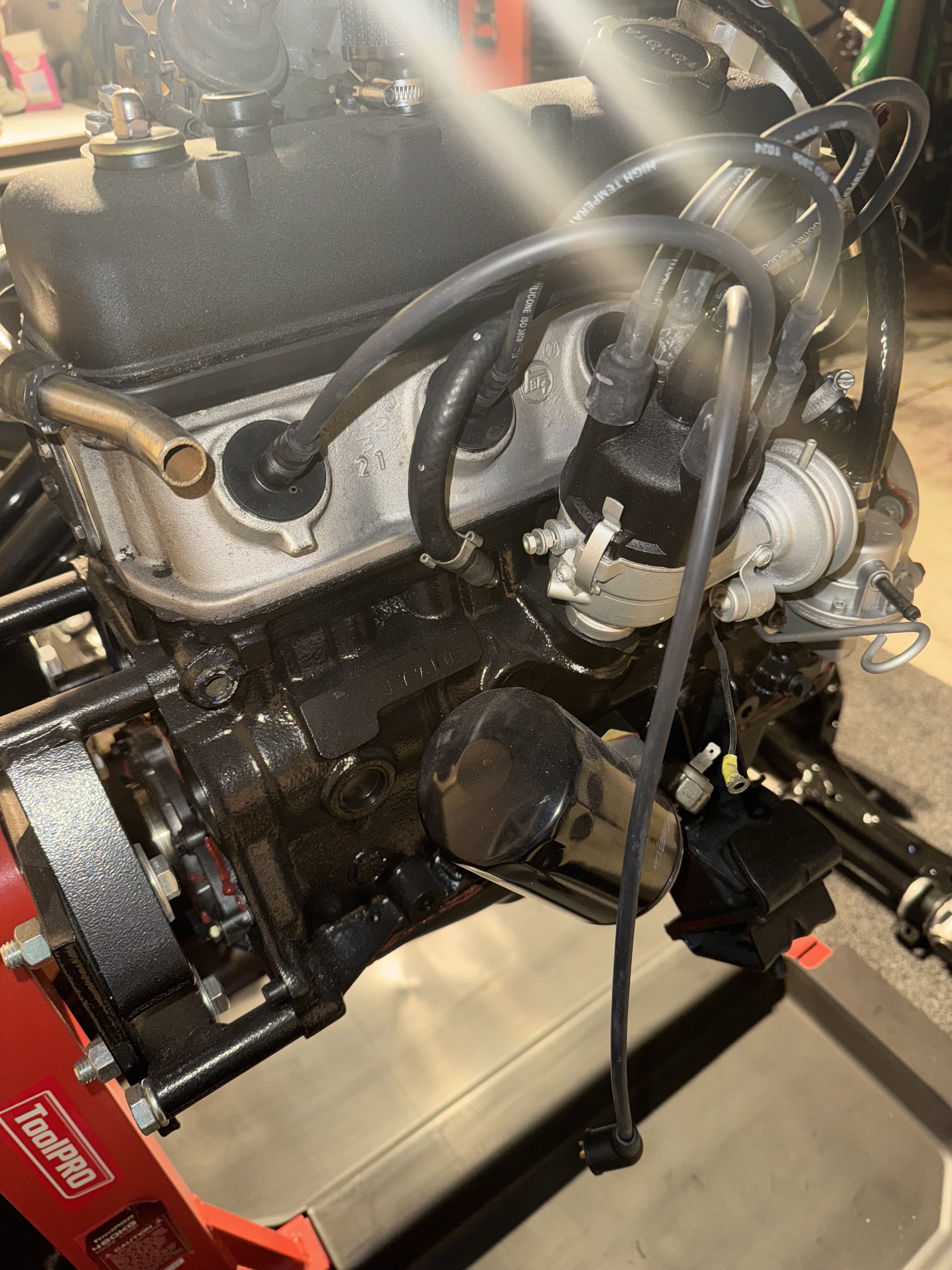

Hi team, Currently in the process of rebuilding a wee kp for summertime skids & coffee cruising. Bought the kp and have come to realise it’s got a dished piston bottom end and what I believe to be a 5k head and have confirm this with the previous owner but it’s all “apparently”. The head has got the two knobs under each spark tube at both ends. Anyway, I’ve turfed the facto radiator and electric fan and have gone for the Fenix ke70 ally rad/fan shroud kit for maximum coolage when abusing it over the takaka hill. Question being, are the entire top & bottom thermostat housings compatible across the range of 2k-5k heads? My current thermostat housing outlet is shooting off towards the right hand side of the bay if you’re looking at the motor. The Fenix top tank outlet is on the left hand side. Option 1: I run a 180 degree rad hose off the current set up, through a length of stainless and into the radiator. (Not the end of the world). Option 2: we tidy things up and put one of the other thermostat housings on that shoot the other way. basically just wanting to know if they bolt to the head all the same. Really appreciate ya help in advance, Cheers fellars
