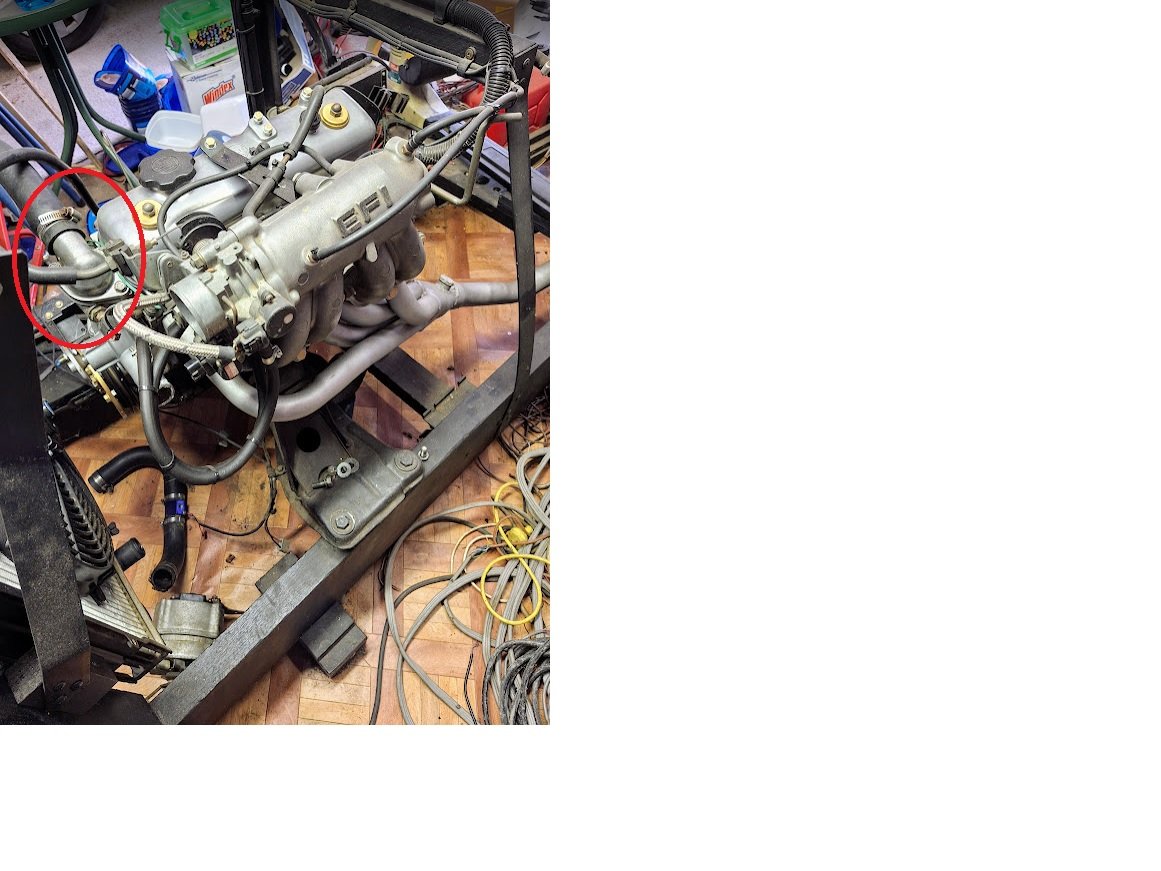

Frankly, after all the K Series engines, I've seen on the net, & in real life; I can't remember ever seeing one with the top outlet spout, pointing towards the RHS.  All the ones I've seen point towards the LHS; as on my 4K test bed engine below.

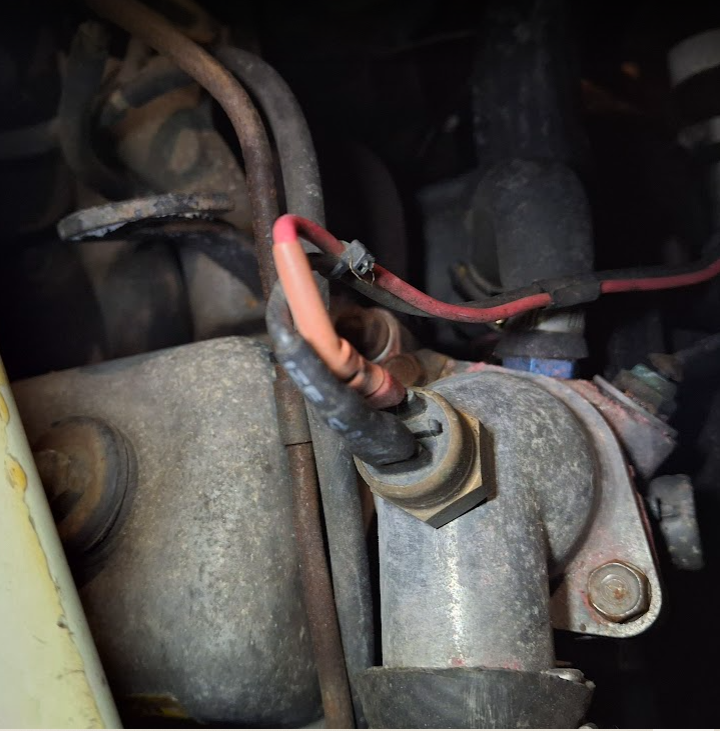

I just need to have a fiddle with temp gauge sensors, I also need a port for the fan switch, may need to run a twin T fitting if there’s only one tapped port on the bottom of the housing.
shes pretty ugly but a good scrub up with some scotch bright and she’ll be brand new haha
ill touch base when she arrives
felllars, cheers
I have seen a thermostat cover/spout, with a threaded hole right on the top, that is the perfect place to put a electric fan "high temp" switch.  (95 deg C is a usual/common fan switch temp)
Anyway, I could not get hold of one, so filed a small flat on the top of the thermostat cover/spout; drilled & threaded a hole & fitted a hi temp switch. It's been in my daily drive, for years, & works like a charm.
P.S.  My aluminium radiator & fan is out of a Toyota Echo.  Works a treat.  The fan rarely comes on, when driving, as the ram effect of the air is enough to reduce the coolant temp.  However, when I pull up in the driveway, after a run; the fan cuts in; & about 5-7 minutes later shuts down. Works like a dream, so the position above the thermostat, is a perfect fan control point, in the coolant flow path.
Don't use a T fitting for two temp sensor. The temperature guage sensor, is best fitted to the standard guage point, on the lower thermostat housing, on the LHS, viewed from the front of the car.  Works perfectly there.
