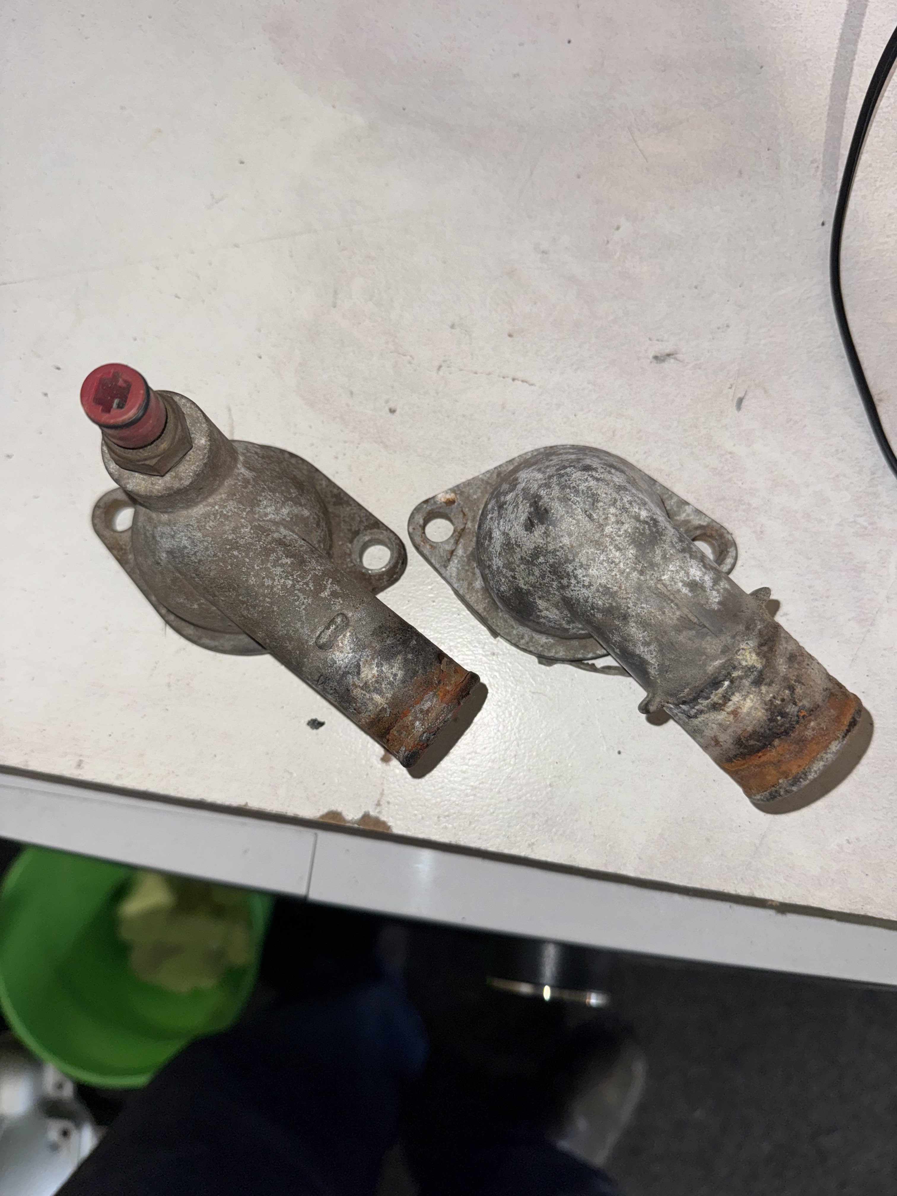

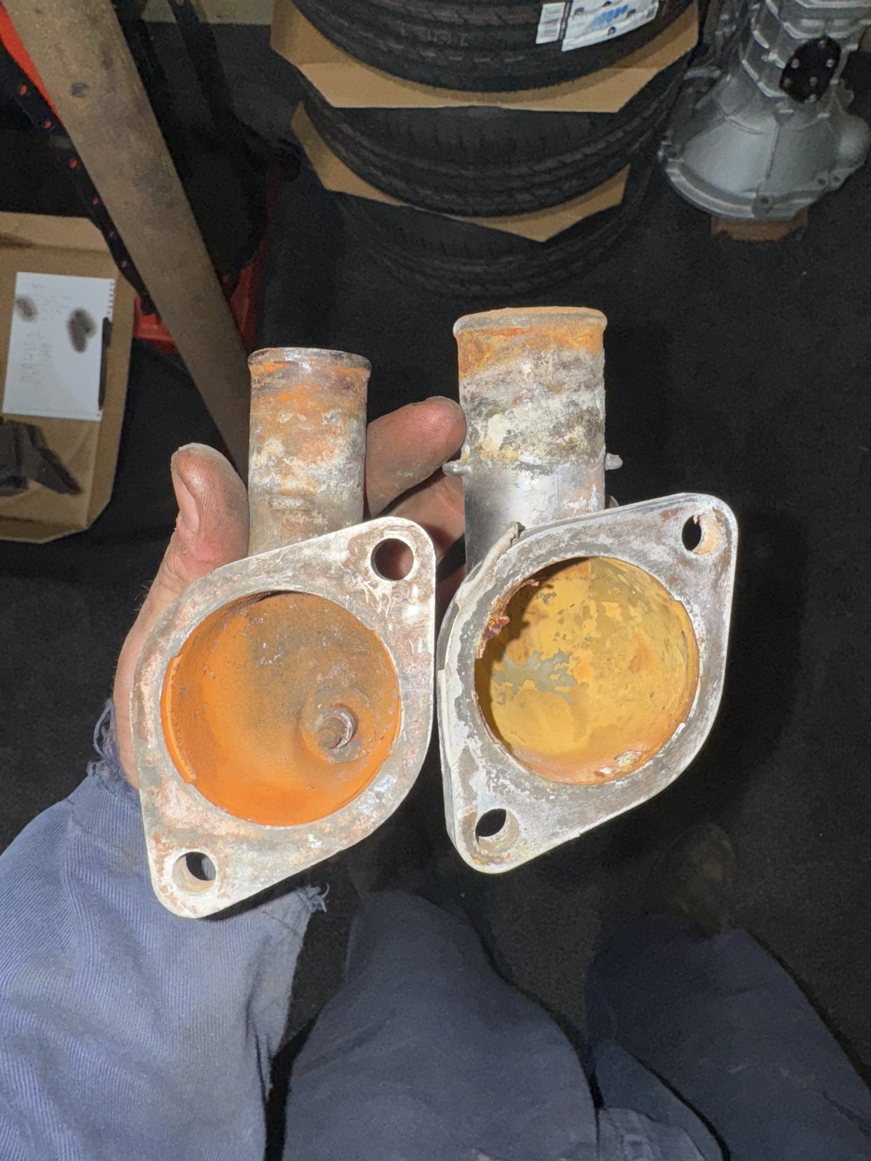

The thermostat housings have arrived and we’ve got two options. You should be able to make sense on what I’m talking about from photos attached.
Option 1: has a temp switch hole tapped in already, but the outlet diam is small than our other option…
option 2: tap a hole into the housing with a larger outlet. This outlet will match the rad inlet
what do we think about this?
I don’t think it’ll make a such difference but in a perfect world I'm thinking tap the bigger outlet
cheers fellas, input much appreciated as always
Hi Thomas,
                     Yep, the one with the larger outlet, would seem to be the way to go.  However, if it was me, in your shoes; I'd give both top outlet sockets a really good rub back with a rotary wire brish, on a drill, & then take a look to ensure there isn't any unseen corosion, that may compromise your project.
A brand new 80 grit emery paper unside down, on a hard flat suface, show clean those gasket flange surfaces up sufficently ?
Cheers Banjo
Edited by Banjo
No, if you drill the larger diameter one you will find its only a few mm thick, nowhere near enough to carry a thread.
Clean them both up with a wire brush and dig out all the corrosion holes and see how bad each one is. It wouldn't be the first time I've filled the craters with body filler and had them last for years. The bigger one is the ideal one obviously, but any temp fitting will have to go in the head, where the alloy is thicker.

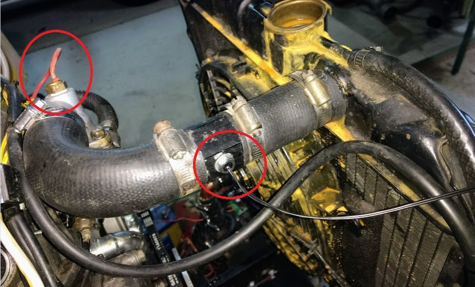

The best idea would be to buy an in-hose fitting, I've used them for years.
https://www.ebay.com.au/itm/225253674996?chn=ps&_ul=AU&_trkparms=ispr%3D1&amdata=enc%3A1Im-dDrB5R7C86KkC0s-uAw42&norover=1&mkevt=1&mkrid=705-139619-5960-0&mkcid=2&mkscid=101&itemid=225253674996&targetid=2367800370202&device=c&mktype=pla&googleloc=1000339&poi=&campaignid=21776442415&mkgroupid=173963205248&rlsatarget=pla-2367800370202&abcId=10047386&merchantid=7667992&gad_source=5&gad_campaignid=21776442415&gclid=EAIaIQobChMIsPrt9KeWjgMV9yutBh11xhHNEAQYASABEgLGPPD_BwE
Hi Thomas,
                   I've used both solutions on one of my test bed engines.
The one on the aluminium spout switches the electric fan, & the one Altezzaclub suggested; I use to log the coolant temperature on an independant temperature data logger, so I can see exactly what the cooling system is doing.
Cheers Banjo
