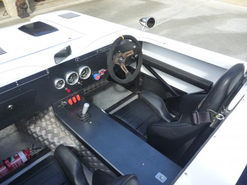

  4. I own a sheetmetal shop so i stuck with what i know. No fibre glass in it. see attched how it would have looked with fibre glass or twice the work with alloy.

  6. Thanks Ill look in to it. Some more pics for you.
  7. The car will mostly be at track days hill climbs and the odd run in the hills. Soon to be 4agze with rotrex t50 sprinter diff trd lsd adj coilovers gtr front brakes std sprinter rear disc brakes adj brake bias silvia modified hubs with wishbone top arms silvia adj castor rods Hade made all aluminium body I think it has a 4.1 so a 4.3 or above. I might leave it as you said and wait till the motor is finnished.
  8. Does the lsd house the gears or is in the diff side so to speak?
