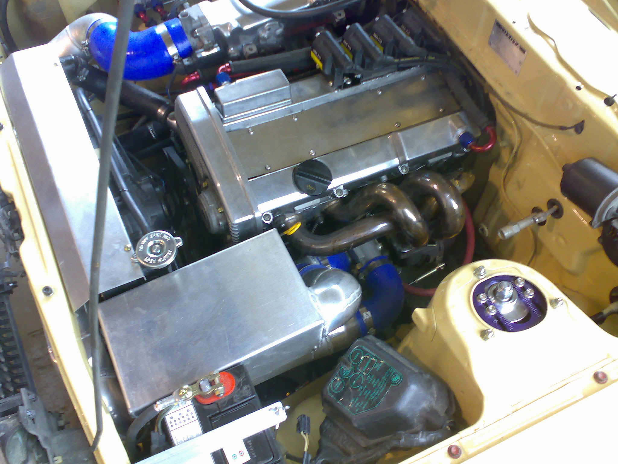

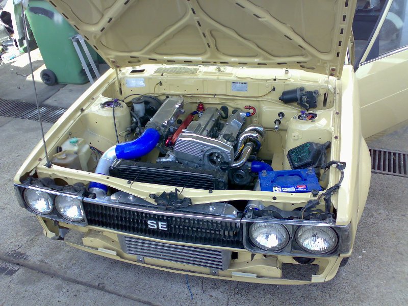

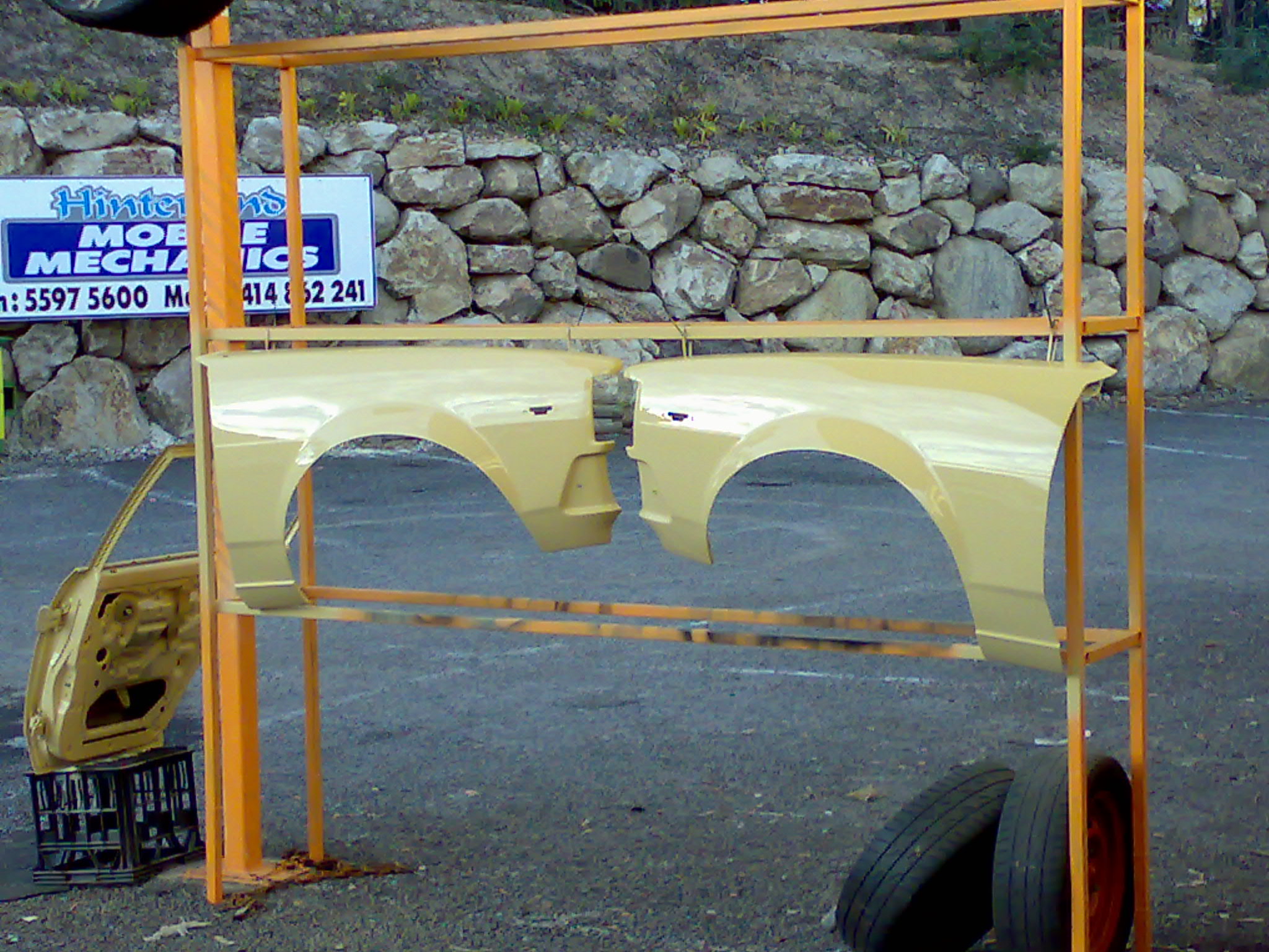

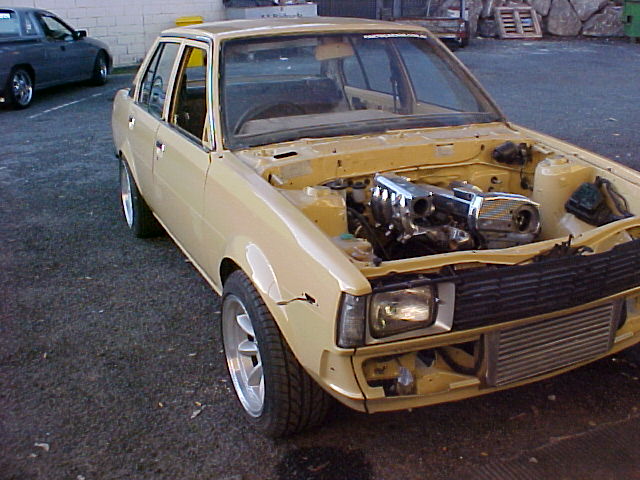

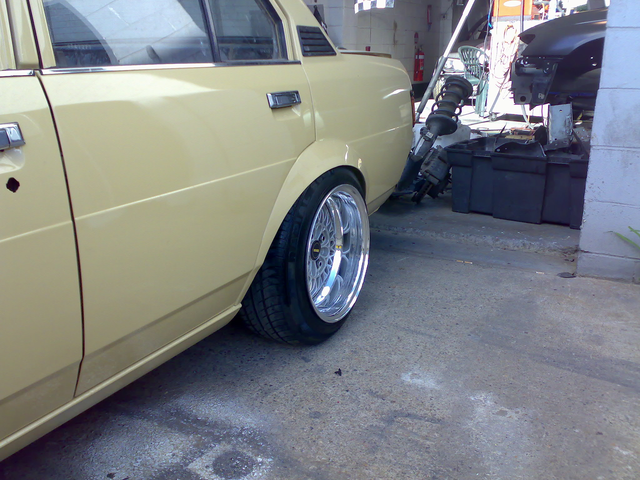

    Ok so ive been a watcher for ages and i am getting better with this interweb thing, So i decided to start a build thread. Basically i started with a stocko early 70 that previous owner had painted panda style with cans, It even had a big alloy t-wing on the back,Yeew. I wanted to multi purpose the car so i opted for a Ca 18 nissan motor cause it was cheaper option, and would make the power i wanted with to much effort. SO it has, Ca18 rebuilt ,arias pistons arp bolts ,headstuds, shotpeened rods, balanced,acl race gaskets, gates race belt new tensioners and idlers,puck clutch, single piece tailshaft, Jap spec diff , TRD two way, disk brake ,braided lines front and rear,coil over rearsprings custom coilovers on front using ae86 struts, celica inserts,NRCAs, fuel system, etc etc. I have two recaro recliners to go in the cabin, and i will be putting carpet and trim in as i want it to be regoed. Ive just been doing little bits as i go , moneys tight so shit takes a long time. Let me know what you think , i will update as soon as i get tail shaft balanced, cheers
