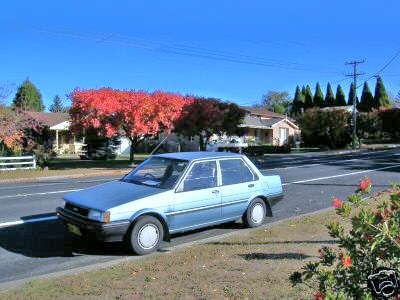

  11. Hi all, newbie and just purchased a 1985 1600cc corolla sedan. joined the forum because I know sfa about corollas. would some corolla person tell me what this car is? model, I know it's a 1985 but ke, ae, ?? any info would be good. also it has a blown head gasket. what to watch for when repairing it/
