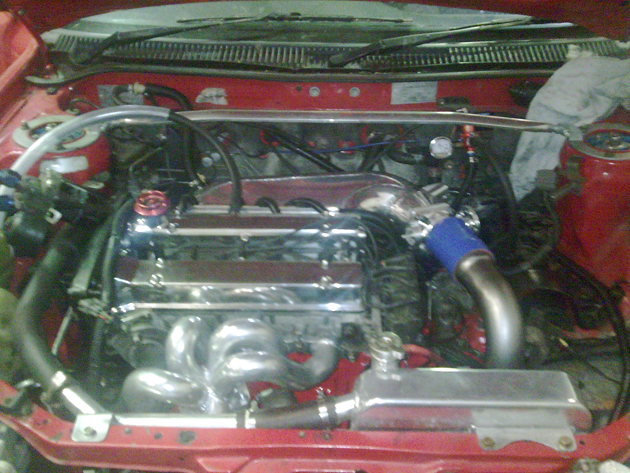

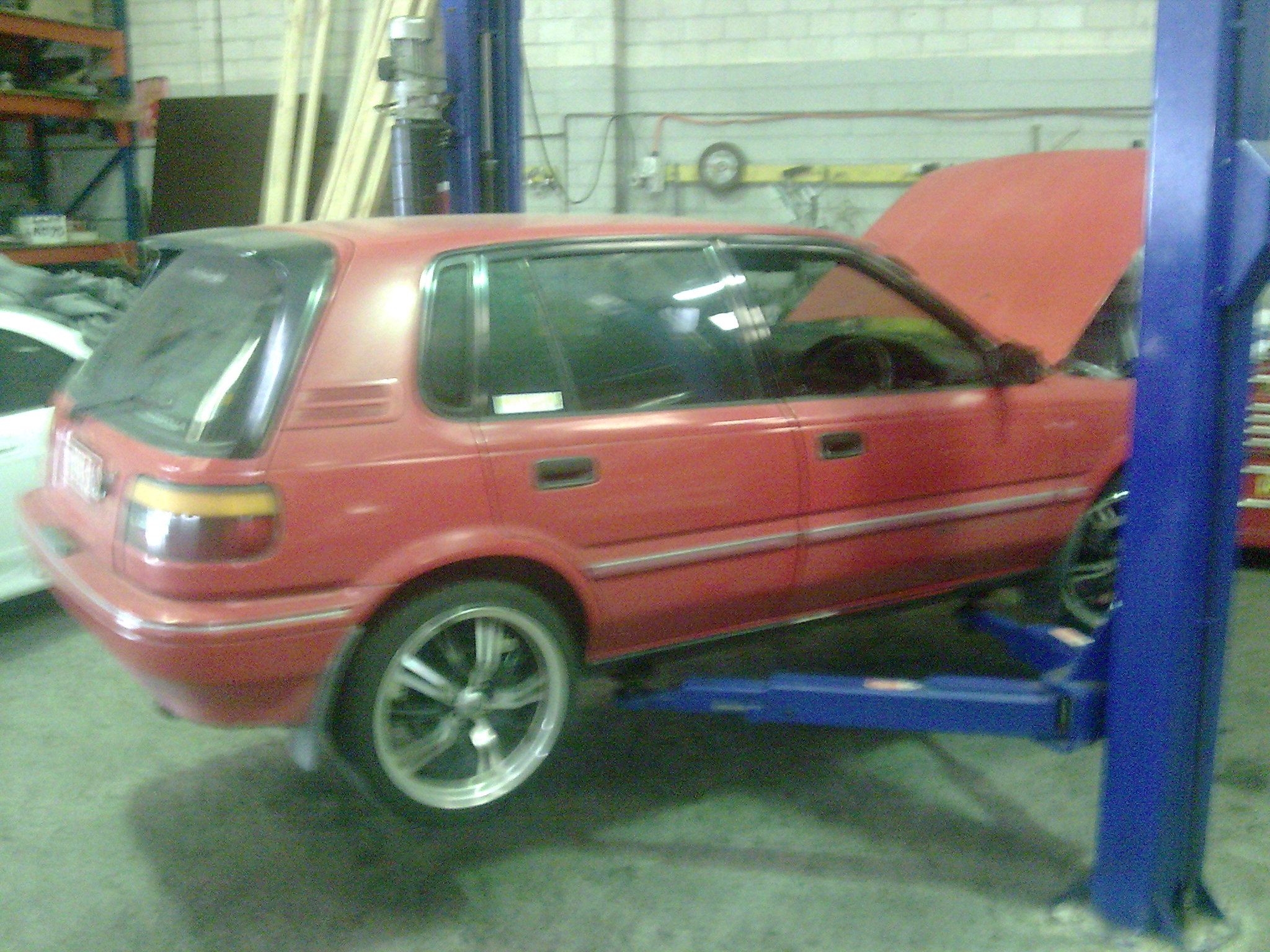

  4. ill post more when i get the car out of the shop
