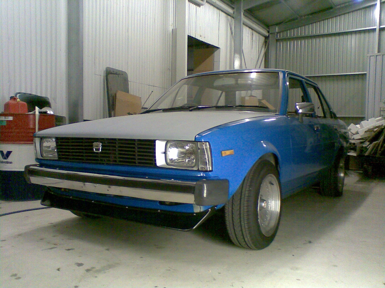

  2. Only pic at moment car is in pieces awaiting some paint Taken with a camera phone http://www.rollaclub.com/board/style_image.../attach_add.png
  3. Well, I thought i better write one of these build up things, problem is I've already done most of the build, so i wont have many new updates to post... oh well Around 3/4 the way through last year (2008) my pride and joy, minty fresh one owner RA63 celica got stolen from out the front of my house. The night before it was going in for some well deserved paint work. I was already looking around for a KE70, so i now had the perfect excuse to buy one. I think within about a week i had found and brought one, Absolute minter! How wrong i was! when i got it to my workshop under the lights, there was dented panels weird starting issues a massive lack of interior (and i got a supposed overrated complete interior with the car) miss match diameter wheels hardly anything under the bonnet no emissions missing wiring late model corolla radiator cable tied in gearbox held in with one cross member bolt done up one finger tight, and one mount to gearbox bolt finger tight, one missing. half the bellhousing bolts all finger tight. cut springs on supposed 86 front struts cut springs and locked diff in rear terrible drift spec twin pipes missing exterior trim parts the list goes on, i can't really remember it all. so your thinking what a dickhead, you should have picked this stuff out. I knew about suspension, diff and (most of) interior. but the rest didn't make it through my rose colored glasses, see thats the problem when you buy a car on face value. It looks sick, until you start looking at it a week later when the novelty wears off. any way if you managed to get through all of that, this is where it stands to date. 198* KE70 (Flat Front) 4KC Completely original stock as a rock motor with everything from factory on it. K50 5 speed, now with working reverse (funny, all you had to do was connect the plug) and bolted up properly. Complete 1984 slant front,(gray) overrated interior with venetian. Complete exterior trim work Brand new taillights New exhaust with factory looking outlet (right down to the bends) JDM AE86 front struts and brakes, (sitting on ke30 lower arms i think, arms came with car) Standard diff (Open) ATM cut standard springs, plans to get king springs Madhouse Lip 14x7 0 offset CSA Globelines (Brake Boilers) with stretched 185/60/14 Full audio, fitted to look standard XX tacho dash with all new brighter globes and LED's were appropriate larger rear swaybar (came on car) Chrome bars (current project) New panels (currently in primer) Sunroof Much more to come.... Pics time i guess
  4. well its all over now, drilled holes in the passenger's door... and fitted two sweet looking mkI corona chrome mirrors to the old ksev. they look good against the super out there pastel paint work and only cost me $12 from u-pull-it score, i guess. guard mounted mirrors would still have looked cool tho... cheers for the replies again, ill have to set up a rides thread and show people
