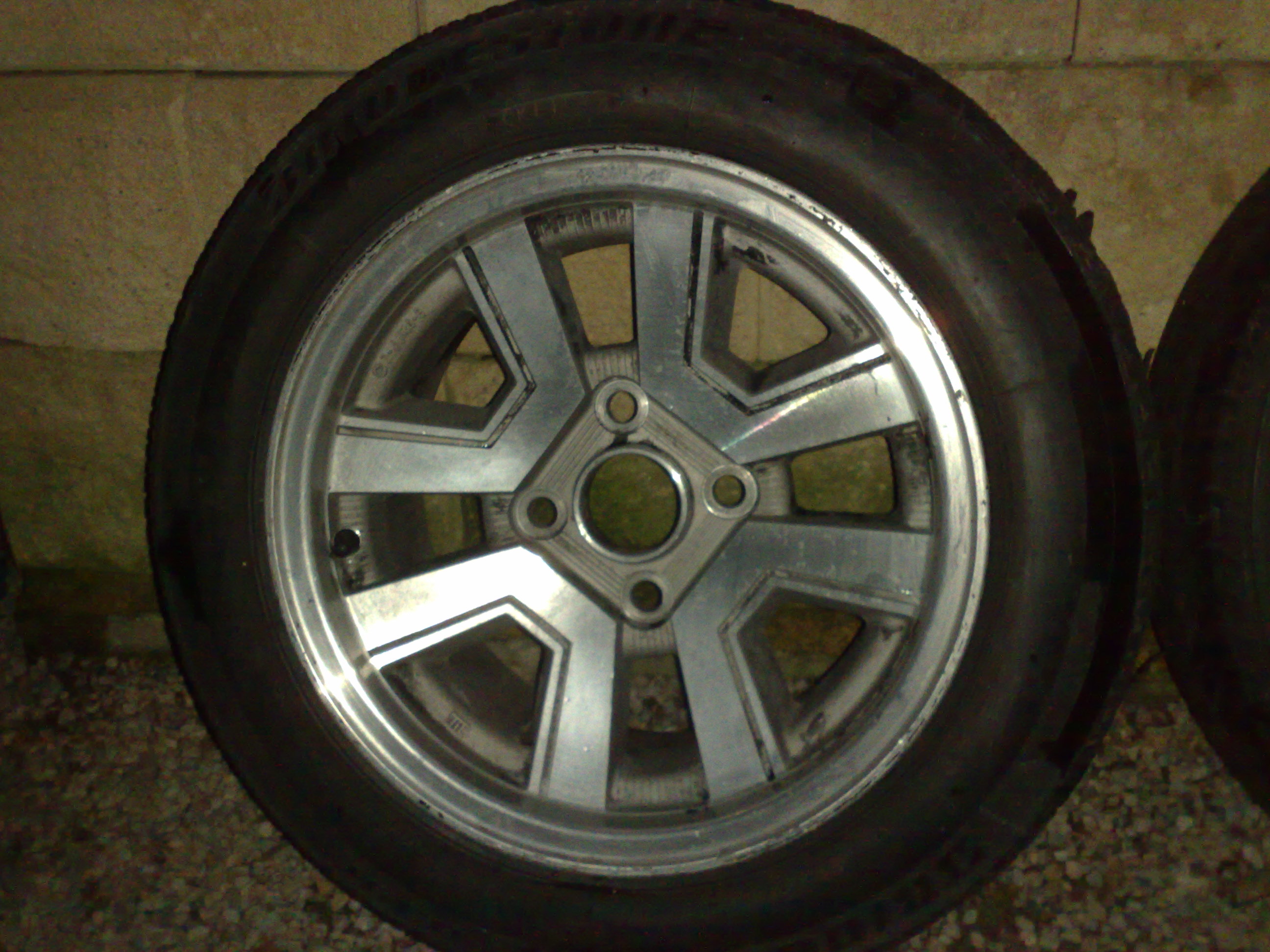

  11. Hey all iv just got some MA61s but the guy who had them before me painted them black iv got the paint stripper on to them but its taking much longer then I anticipated. I have cleaned some up a fair bit but its just the last bit of pain and on others the inside pieces don't want to come clean. The first dab of stripper got the paint to blister in a matter of seconds and the brush was able to get it down to the metal, but from then on it seams like slow going. I'm weary of using a ruff surface, scraper or anything like that cos I don't want to scratch them. At the moment I'm just trying with a stiff brush and a tooth brush. Has any one tried a scraper on them before or have an idea about how to speed things up. Also when I got the rims I was told that the stock nuts off of the 13” alloys would work is this right? This is the best one but it still has some paint on it and some of the others are much worse.
