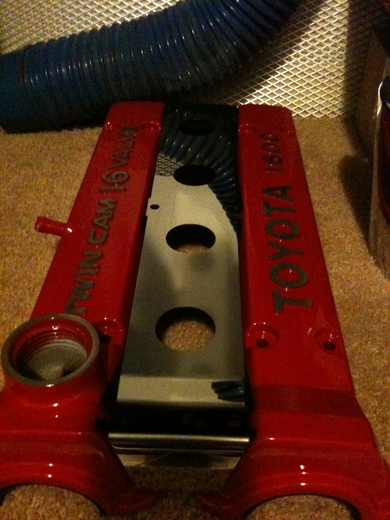

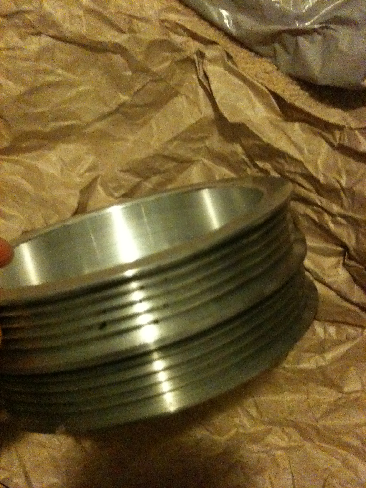

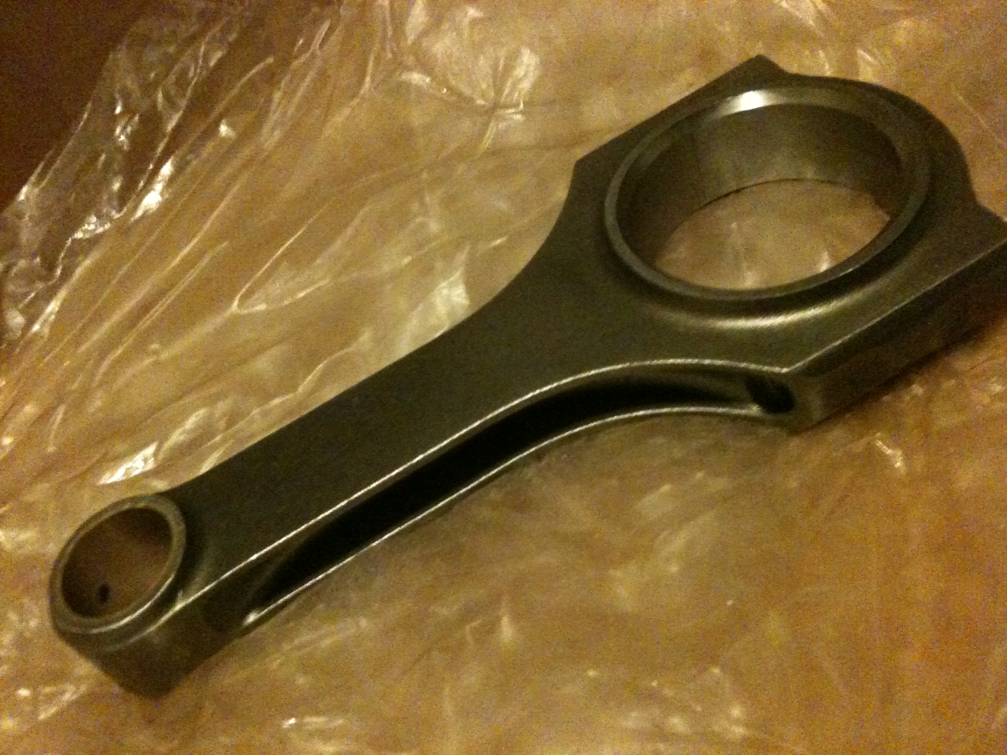

  14. finally got my motor to the shop and can't wait to get it back , so in the last coulple of months i've been getting all ready for the big moment! i resprayed the engine bay and all other parts have had a nice coat of red and silver with a touch of black.here is a few photos!

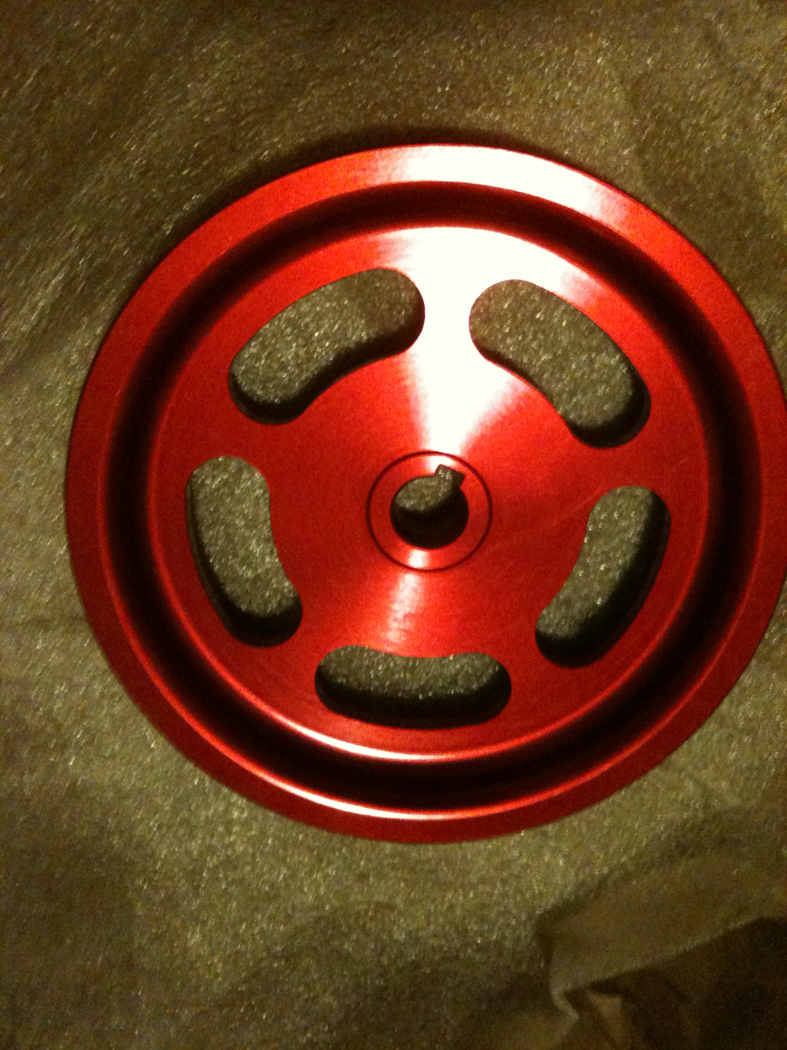

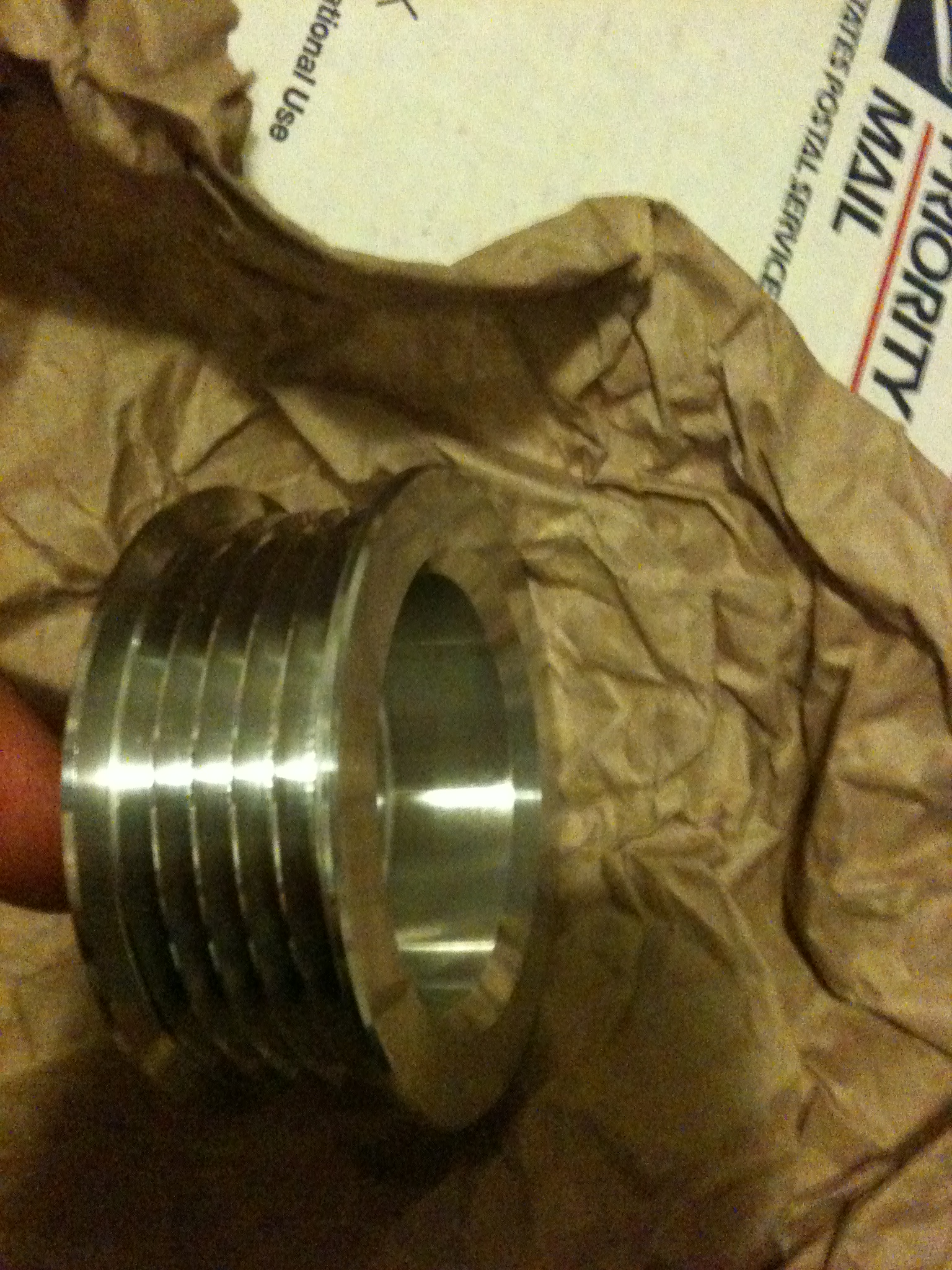

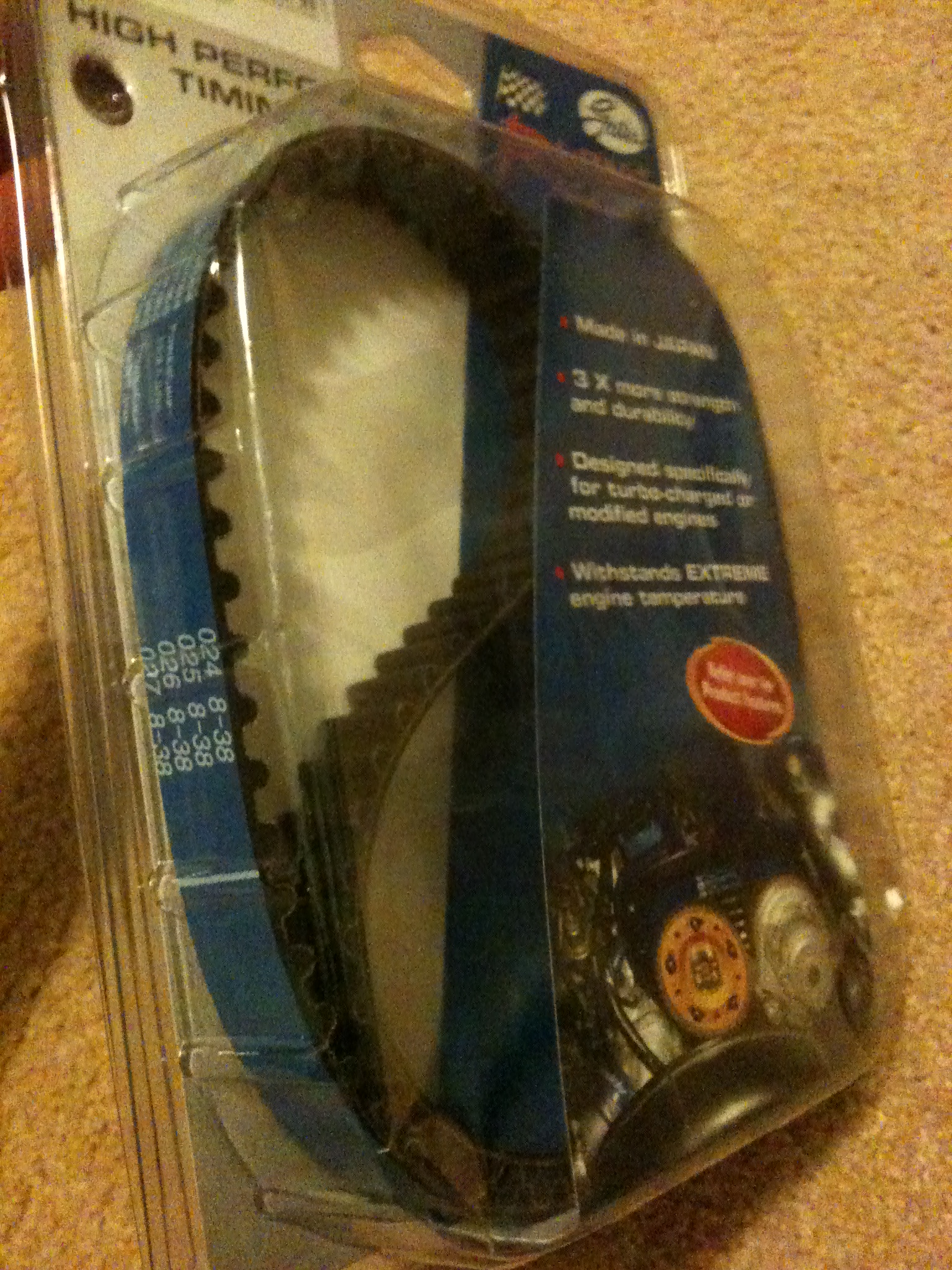

  16. It's not long before i start taking the engine apart and rebuild so i am going to be posting as it goes.! My garage has so much in it at the mo so i'm having fun! Just a little on what i have planned--- The head is getting over sized valves,deep dish racing with duel valve springs Ported without polihing,port matched bronze valve guides adjustable cam gears gates racing timing belt blue red cam covers clear cam gear cover racing pulley's kit The block is getting the usual with over sized pistons, oem hks 2mm head gasket arp head and main bolts h-beam conrods acl race bearings lightweight flywheel 3.8 kgs stage 3 clutch kit heavy duty and thats it at the moment !

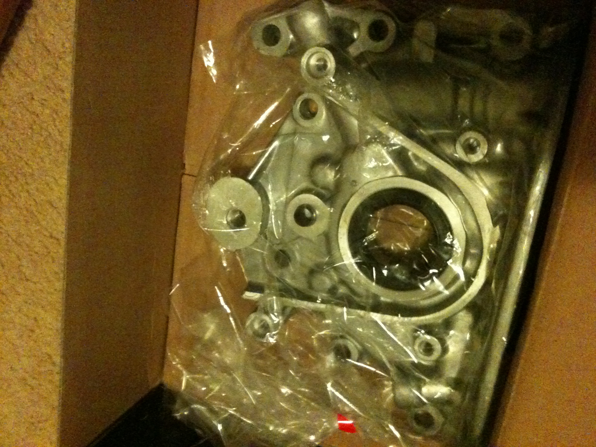

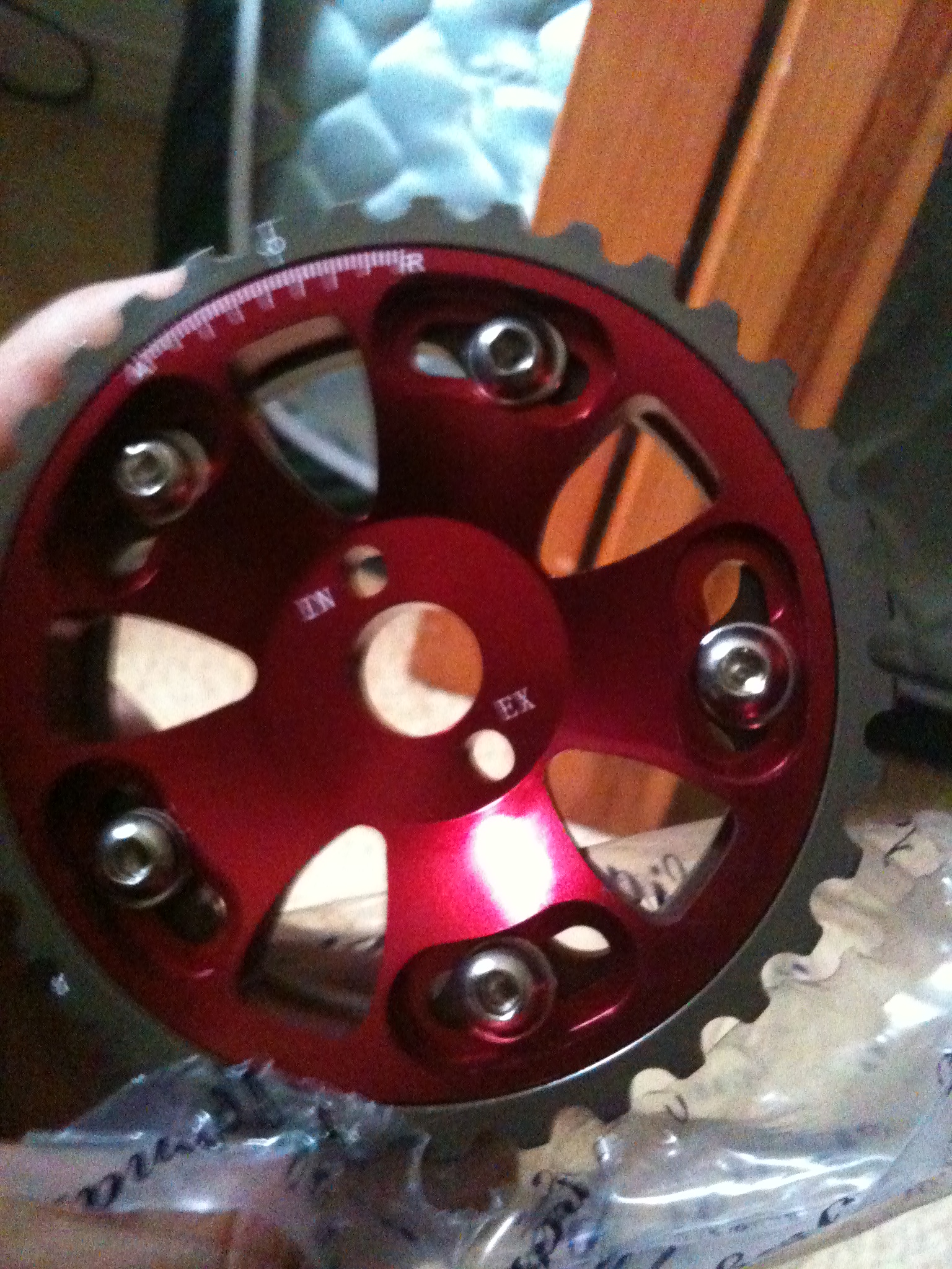

  19. These parts i bought about a year ago, theres more but in good time! really can't wait to build this engine its been a long time gathering all the parts and it never ends!

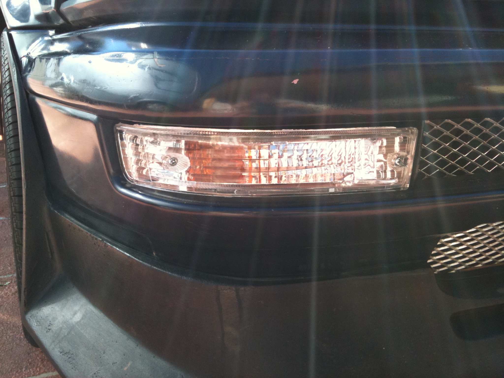

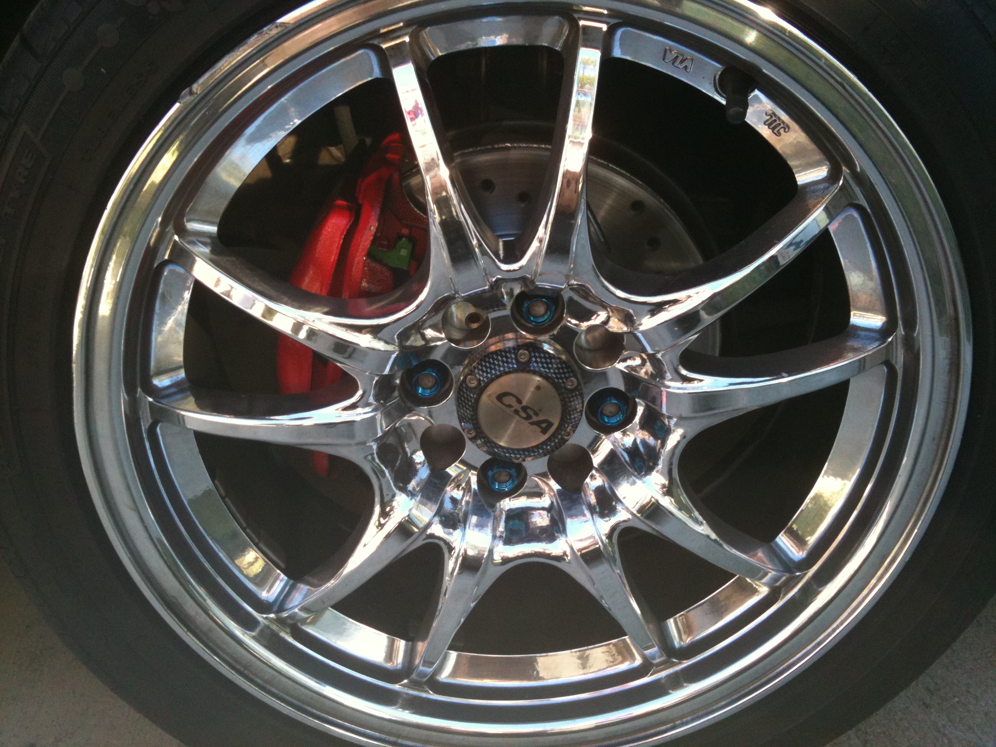

  22. I finally have got rear disc setup now and have had my license suspended for 6 months, so that worked out great ! oh well its been a while since i have done anything to my car except the brakes and clear indicator lenses. as for modifications well..... iam building my engine and front end from the ground up , soon within my suspension period,depends on cash situation so i'll keep posting as i get through it and hope to get some advice on building 4ages properly? anyways heres a few photos!
