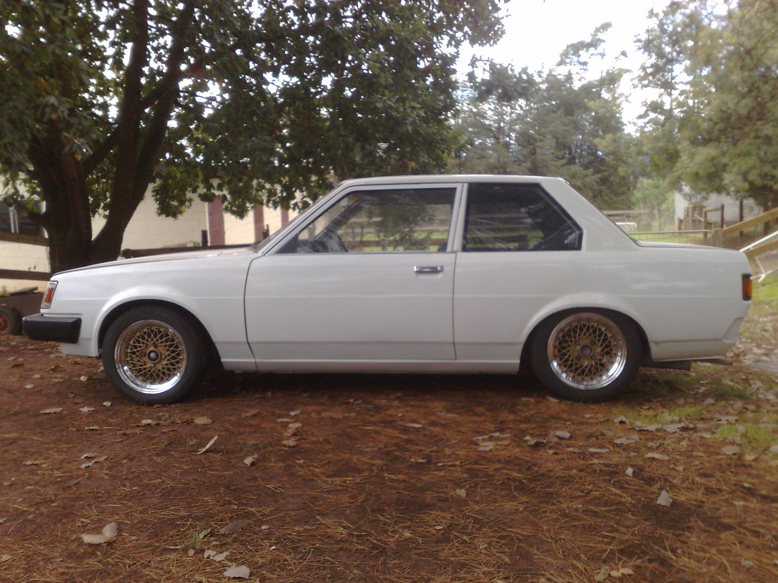

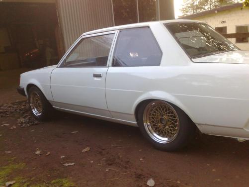

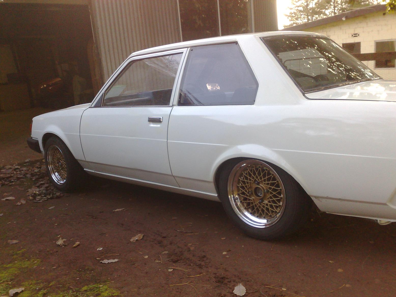

  7. My doors measure 1155mm on the body line... tad shorter than van doors... Heres a pic of the side on shot... I measured the rear glass also, along the base was 650 and 420 high on the front edge
  8. The rear door was shortened and welded in place as a permanent structure also providing support for the B pillars.
  9. Van doors are quite similar to the length of the doors on mine. Never had a van door to measure against. If someone knows the length of Van doors I would be keen to know. The doors on mine have been made out of 4 front KE sedan doors (the front section chopped just behind the middle and the back section chopped just infront of the middle making 1 long door joined together). The B pillars are the same pillars that have been cut out and moved backwith other upper sill's welded in to fill the hole. The trim is all stock KE sedan interior, still got a bit of modifying to do to the B pillar covers as the pillars are on more of an angle backwards.

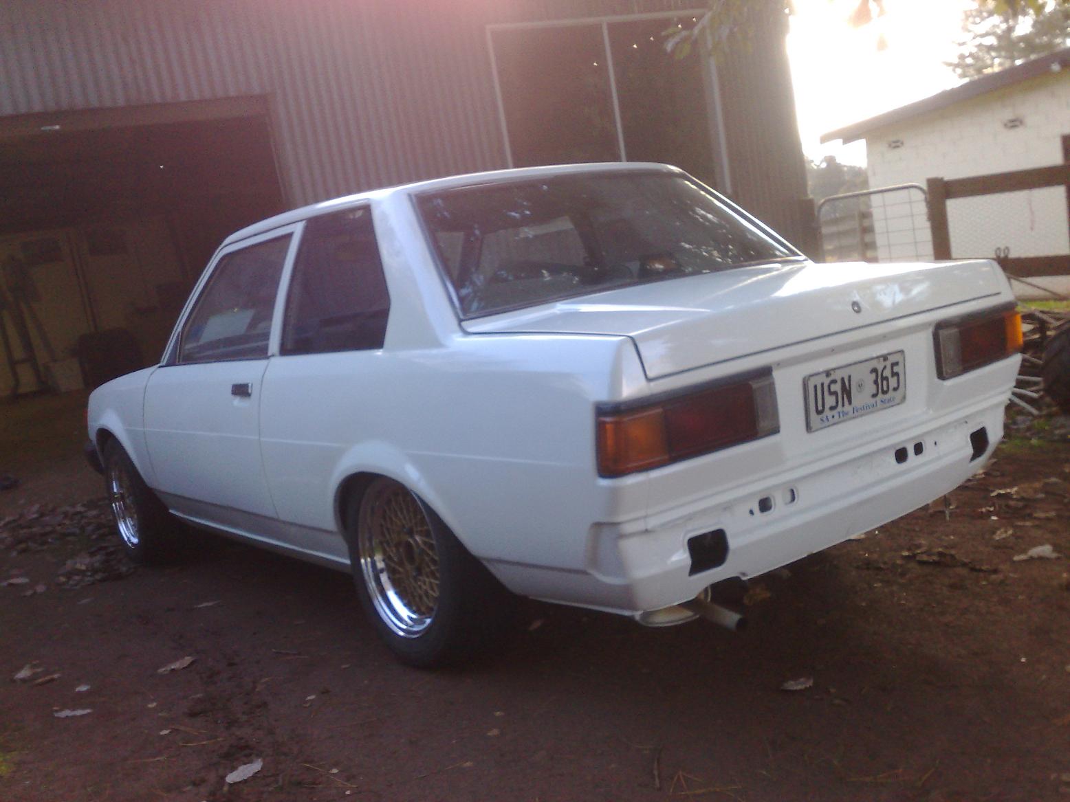

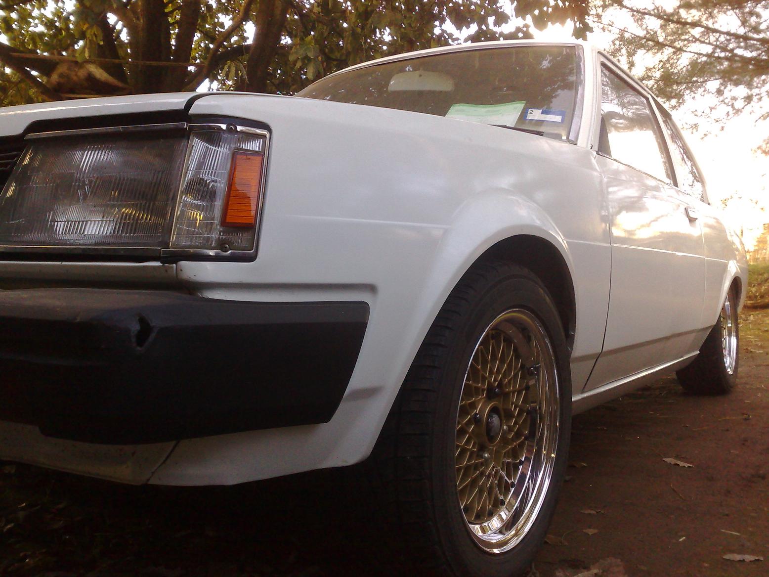

  10. Yeah that one looks overrated. I want to get the chrome bumpers like thats got too. Thats a genuine one yeah?
