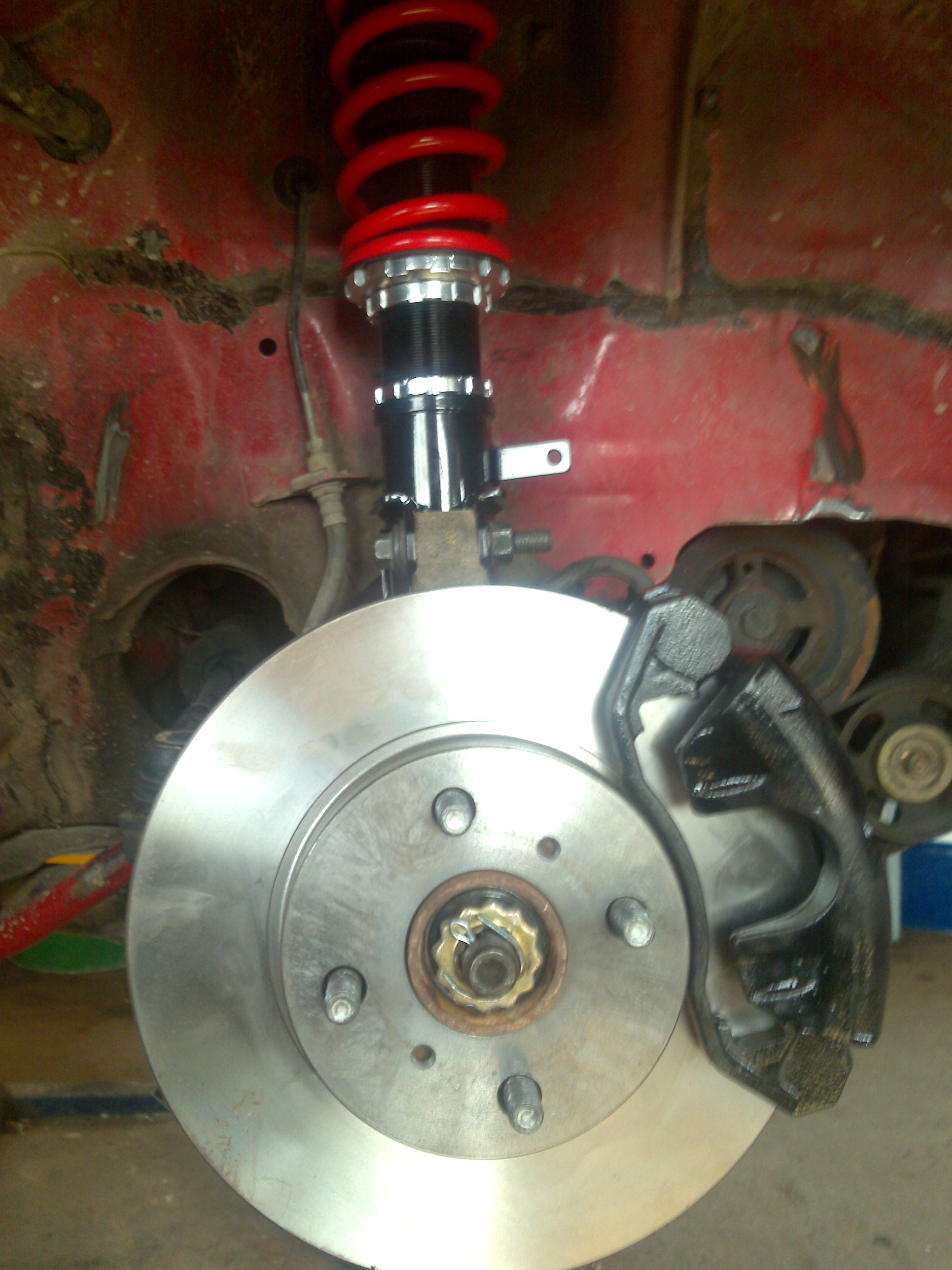

  1. Std AE92 strut is a sealed strut can't replace the insert , DBA709 cost 70 bucks and 2nd hand sv21 caliper cost bugger all !!!
  2. Pic of coil overs and Camry calipers with AE102 rotors
  3. Pedders extreme XA coil overs to suit AE101 , don't know if its been mentioned on here but front brake upgrade for AE92/93 DBA709 front rotor for a AE102 Sprinter which is 255 dia and a SV21 Camry caliper bolts straight up , makes a good cheap conversion with better stopping

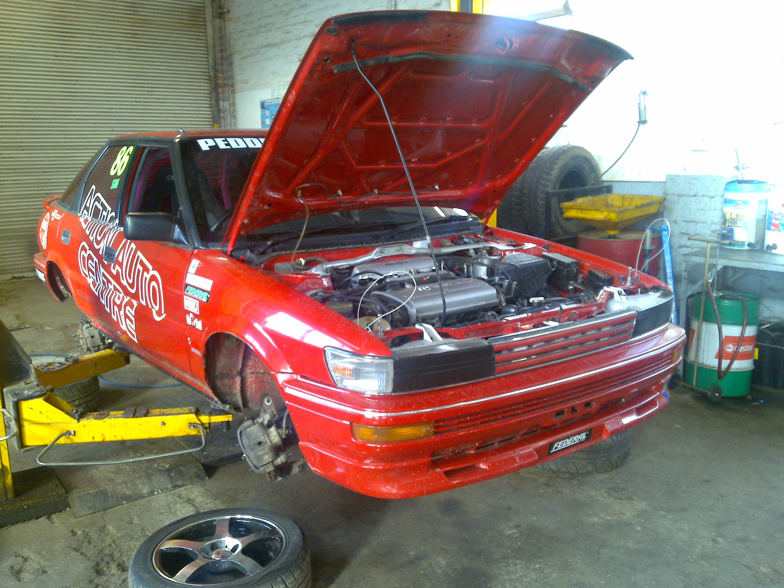

  8. We are in central Vic , also have a ae82 running a silver top with a Haltech computer as well as other mods to suspension and tyres etc
  9. Car running a 20 valve , coilovers all round bigger dia sway bars ( adjustable ) front sway bar solid instead of std hollow unit , 4 puk button clutch with ceramic centre , ceramic brake pads , 16 inch wheels 2 1/2 exhaust with no cat etc etc
