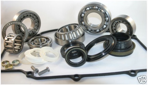

  2. I found this site with rebuild kits for 1992-2002 corolla's with the C52 tranny. What do you guys think? expensive? Could I just get these springs and balls from the local auto parts store? http://www.drivetrain.com/parts_catalog/ma...erhaul_kit.html OR Ebay has what the image shows. I don't see the springs or balls. Which of these are the synchros?
