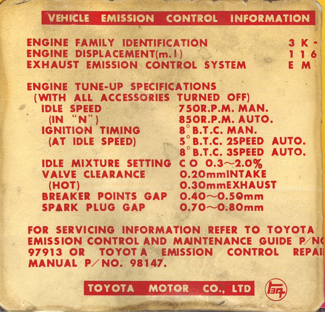

camerondownunder88 Posted October 28, 2006 Report Share Posted October 28, 2006 Hi, Just digging around in the shed and I came up with this old sticker that used to be on my car that came off a few years ago and I forgot about it. So might be of help to some one or be useful if up loaded into the FAQ. Cameron Quote Link to comment Share on other sites More sharing options...
Lukey Posted October 28, 2006 Report Share Posted October 28, 2006 thats fu*ing fantastic i wish i had my sticker :cool: nice work bud thanks Luke :) Quote Link to comment Share on other sites More sharing options...
