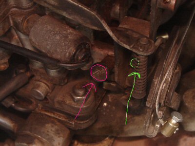

i can only see 2 screwes on the carby
i tried screwing (haha get it?) around with the pink screw in that pic, i screwed it in, it appeared to help the situation...but i really didnt know what i was doin
