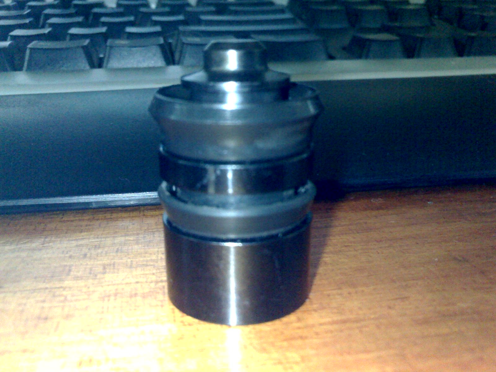

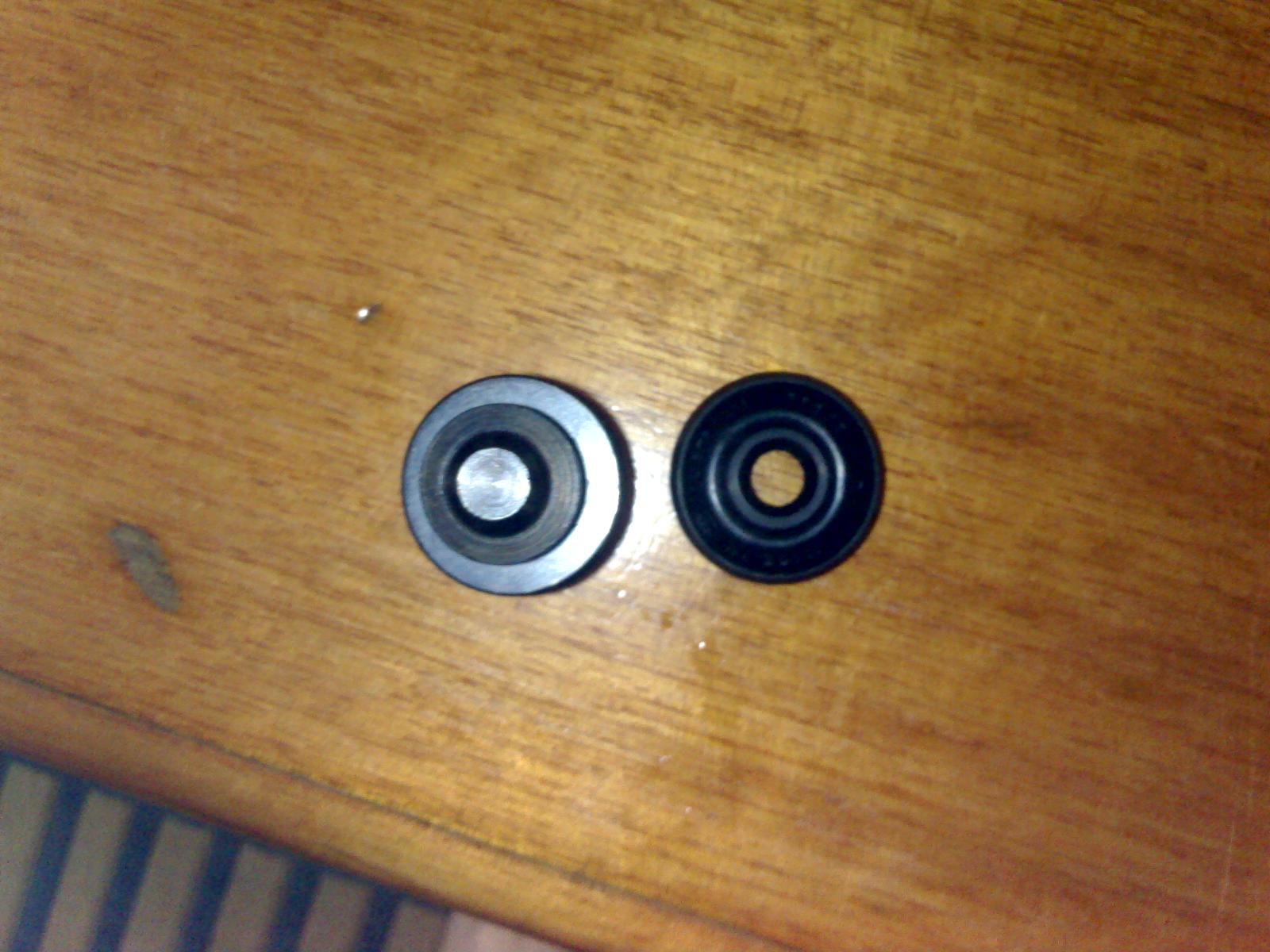

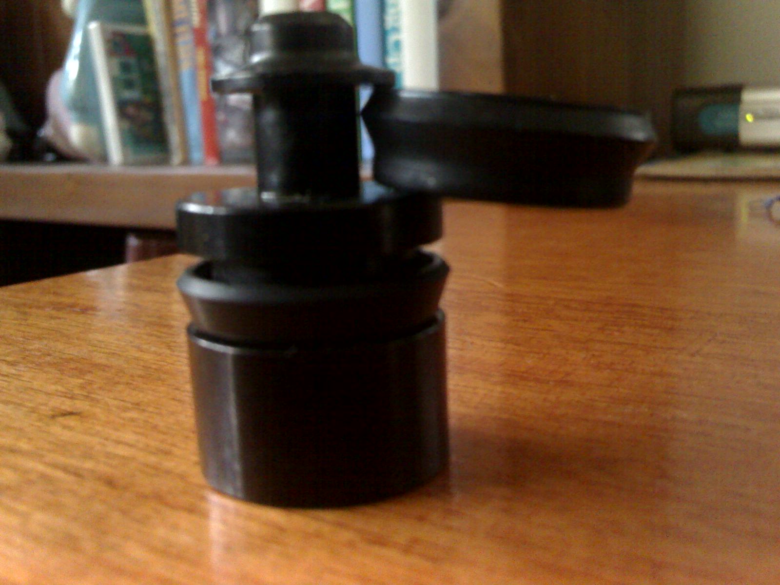

Here is my problem, I'm replacing the seals in my clutch slave and i have got one seal on the piston but i can't get the 2nd one on. How is a seal with a hole 5mm wide ment to fit over a piston that is 10mm wide?
As Raven said I'm one angry munchkin, Ive been trying for the last 80mins and no luck :) .

i know how bloody impossible it is to get those seals on!! only advice i can give is get a new cylinder!
or if you really must do it a clutch/brake shop can do it or you need a smooth tapered shaft to stretch the seal
up the tapered shaft and on to the slave shaft with clutch fluid to lubricate, just look around for a tapered shaft and modify the bigger
end to be slightly bigger than the slave shaft.

Use loads of rubber grease (do not use normal grease). And use little picks to guide it on, or a really small screwdriver that you can put a bend in.
Good Luck :)
When all else fails ask the man with the 1G, I lubed :) it up and with some swearing and screaming it went on.
