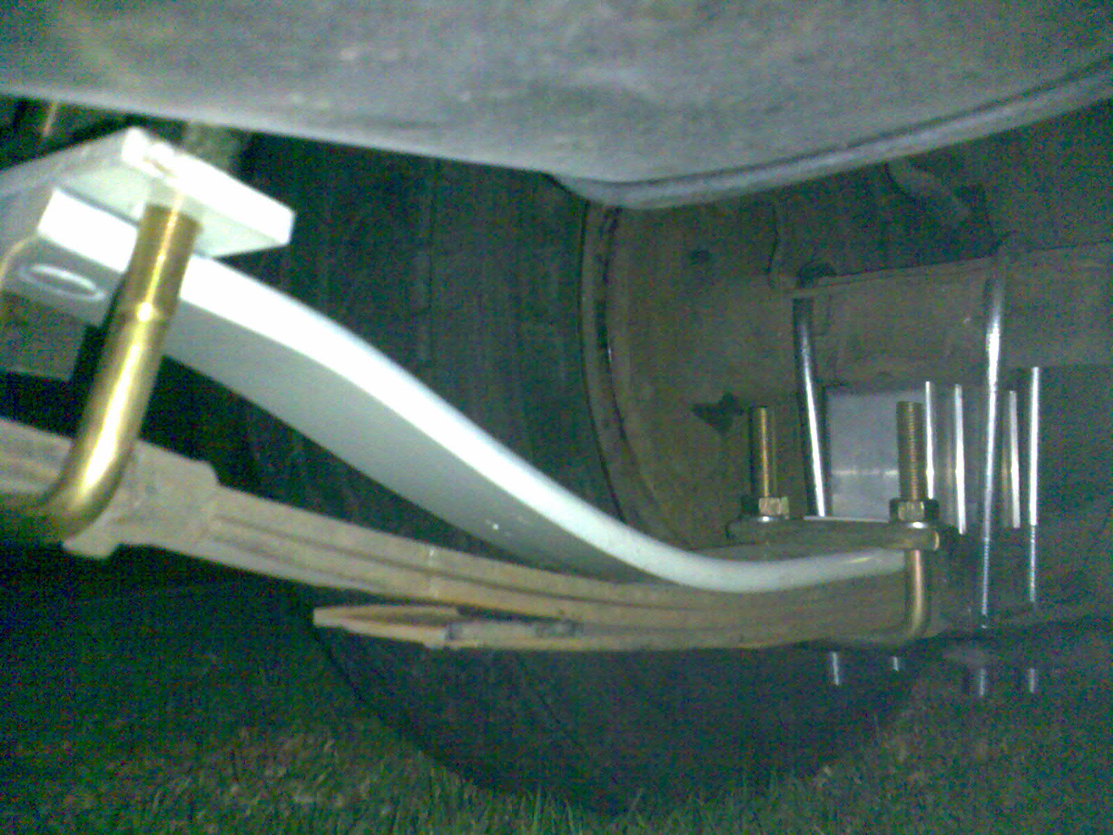

This set up worked for me.....
handles sooo much better. 3inch blocks then the helper springs.
the rear is hard as hell
and i don't seem to get much 'Tramp'.
Also if i get defected the blocks are pretty easy to take out
and you can leave the helpers there as they aren't illegal
and are akin to adding extra leaves and/or resetting
and waaay cheaper
Also the harder you do up the helpers the stiffer the ride
so essentially you have adjustable suspension.
and if you loosen them the car drops another inch or so!
