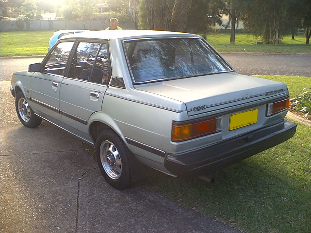

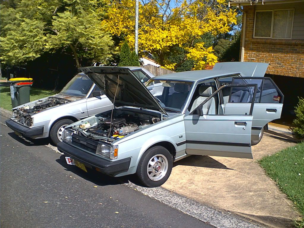

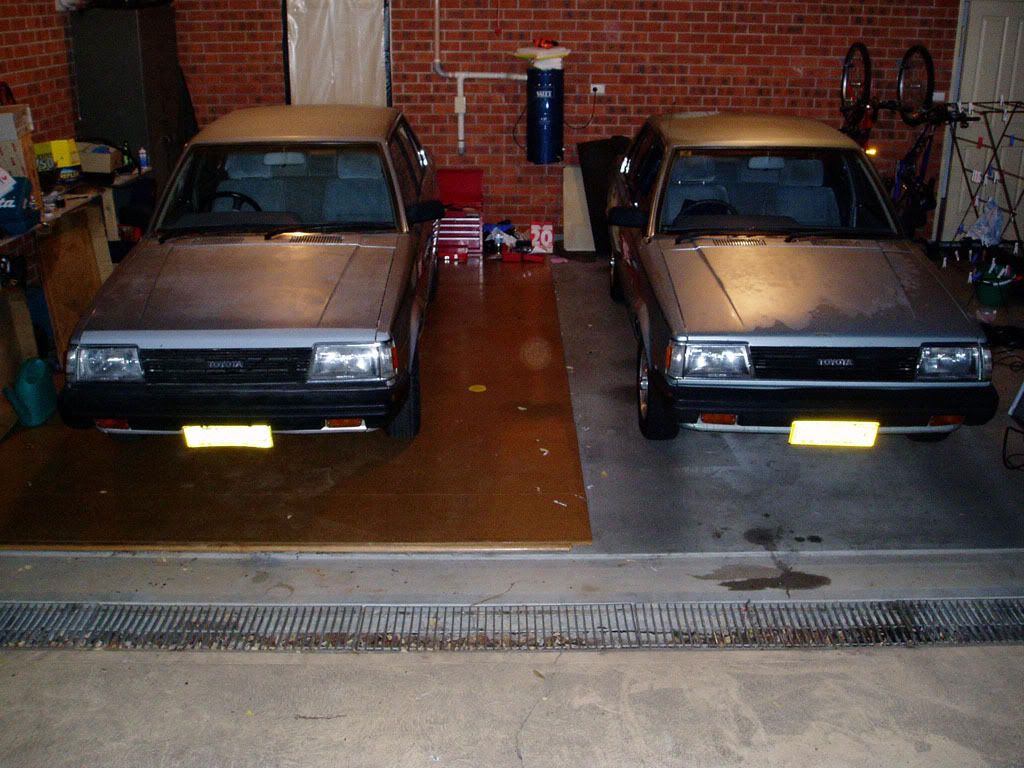

Together on the drive (You can probably guess which one is which):
In the garage together:

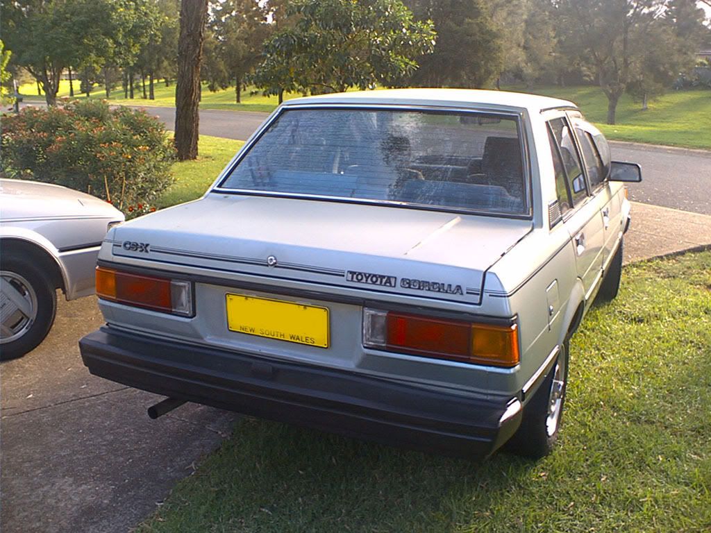

The rust doesn't seem all too bad, there is some rust beneath the right hand taillight inside the boot. There are a few bubbles under the fuel filler hatch and a few more bubbles in the rear arches. There is a small amount of rust on the underside of the boot hatch sill. Its had a few places repaired, looks to have been done very well though, no rust is coming through. Other than that, there is some surface on the guards and bonnet and on that metal piece at the back of the dash top.

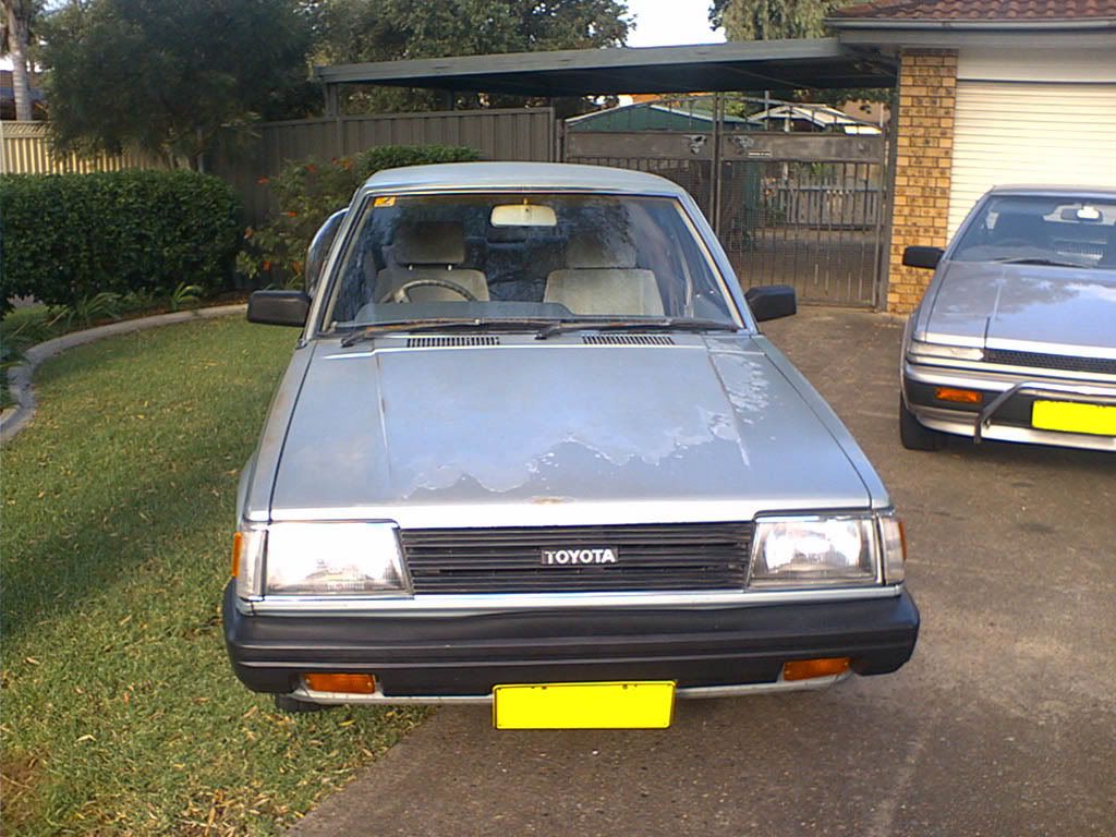

The interior is in excellent condition as one would expect from a grandma driven car. The paint is a tragedy as you can see from the pics, its dead.

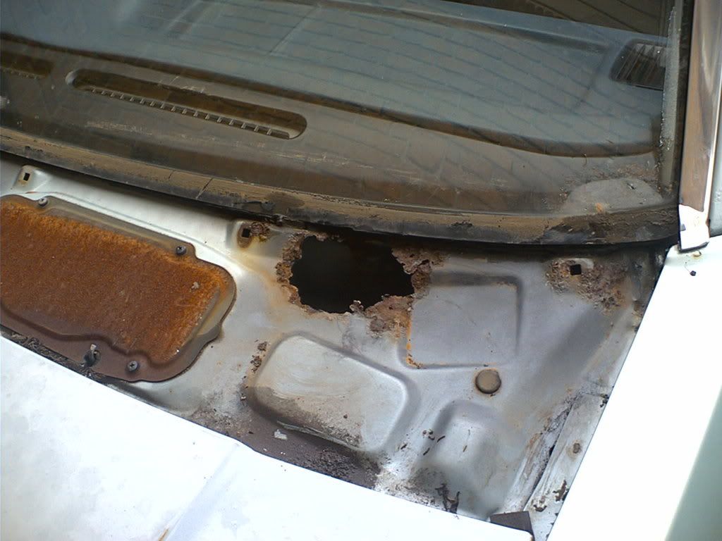

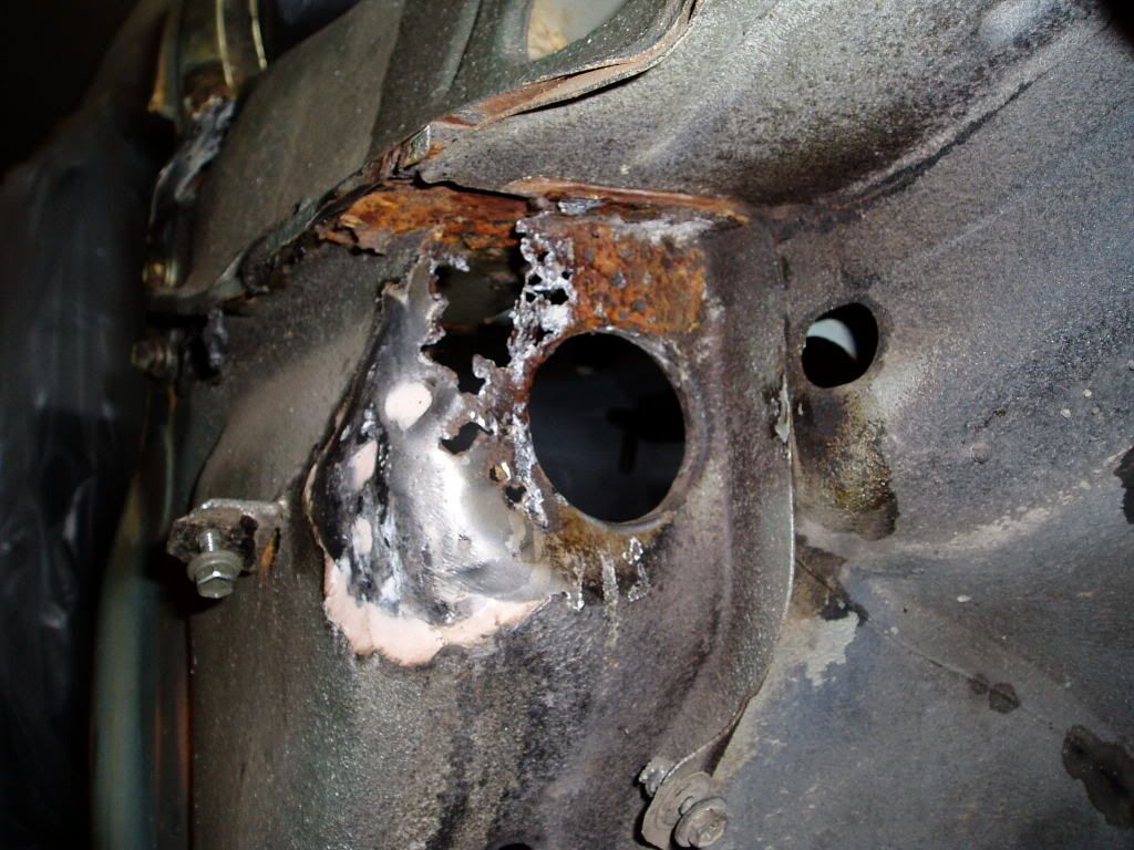

I'll start off with the bad, well you know that block in the aircon drain pipe I thought I had? Well it turned out to be a little more sinister that what I had thought:
:hmm:
Oh well, the rust appears to be very localised around the hole and doesn't spread into the chamber far. Here I was thinking my rust woes were largely over, no so! Water has been pouring in through that hole and onto the blower motor. To my surprise the blower motor still worked, until today, dead.

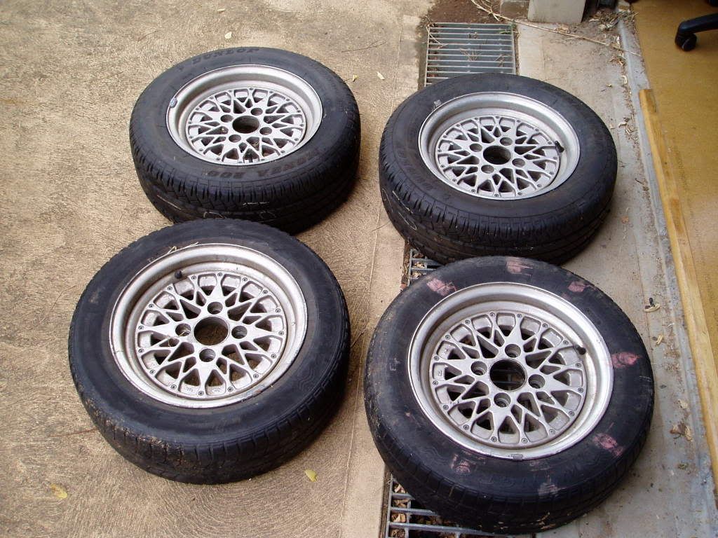

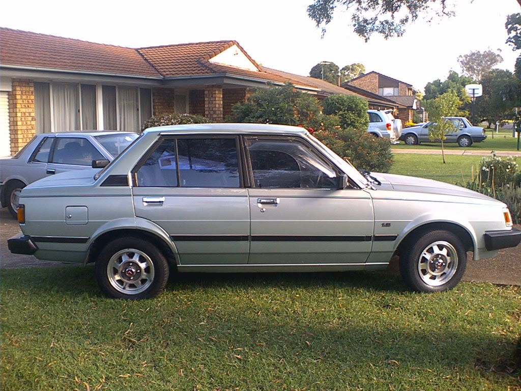

Got mags too, I really like them, a little bit of dish 14 x 6 +6 offset I think it says. They JUST fit in the rear guards without modding them. Here's a photo for you:
2 brand new tyres on a couple, 2 bald ones on the other.

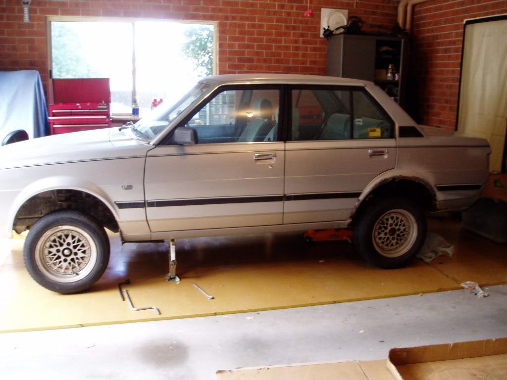

I just sat them on my rusty manual corolla which is up in the air right now:

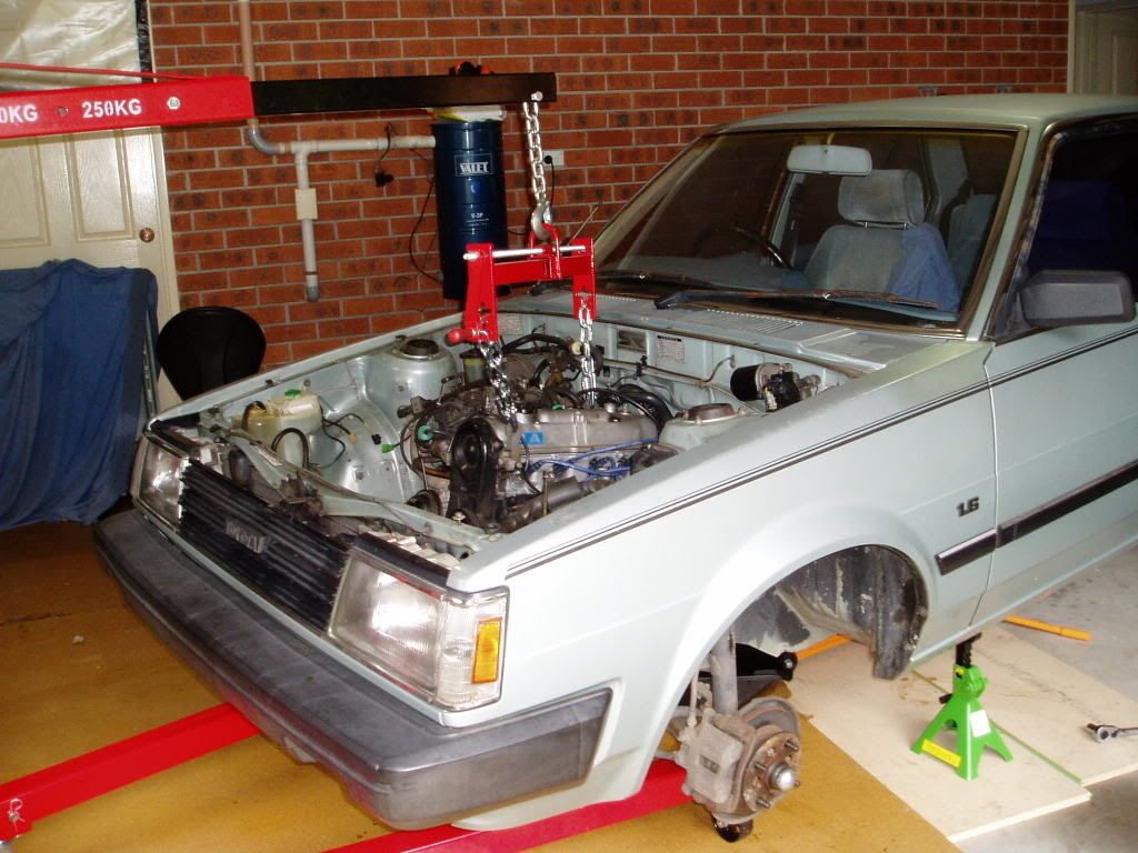

Well just in case anybody is interested, after the last 3 days the car now looks like this :dance:
That was achieved with a bit of this:
And then a little more:
Tagged every screw, nut, bolt and whatever so I know exactly where everything goes.

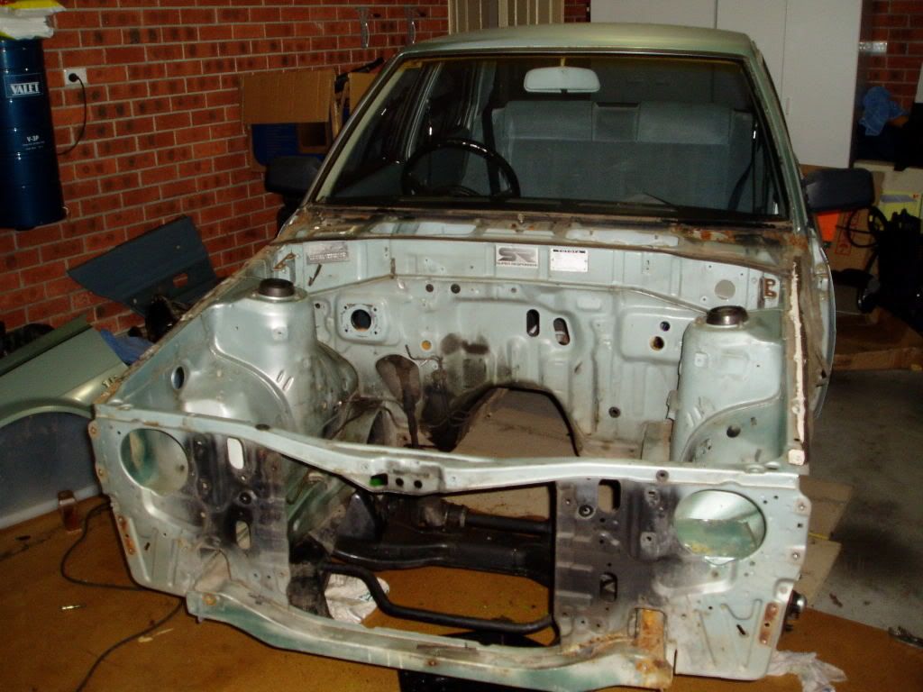

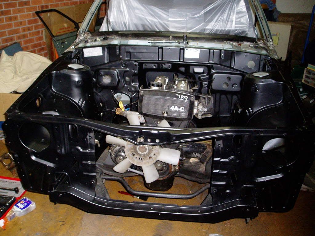

I've pulled everything out of the engine bay: A. Because I'm about to repaint the bay B. I've got some small amounts of rust to fix up C. Because a 4AGE is about to make its entrance.

Well a few things have happened since my last post, all of the dash, steering column, carpet etc is now. The windscreen is also out, so I can now start fixing the rust up :hmm:

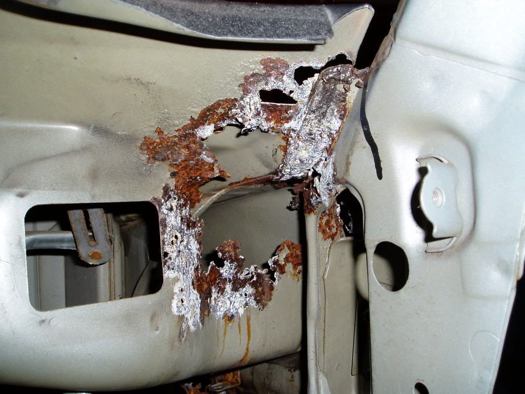

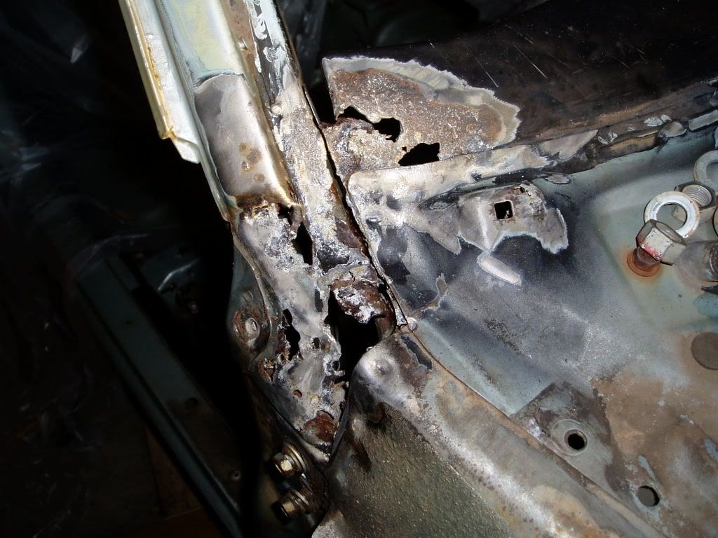

Found that the bottom of both the A pillars there is quite a bit of rust:

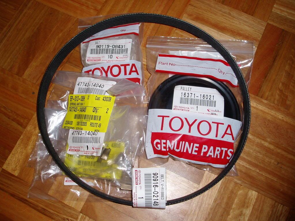

Mmm Genuine Parts...

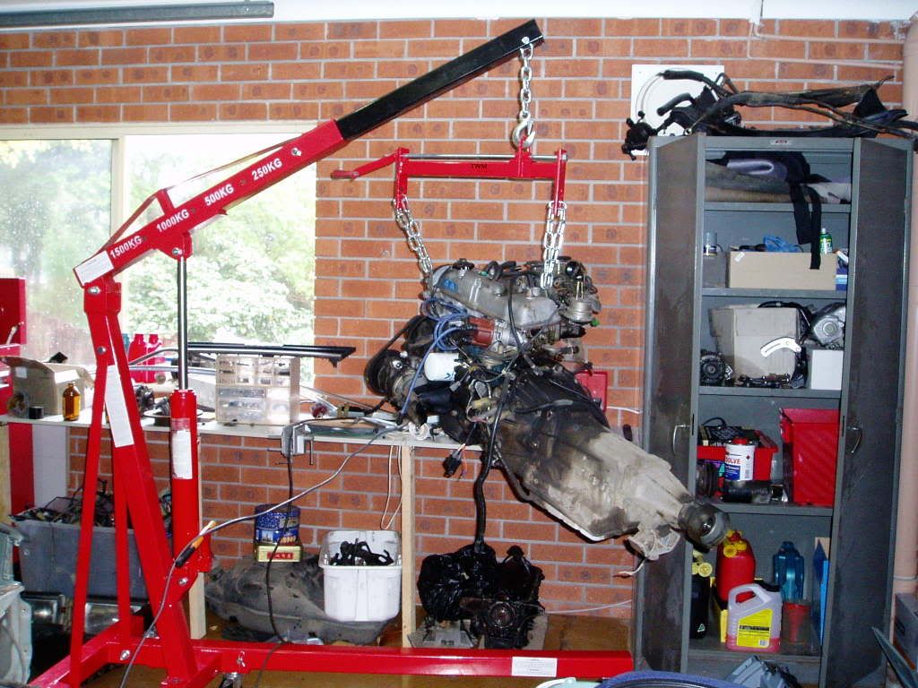

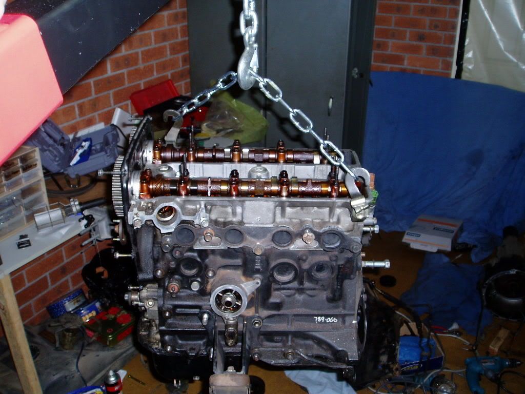

Ended up having to pull the camshafts out in order to replace the seals, oh the joys.

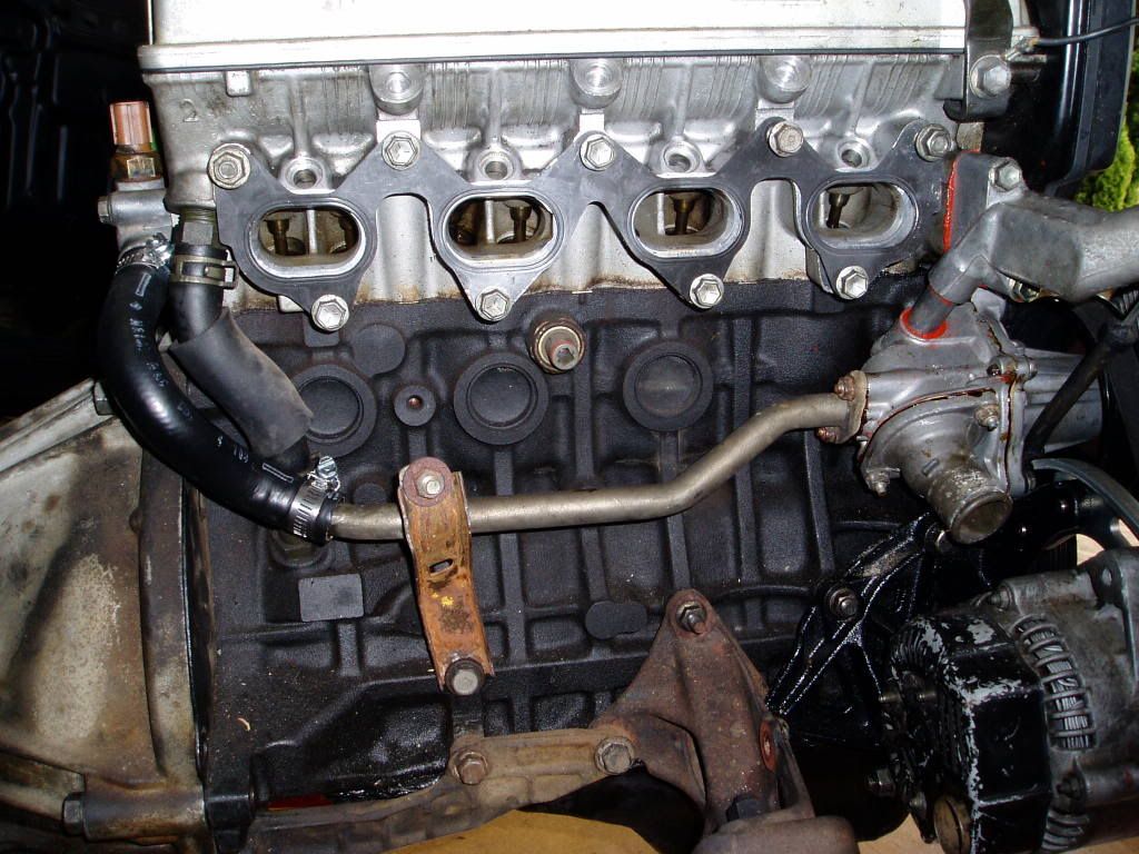

The RWD water system which people have been so keen to see:

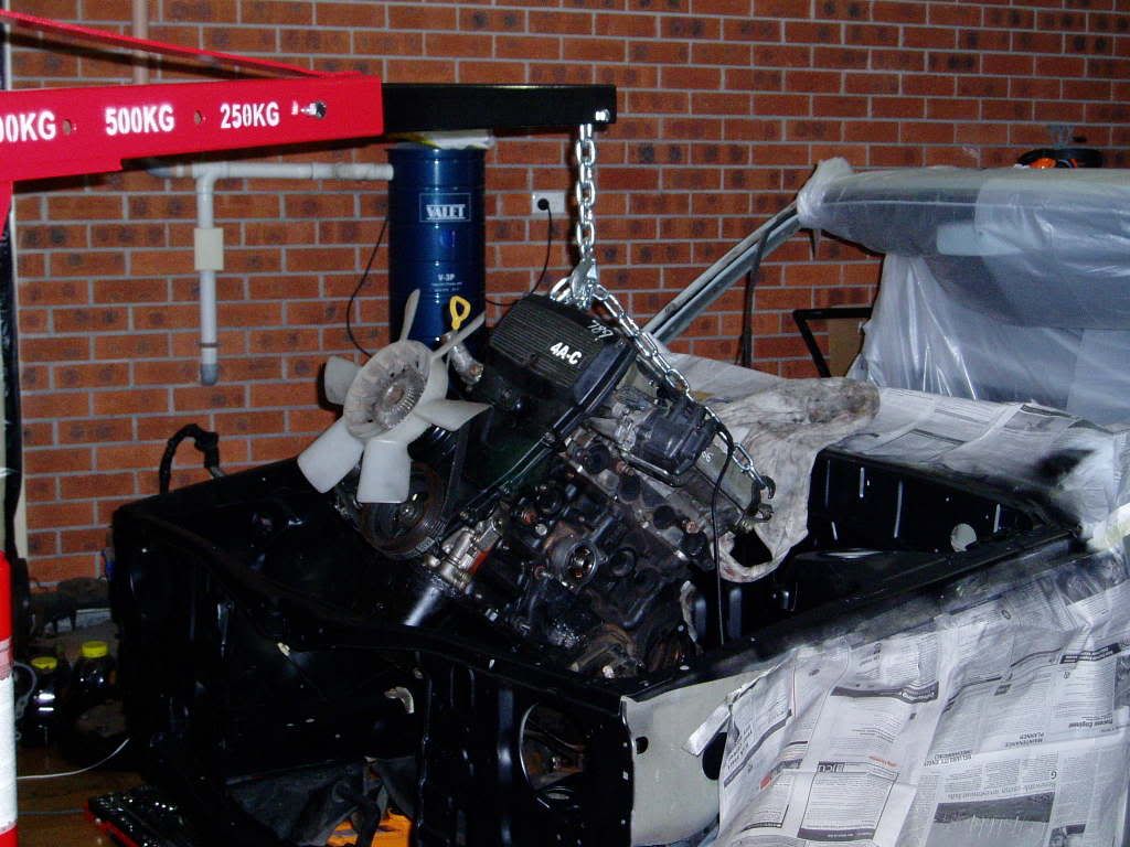

Droppin in
New home found :P:
Oh and incase you didn't notice, the engine bay is now black :)
