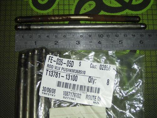

Well it's a long story, but I'll do my best to cut it short :lovin: I ordered some new 5K pushrods from Toyota last week and went to pick them up today. Basically got there, compared my one from my engine to the new ones, and hmmm the new ones are too long. So, I ask the guy to have a look to find the part number for the pushrods from the varied 5K models (flat top pistons/solid lifters). So anyway, the guy goes and gets help from another guy. So now two people there ask me if I am certain I have a 5K and with my response the guys looks through the computer muttering stuff the the first guy, "Check the YH** Tarago, I think they had 5K's" :D Funnily enough he gives up and goes and gets a 3rd guy. Talk to him. He asks me what car it is out of. Told him from a KM something LiteAce. Asked him to look through the other model 5K's. He tells me that there is only 1 model 5k and there were none with solid lifters etc. After a brief talk, and him "telling" me I have the ones I need, I took them just to get out of there. Also told him they would be coming straight back for a refund if they are wrong. End of story.
Anyway, I've had a search on here, and came up with that yes there is different model 5K's. So I was correct in saying that to the 3 Toyota guys. Also that the part numbers 13781-13081 & 13781-13091 correspond to 5K hydraulic lifters according to TRD (who I trust). The ones I got given though, are 13781-13100 and measure 156mm (apparently from a KM36). The engine I have is a 5K with hydraulic lifters and dished pistons and the pushrods measure 150mm.
Well, at the moment I am really just after a part number for the correct 150mm pushrods so I can go in there tomorrow and just tell them the part number I need rather than to have to sit there and watch them search through Tarago Y series engines... If anyone know the part number for a 150mm pushrods please let me know. I am sure some of the more experienced members on here would have had to get new ones in their time :yes:

13781-13081 is the most common one for 5k's with hyl lifters. my epc dosent even show that number 13781-13100

;) Makes me wonder what the hell I've been given then. Wouldn't put it past 'em that they made a typo on the label.
Doubt its a typo.

Got the correct pushrods from Toyota today, and at trade price too. I think they must have felt a bit guilty about their lack of help before so I saved about $20 with the new ones. For anyone else who may read this in the future: 13781-13081 is the correct part number for 150mm pushrods for a dished piston 5K with hydraulic lifters.
