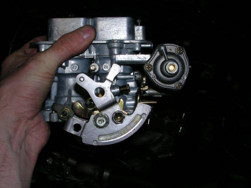

Does anyone know if I need to buy a linkage kit, or is it easy to make one?
you will use the one of your stock carby! just like the one in the picture!
