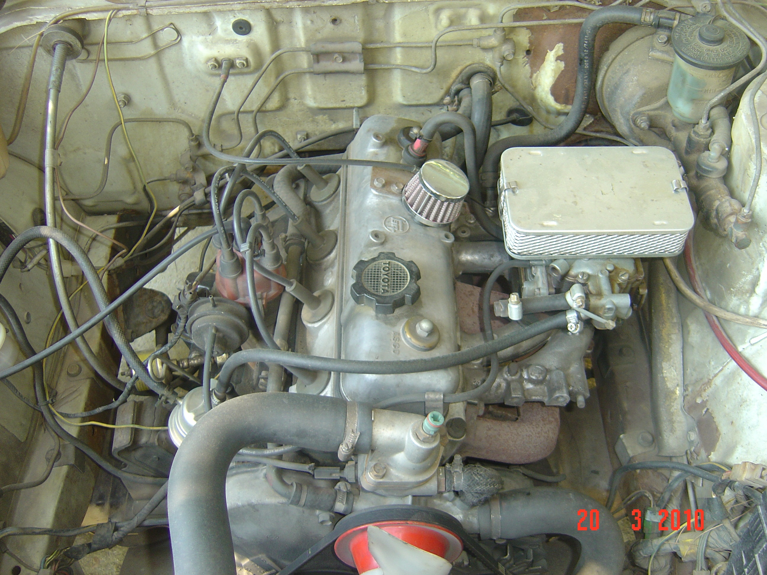

you can do two things for this.... 1)first of all to use a second breath filter 2)to do what i did...i keep the original carb plate in it's place(connect the pipe of the valve cover) and above that put the weber adapter plate..i use larger studs. i also opened the original carby plate to oval shape as the weber adapter plate..the same thing i did and to my inlet manifold for better breath of the weber. -

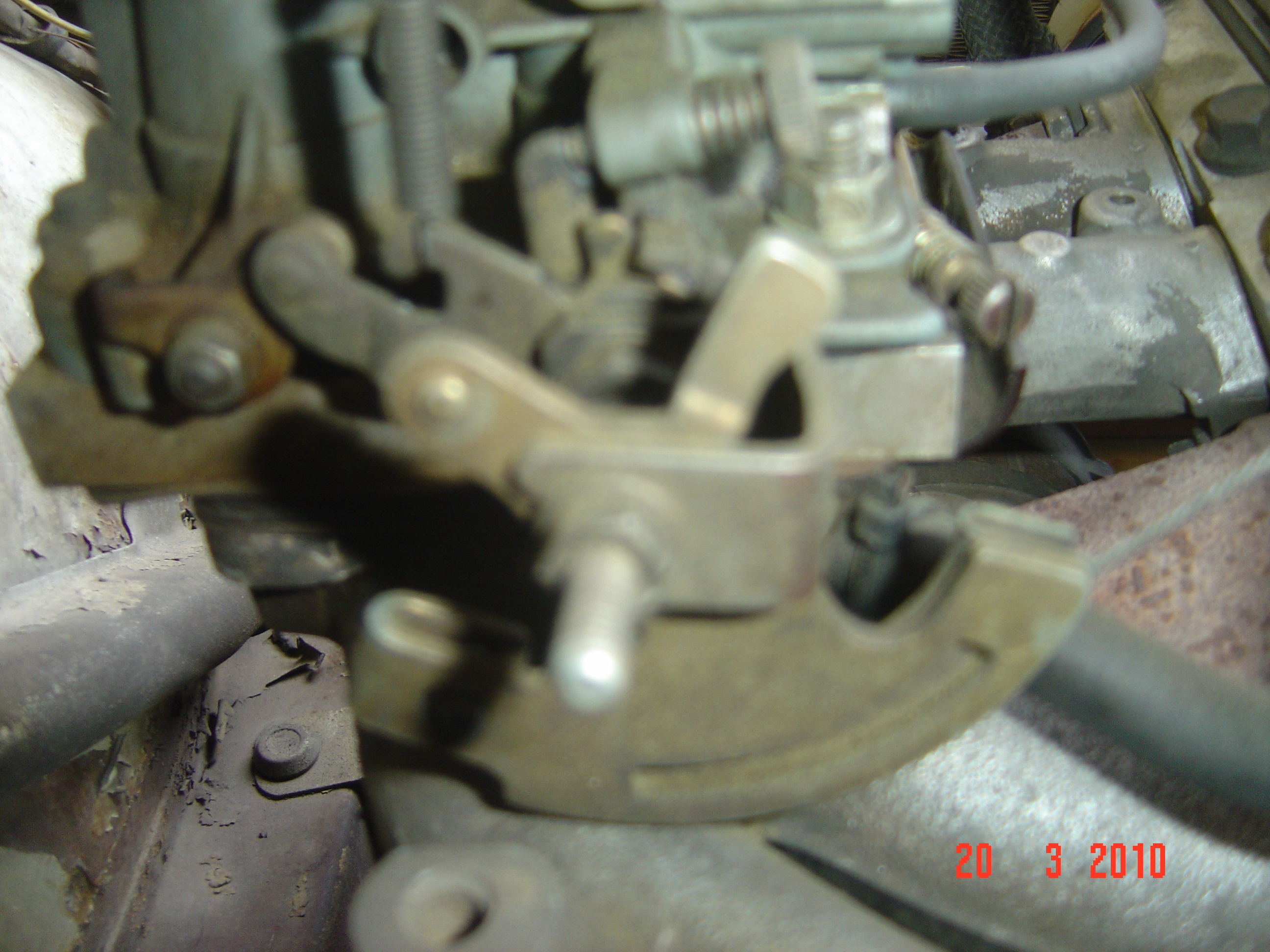

good job mate..only check if with pedal down opens and the second butterfly to it's end... I got the pcv breather from a car parts store in Greece (the country i am from)..."the other hose thats ment to go into the carby?" you mean the hose that hold i in your hand and you T it? i don't know but i would block it and use only one hose from the distributor to weber... And about the whistling noise...i think is the weber sound...i hear the same sound.... :-) -

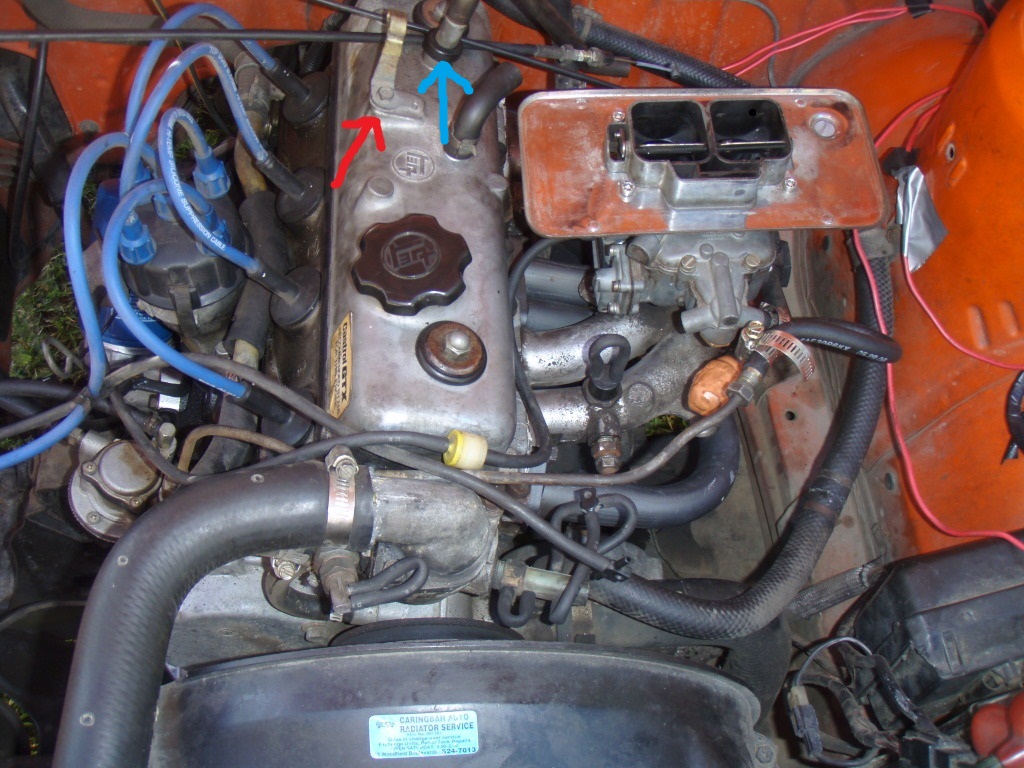

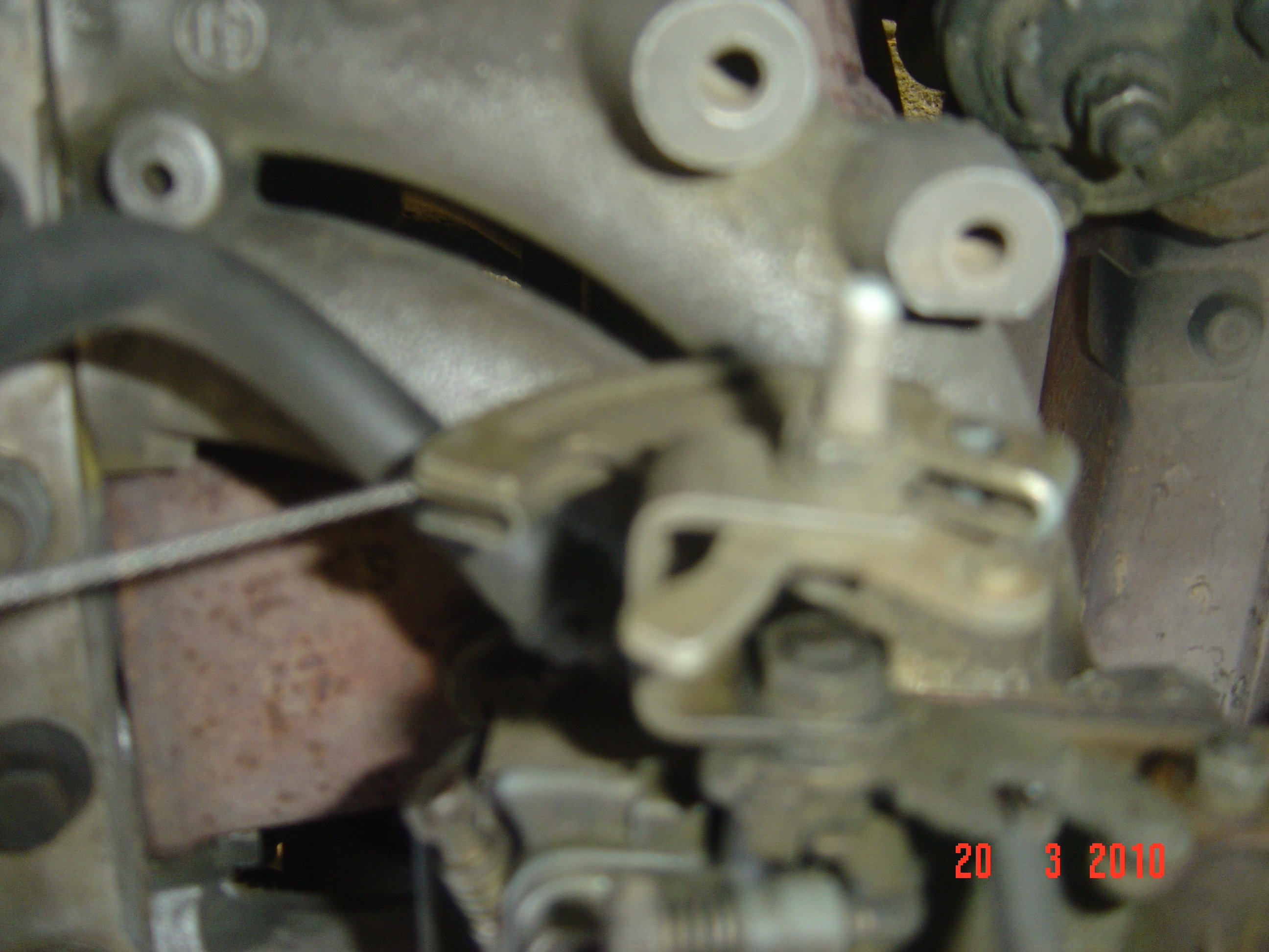

remove this bolt that holds this bracket(red arrow) and you will see 2 holes in this place you will screw the iron plate... in my car down of the carby adapter plate i keep the stock carby plate,in order to connect the pipe(blue arrow)...the stock plate also protects the carby bole from temperature... -

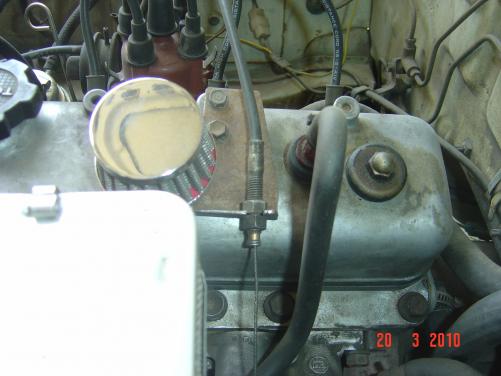

look at my second post with the 2 pictures...look at the first one of the two... i take a piece οiron plate and fix the bracket...look at this..it takes me 10 minutes to do that..drill 2 hoses to bolt the plate on the valve cover..the valve cover has 2 holes... -

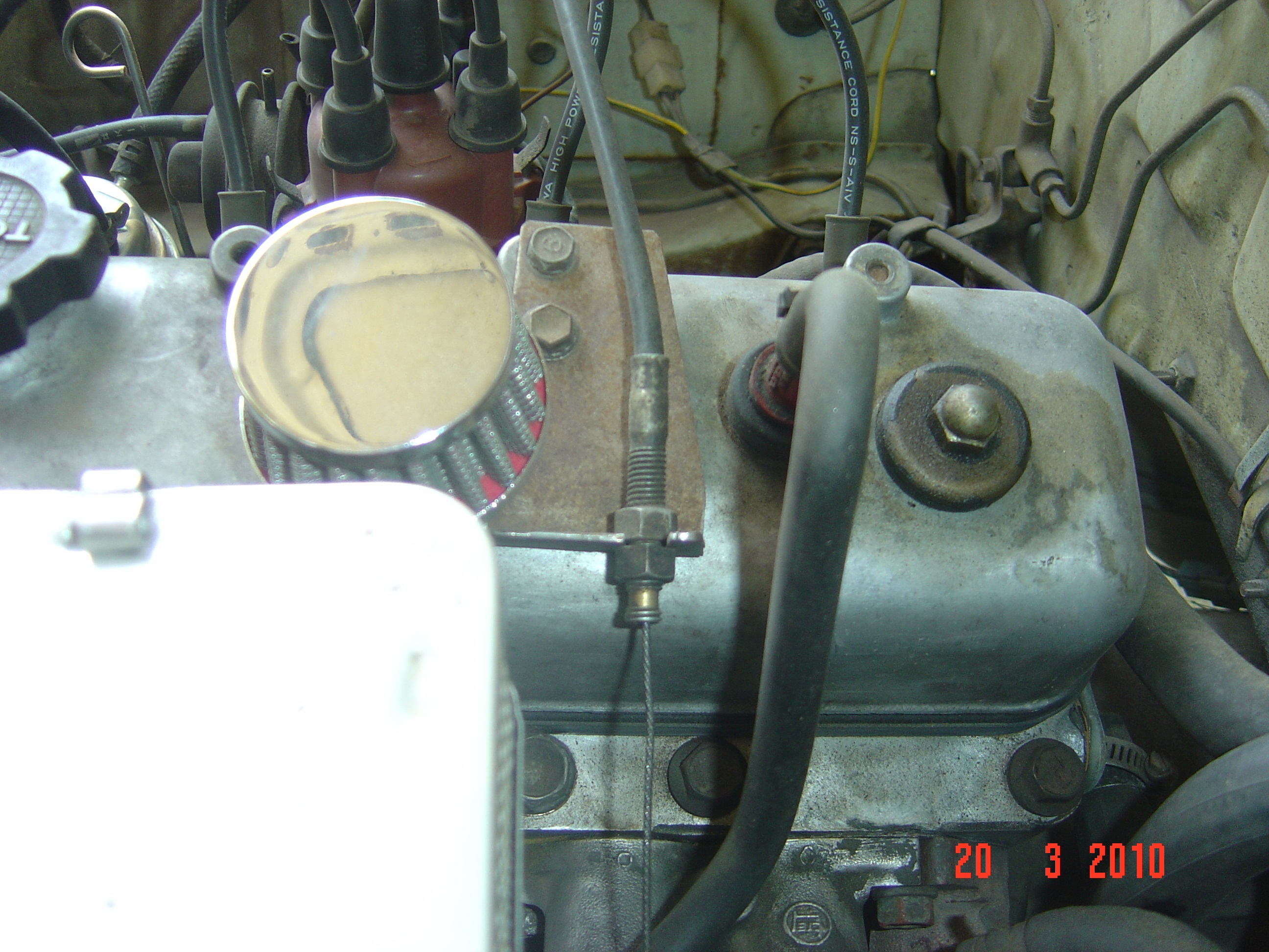

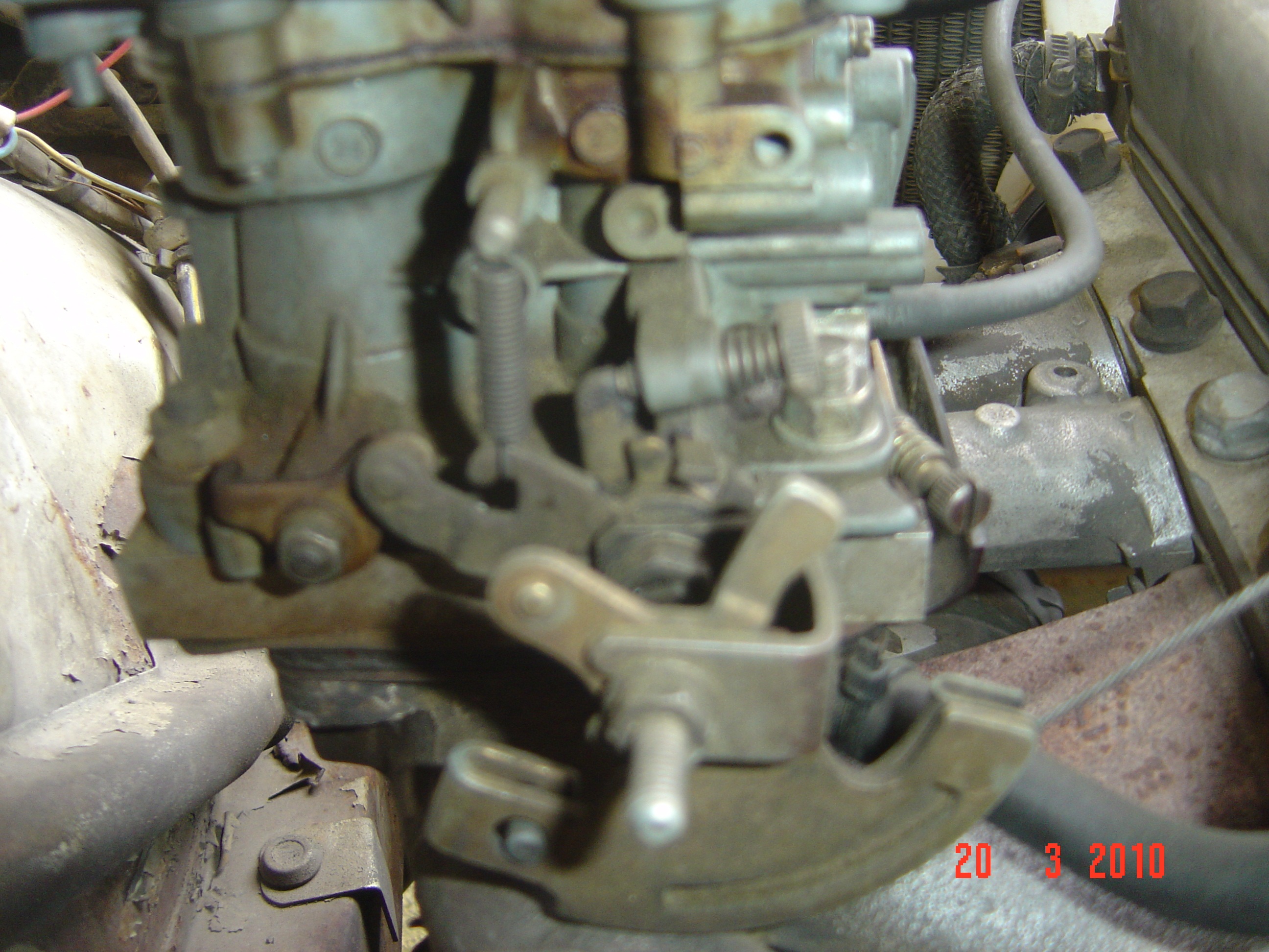

Hello Anastasie... look how i install the weber in my car..it's so easy a job with the accelerator cable. i use the 4k stock carby things as you see and a bracket plate in valve cover... mine start pretty easy but the carb had been cleaned and had new gasket set...is the carby cleaned? if it has a blocked hole maybe this is the reason... -
