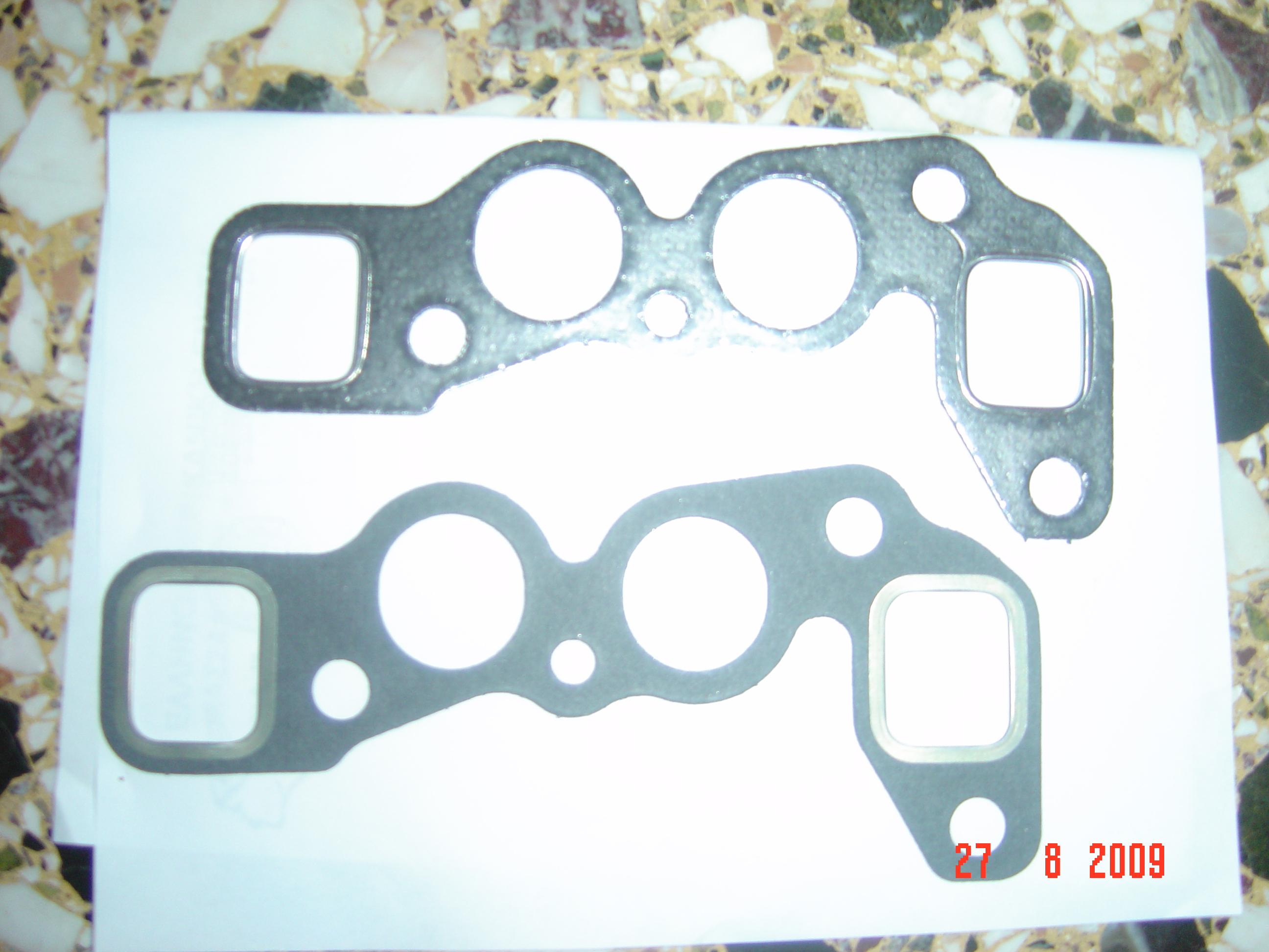

  7. what type of gasket do you prefer to use? the upper one is genuine toyota and the other is stone...

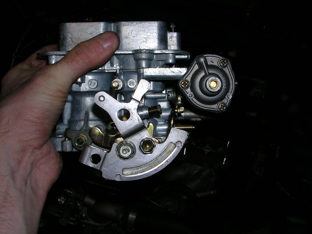

  18. you will use the one of your stock carby! just like the one in the picture!
