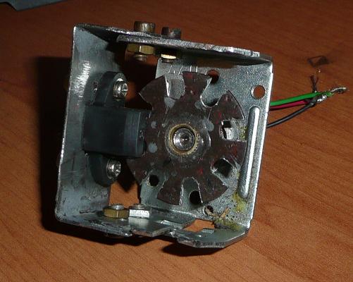

My speedo needed atleast 3000 pulses/km. A T50 gearbox speedo drive is around 700rev / km. So to stay on the safe side i cut 9 teeth into a blank of sheet metal. This is the decoder wheel.

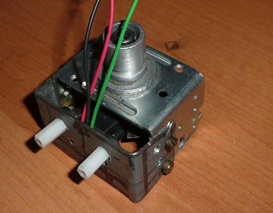

I gutted the original speedo just leaving behind the attachment for the cable. To attach the wheel onto the shaft i found a old hi-fi knob. I punched out the brass boss. The ID is a perfect fit. Same ID Knob
The wheel was punched onto the boss then epoxied into place.
Now all you need to do is line up the hall sensor with the decoder wheel. I used this Hall sensor unit
This guy is ready to go, runs upto 18v and despite what the site says it goes hi when metal is between it. Some sheet metal and a bit of bending ive got it lined up nice.
Ta Da!
I can hit 40km/hr by flicking the wheel with my fingers on the lowest setting.
