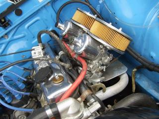

its not my car but maybe this would help....besides where about did you can the manfold from?
it came with it its called a lynx manifold and have you got any other pics of these SU's becuse i can't really see hoe the cable is attached.

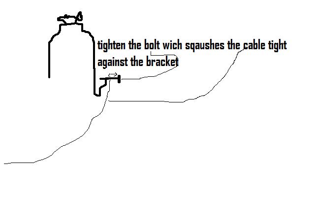

ive got a mini with twin su's on it let me just run to the back shed and have a look for you wont be long
the outa coating of the cable is attaches to a steel bracket wich is connected to the block but the actual cable that hooks to the carbs has a a small bolt that you tighten that sqaushes the cable tightly to the bracket on the su ...ill try and draw sumthin up for you to show you what i mean
sorry bout the headache lol
Edited by brendan

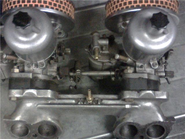

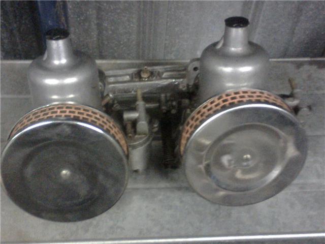

all mine has is like a little ball bearing it looks like something has be be cliped onto it.
i think i might have to make a bracket like this?
ahhh yeah the little ball bearing should be ablle to screw out and just put you nut and bolt threw there and tighten it up with the gas cable threw it
gas cable?
You do need a bracket like the one you've pictured. It's designed to have a vertical shaft clipped onto the ball. Otherwise you might be able to modify the cable wheel off an old carb. It will take a bit of messing around, but you could probably mount it on the end of either carb so you don't have to muck with that centre linkage.
