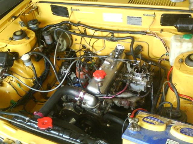

Nope, straight swap as far as mounts, wiring and trans go. Some times the water pump has to be changed as sometimes the new motor has more heater hoses or has heater hoses in different spots. thats just about it. Make sure its a runner before the swap. Our friend Myles can tell you all about his swap. :dance:
hey
hmm well wasn't that a fun day it came out easy just getting it in and running was the hard part
hey
Too true. getting it running. even only roughly puts the biggest smile on your dial lol. and the first drive with the new donk mucho grins :dance:
