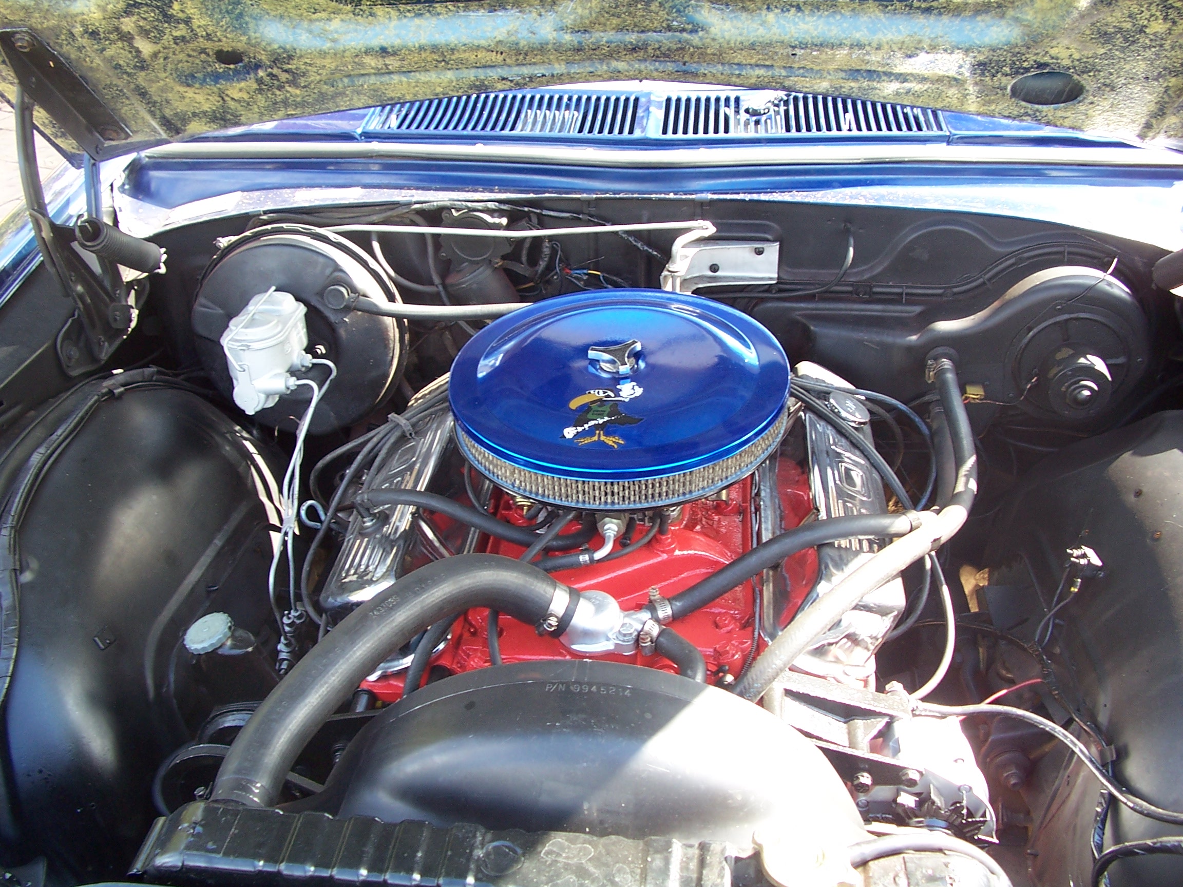

Here are a few pics of my last project. It took me 10 years and $16k to build.
It is now somewhere down in Tassie. I should have never sold it. ;)
Specs :
308 Stroker with lumpy crow-cam, roller rockers
M21 box
Lsd

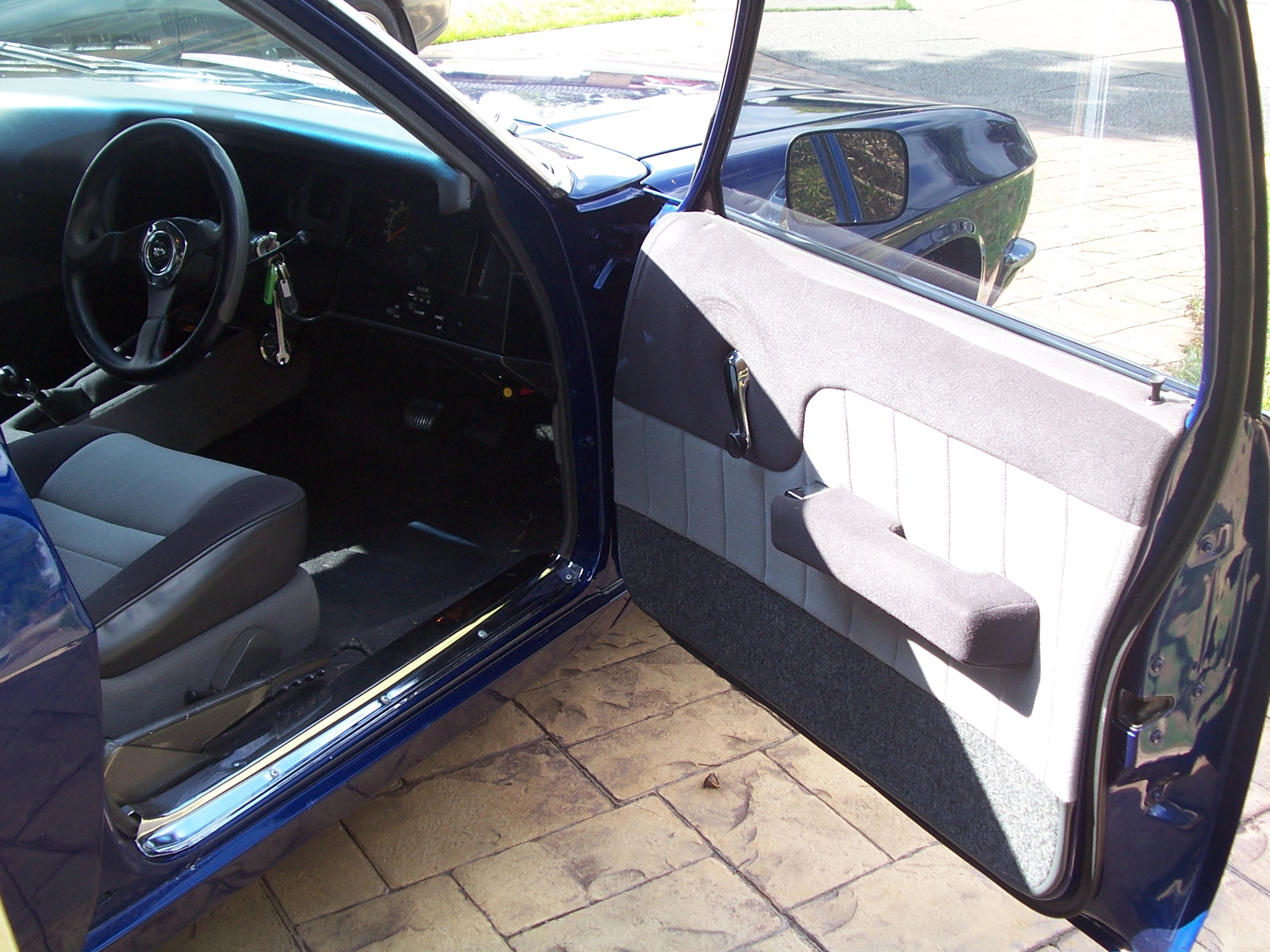

Custom interior > Vp Commodore seats, leather dash, custom trims, gts console
Custom tray & lights
bare metal cab off paint job with no filler used
Enjoy,
Woz.

I see you have commodore seats in there, do you know/remember if the later WB's floors are drilled to suit commodore rails?
CHEERS
Ryan
WOW, looks great :lolcry:
CHEERS
Ryan
The rails are different for the hq i had to re- drill the holes and weld plates in i done all this before i painted it
and had no problems with vic roads gettin it regoed
the place i got the roady from didn't even pic up i welded plates in and we where right underneath it on the hoist
all i can suggest is pull ya wb seats out and try a commy seat in
cheers
Woz
WOW, looks great :y:
CHEERS
Ryan
3 of the bolt hole line up with commo seats i think its the front inner bolt that need to be drilled
weld a 100x100x2mm plate to the floor and tack nut to it and away ya go all legal :jamie:
my bolts lined up for only one side and i had to drill the other two but that was in a 72 hq shell
yeah mine is a WB it had the old bench seat in it i pulled it out and put my 2 race seats that i had in my vr and put them in i know vt on have a different rails what model did you pull your seats out of..?

What model did you pull your seats out of..?
I pulled my seats out of a 1992 VP Commodore S/Wagon.
