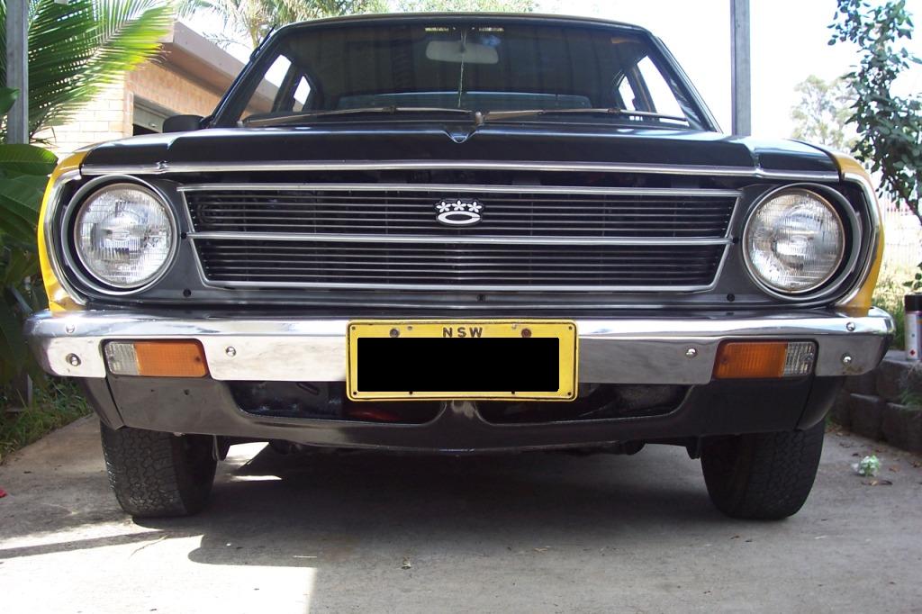

Hey Shaun did you get my picture msg today?
lol i can't get picture messages my phone is crap lol
what was it
that pic of ya rolla looks fat!!!!!!!

Haha no worries buddy, it was a quick snap of that car that i told you about
He's moved it out the back, i was driving down the backroad for a work job and i spotted
and thought i'd send you the pic..
